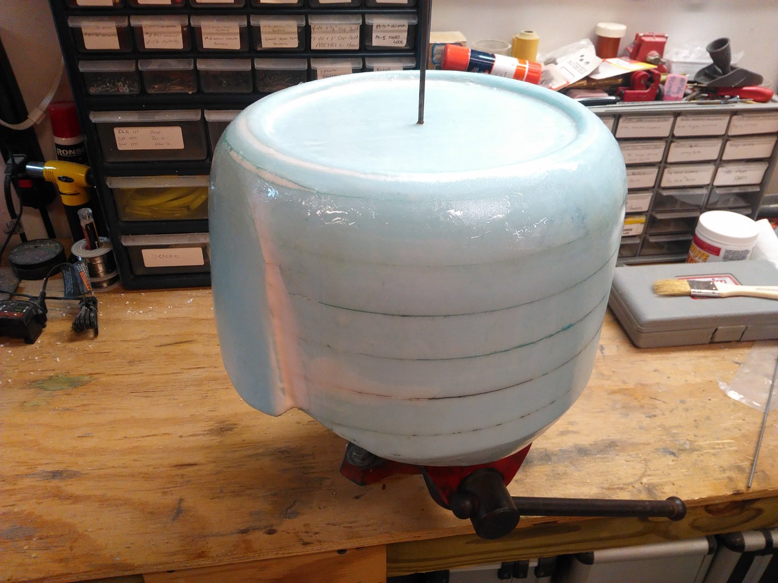

Is it just the glue line and shadow at the back of your plug. It looks like you have tapered it in on the sides and your grand dads is straight according to the pix. Good job on the plug, that's a lot of work and there's a lot more to do.

@Doc, the cowling does tip in at the rear creating a cheek looking thing. Grampa's had it to as did the full scale. I'm not really sure of the reason it was done on the full scale, dad and my hypothesis is that Harold had trouble getting the cylinder head temps up, which running and engine cold can be as bad as running it too hot.
I'll be using Koverall and dope for the finish, mainly because it is what grampa used and I'm challenging myself to try and get as nice of a job done with it as he could... I'm not holding my breath on that one ;)
So after adding a little bit of foam around the inside of the ring to make the opening a little smaller and increasing the radius on the leading edge I called it as close as I can get it and set about glassing the plug. I used Epoxy resin and 1oz cloth I've the entire cowl, after it cures I'll set about body working it and get it ready to make the mold.
