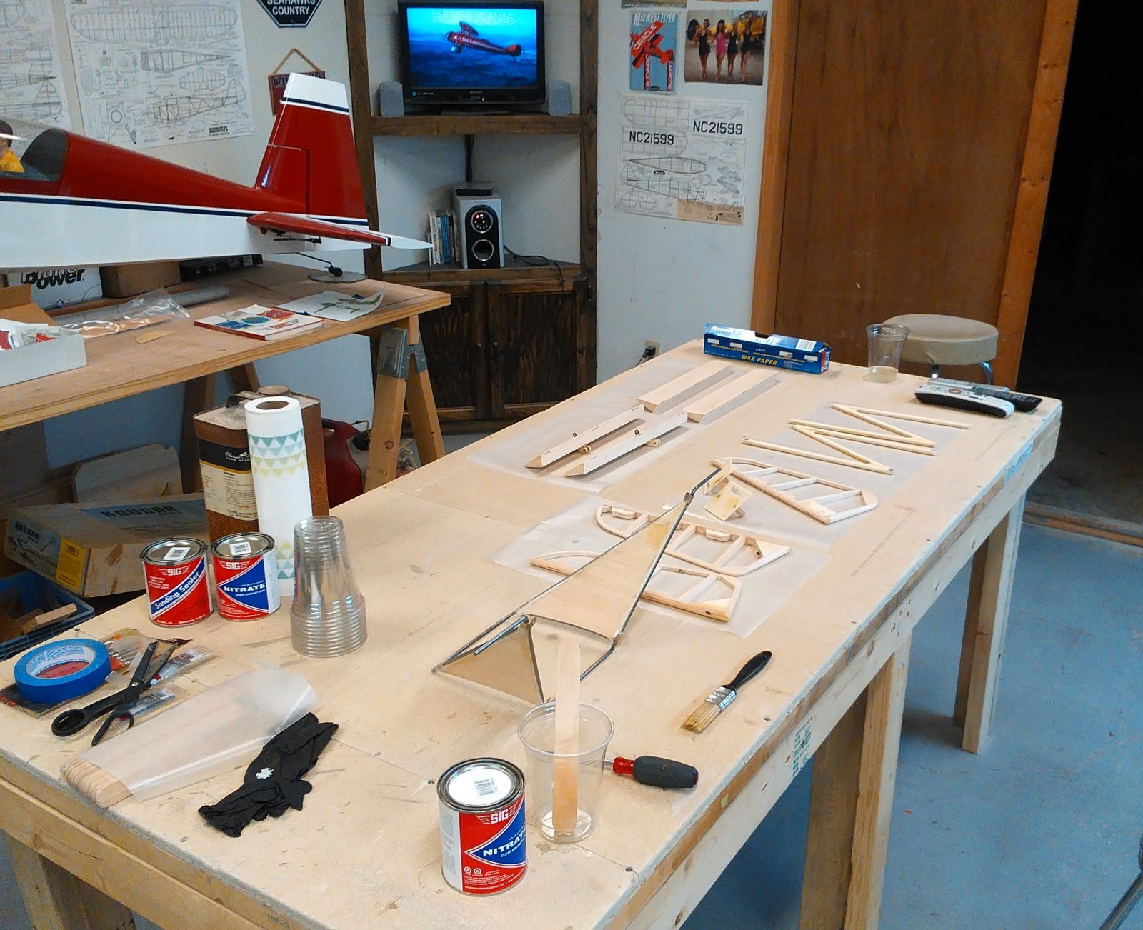

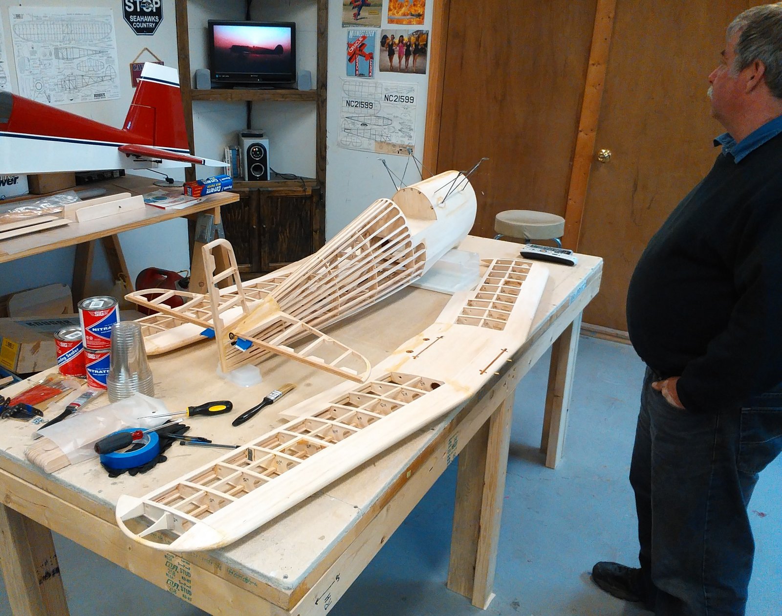

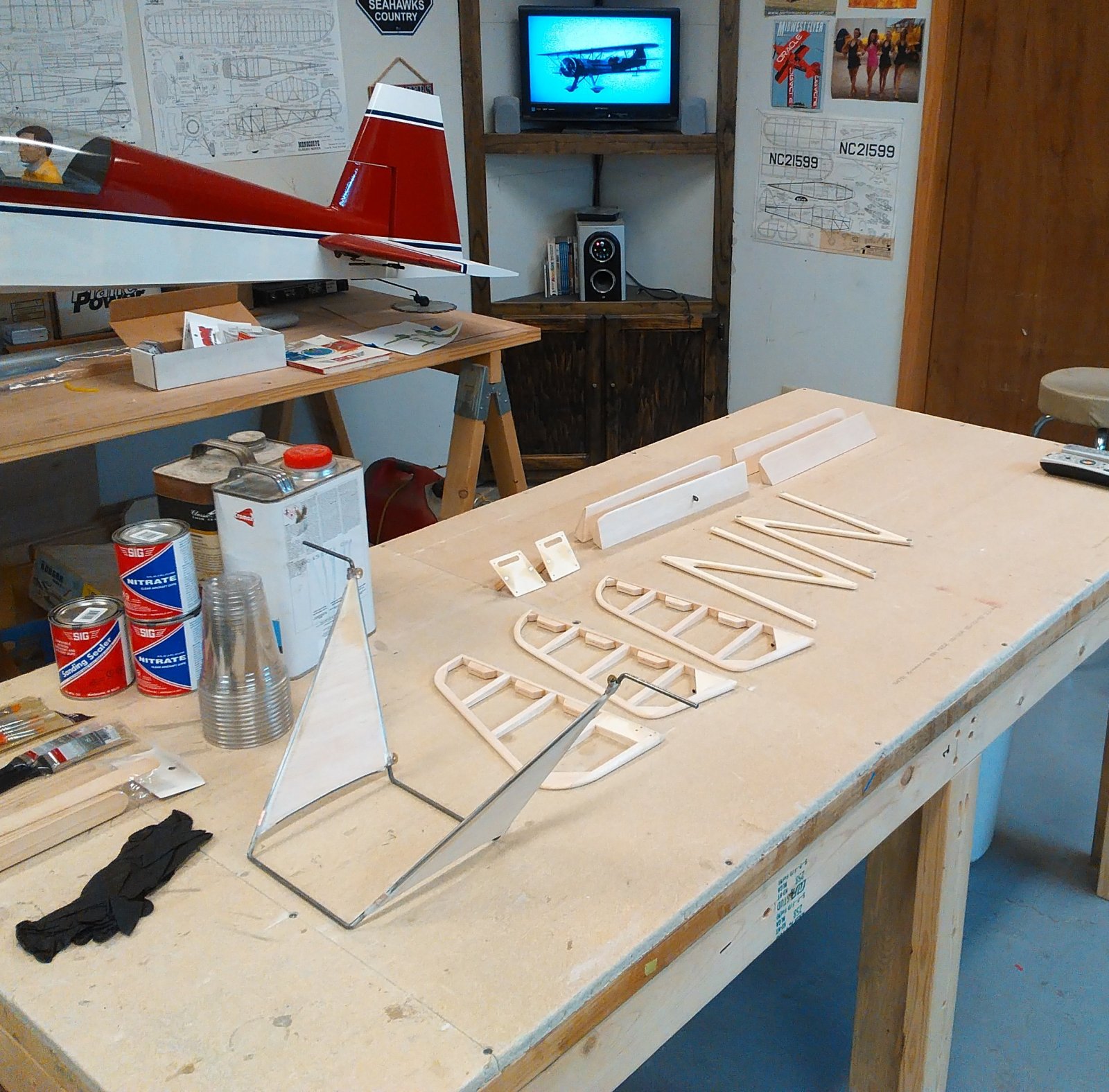

I've been over the whole airframe about 6 million times, everything s crossed off the list.
Time to start slingin' some Dope!
First coat of Nitrate is on all the little parts.

Do you give everything or just the edges were the cloth ends three coats of nitrate.

I'm giving everything that the covering touches 2 coats and if I need more then I'll put a third were the seams will be.
You want the wood to start to get a satin sheen and have a plastic feel. That way the Nitrate you put the covering on with melts into the Nitrate on the wood and kinda welds everything together.
I believe I still have some dope laying around what would you think if I gave the plane single coat of dope sanded it and plastic coated it.
