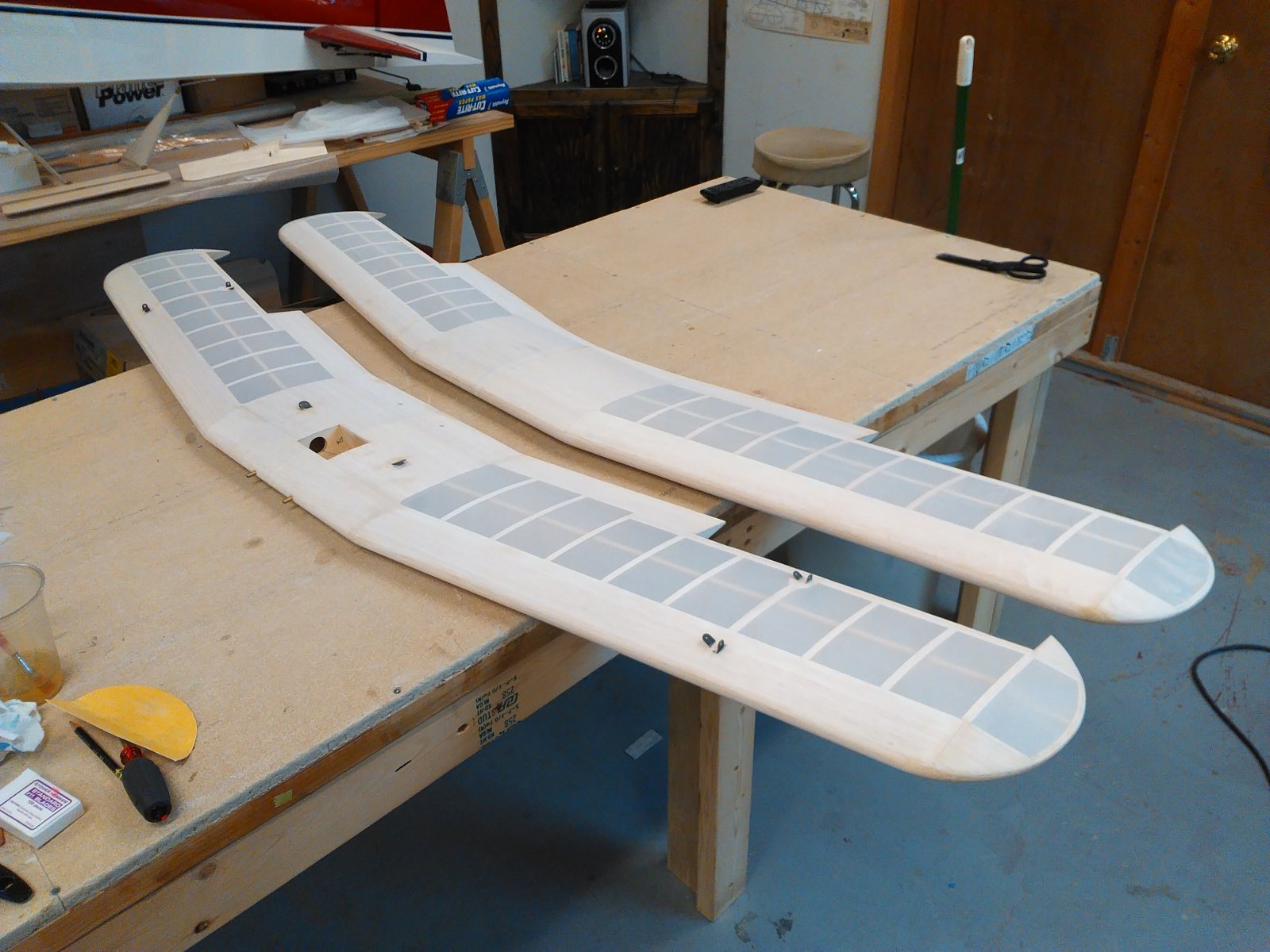

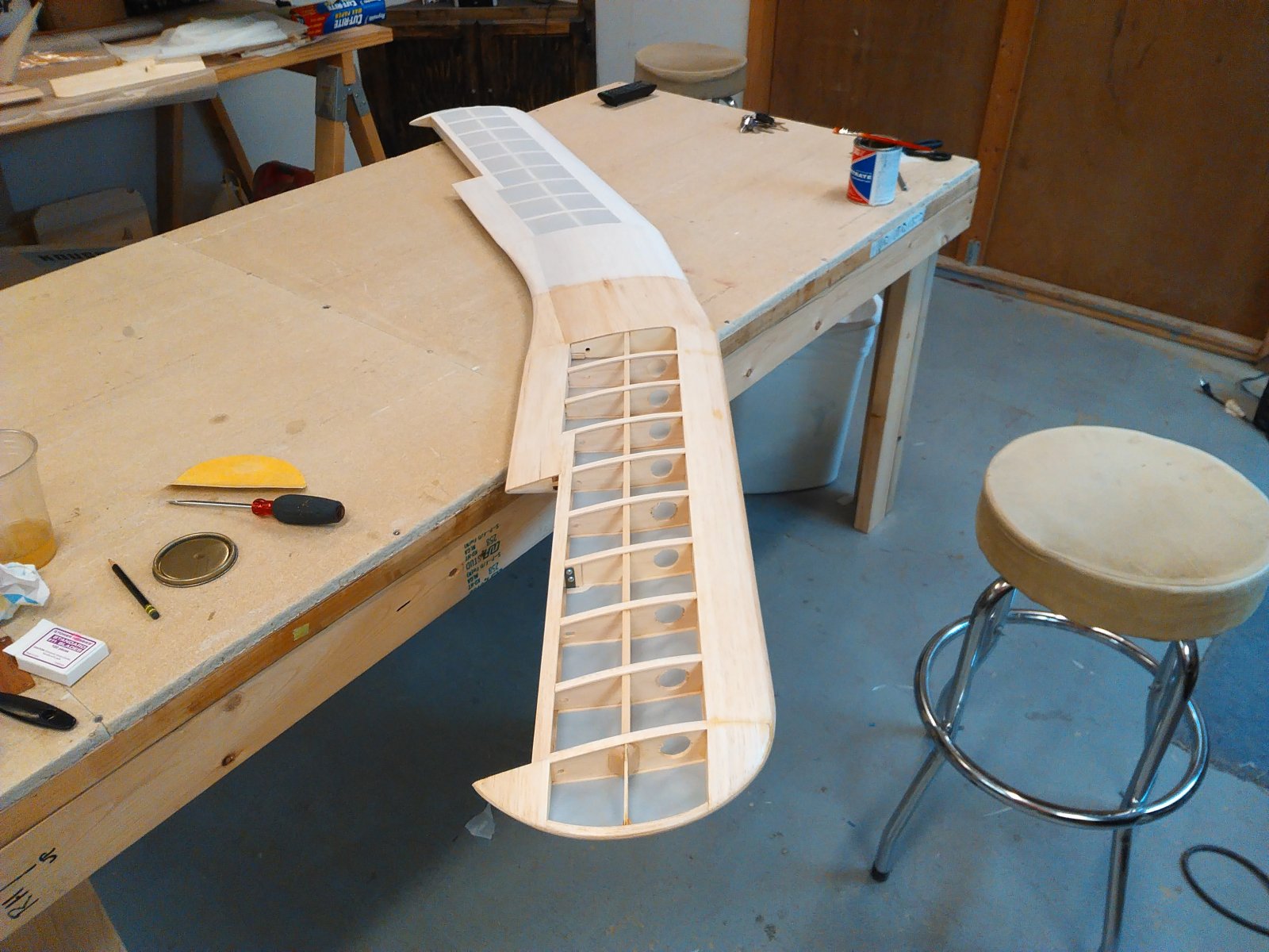

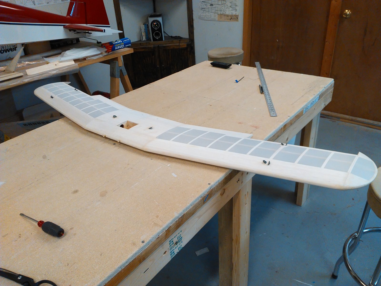

The fuse is all done, and I got the bottom wing covered and shrunk. I've been working on the top wing today and should have it finished this evening. After that all that's left is ailerons, then the fun part begins :)

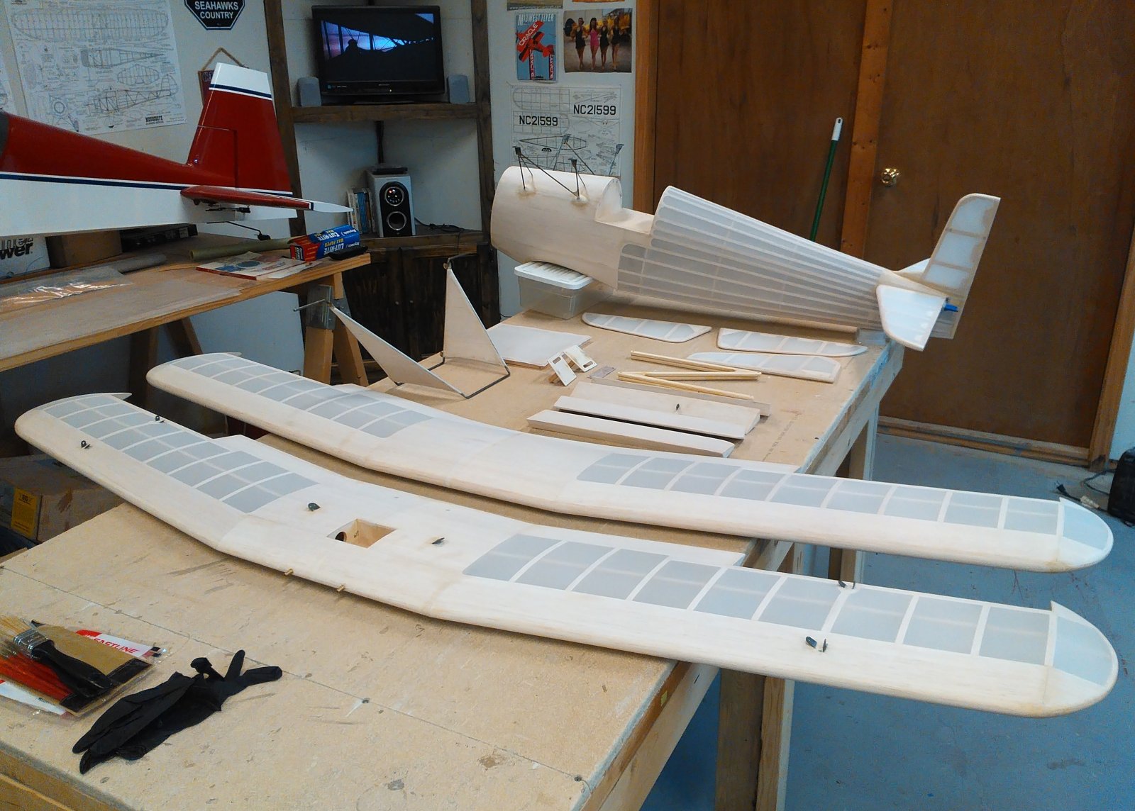

All the fabric is on and shrunk! :D
