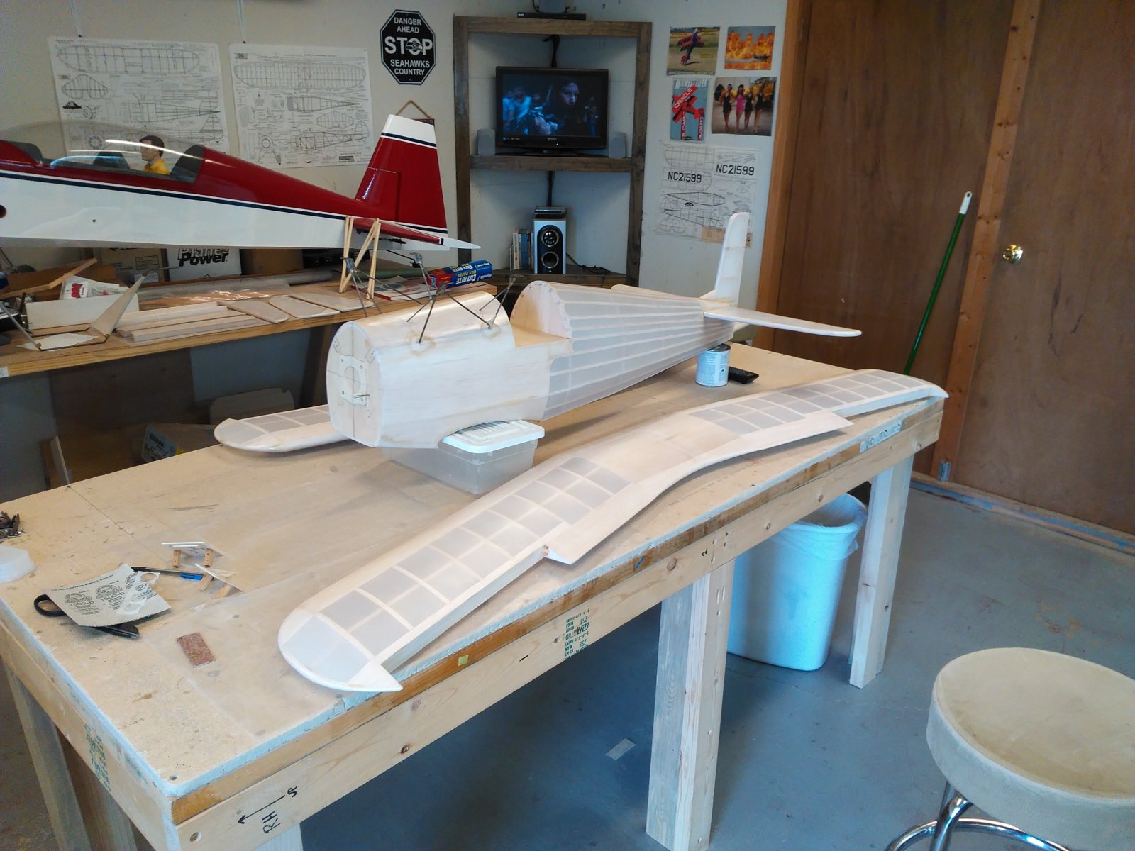

It's shiny!! After 1 heavy coat of Nitrate and now 3 coats of Butyrate I think its ready for a coat of sanding sealer, then color :)

Well that blows my mind. I thought sanding sealer was for exposed balsa or wood in general I never heard of it being used after 4 coats of dope. I obviously don't understand the process. But I'm sure there's a perfectly logical explanation. Maistro----

OK I went to sigs catalog and read about it and its dope with fillers and can be used on Butyrate at any time. I Gather you can put butyrate on nitrate but not the other way round.
Yep, that's it. We use Nitrate on the wood and then the first coat on the fabric because it adheres to those things better than Butyrate. Then the Butyrate sticks to the Nitrate.
Rule of thumb, after you open the Butyrate can for the first time, put he Nitrate can away and leave it away! Lol

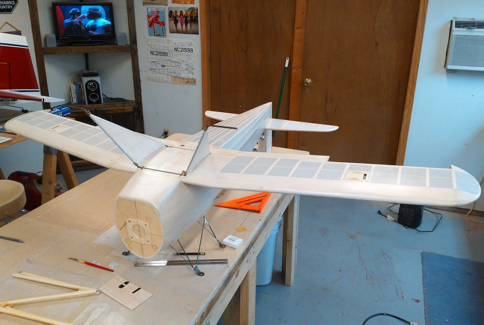

Dope and sanding is done! I spent this evening cutting out the servo bays, hatch openings, ect, ect and putting a little dope on those edges to seal them down.
Then re-test fit some things to ensure that the dope and covering doesn't interfere with it going together.
Tomorrow evening I'll be cleaning the shop in preparation for spraying color!
I'll use my airbrush to put down the black first for the pen stripes. The Red and White should be here Thursday, so maybe I'll get to put the white on over the weekend :)
