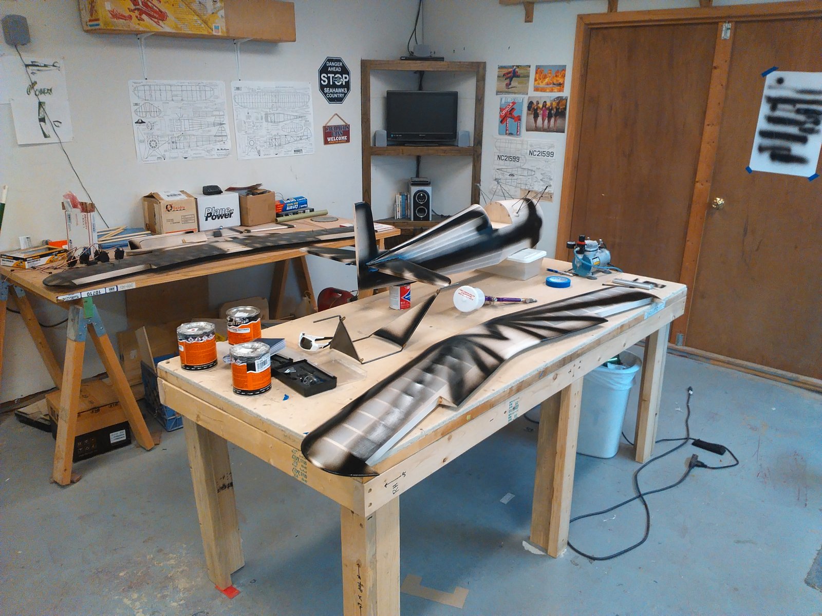

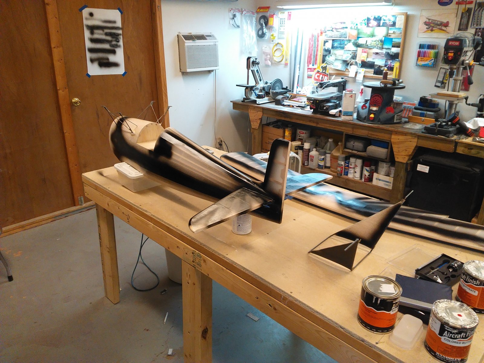

Well, I got it down to 52% humidity in the shop at 83 degrees so I put a few extra drops of retarder in the dope and sprayed the black!
Now it has to sit for a few days before I can start masking on it.

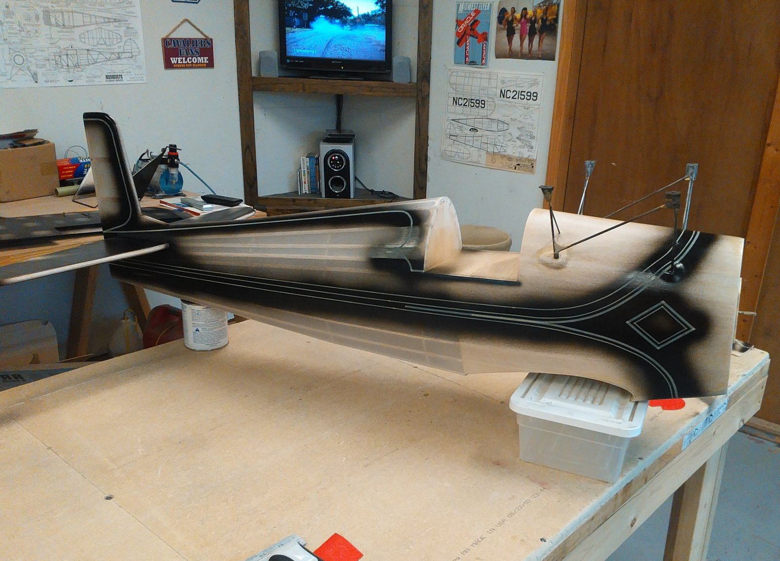

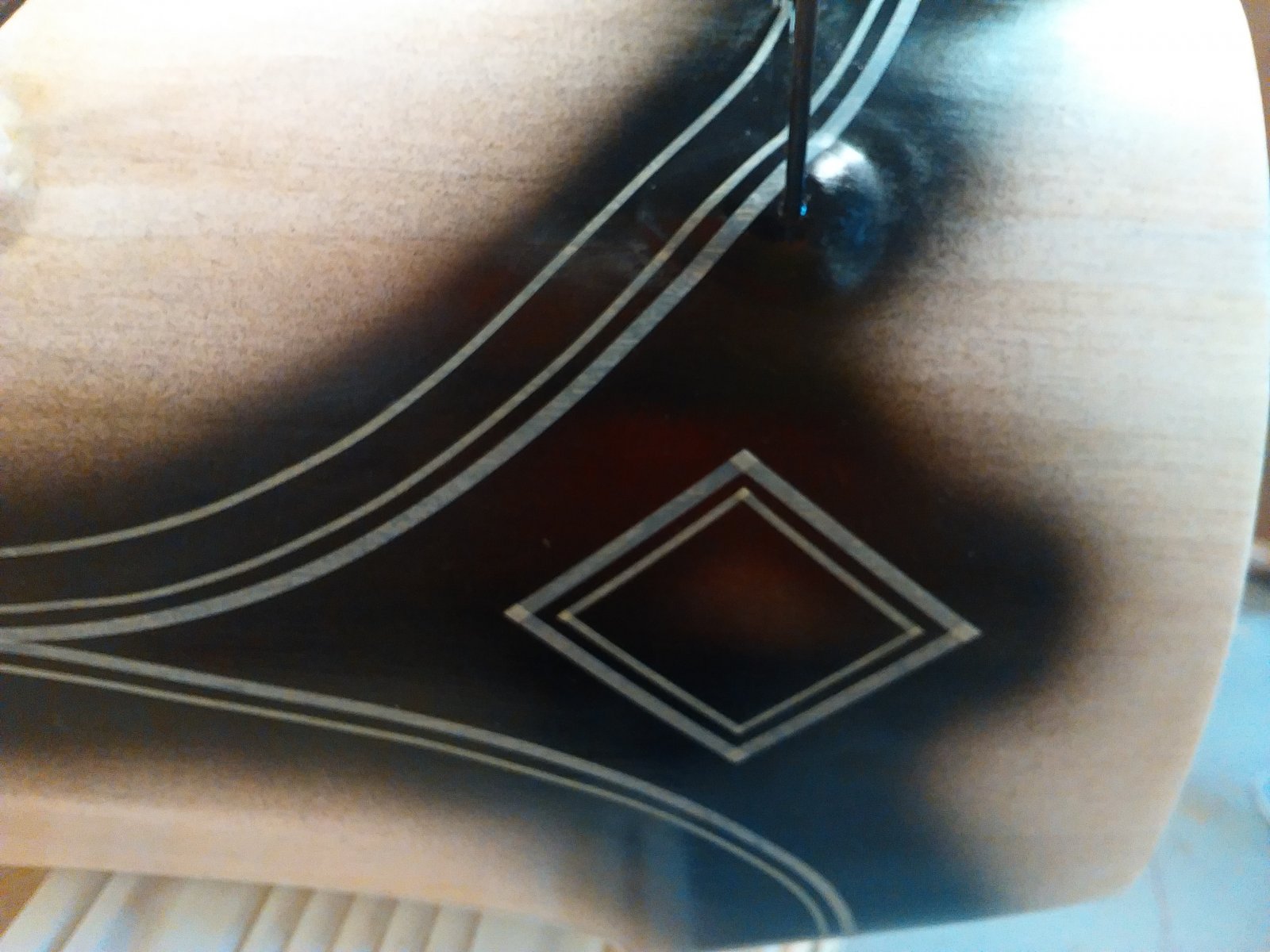

Well, I got a good start on masking the Krier this evening. Found out I didn't get enough black dope in a couple of spots and that halted me for the evening :(
But, I mixed up some black dope and got those spots filled in and of course the dope blushed errrrrgh... Lol. Really it wasn't a big deal as the spot was small and I was able to burn it in, so back to masking tomorrow.
It is a little nerve racking but I'm getting it. For being a relatively simple trim scheme there is a lot of masking!
The start of the stripes and the finished diamond of the fuse side. The larger pinstripes are 1/8" and the smaller pinstripes are 1/16"

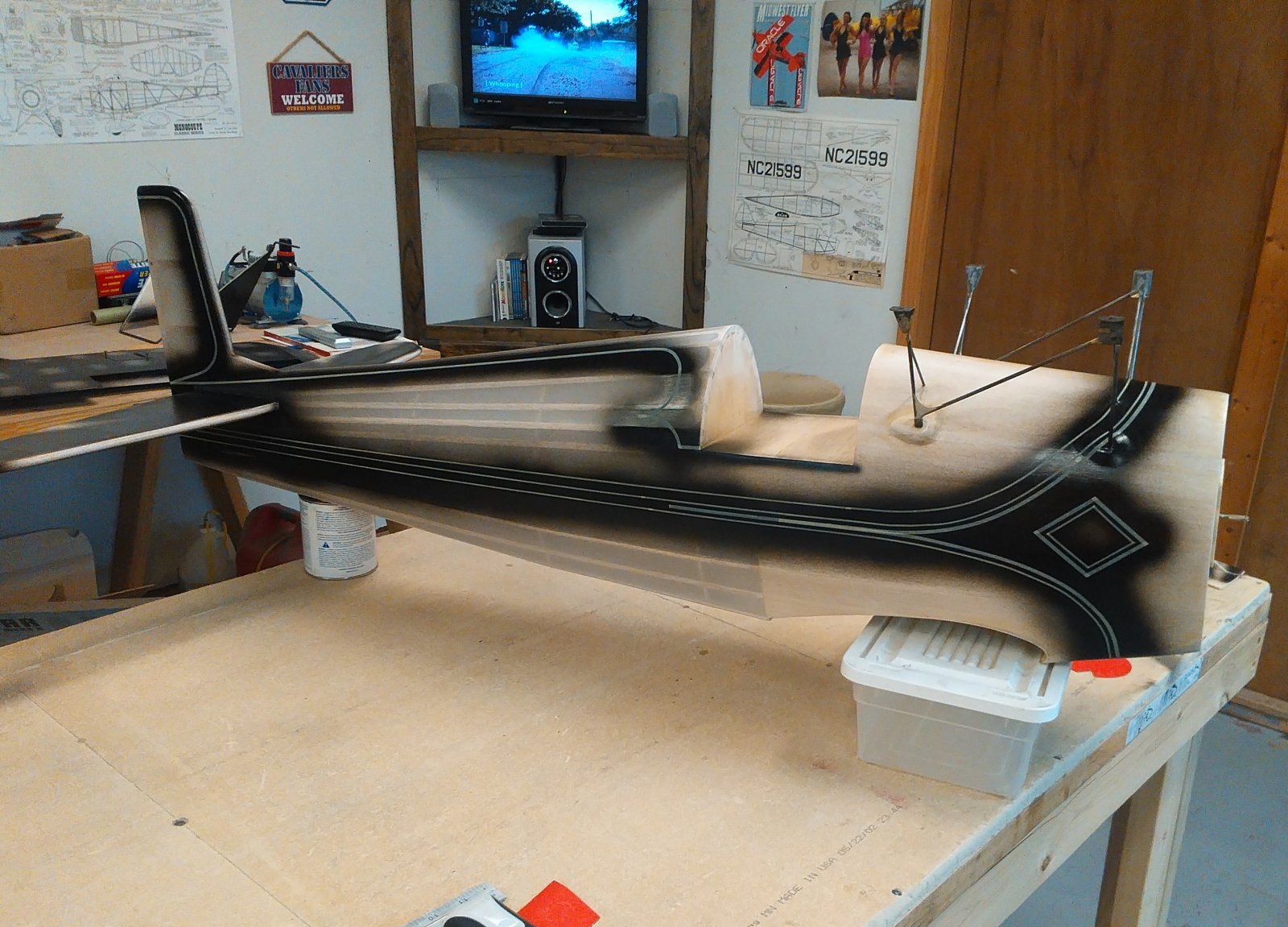

And I thought I had it tough. Wow...you are a much braver soul than I. Oh but it will be breath taking when done I am sure.
