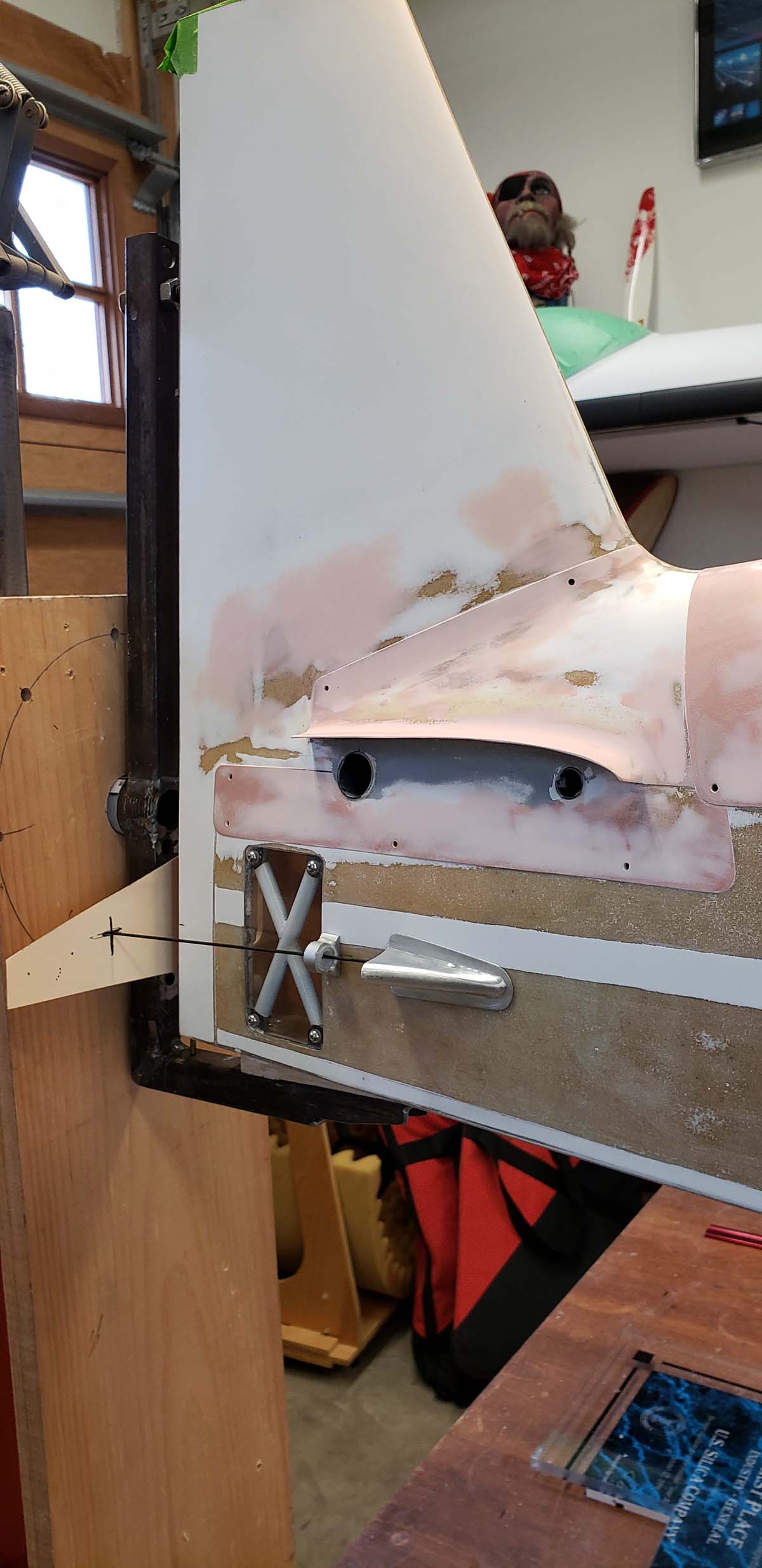

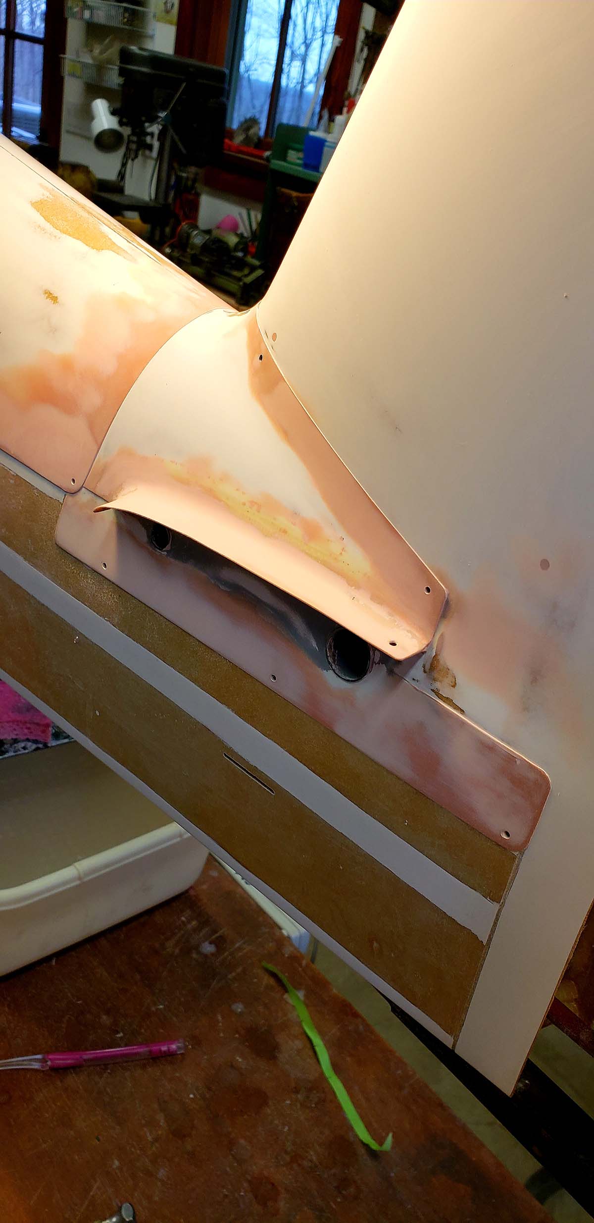

On the pics I posted above I used the 2-part Bondo Professional spot putty/glazing compound to build up the panel thickness i desired (about as thick as a hotel key card).  This stuff flows/spreads very smoothly, and sands easily.
On the other side (no pics...it looks the same) I've used 2-part Bondo Professional body filler which mixes the same (hardener to putty ratios), is somewhat thicker on application, so doesn't quite spread as nice.  It is much harder to sand, although still very sandable.  Seems to be much less susceptible to dings.
So....I'm thinking the body filler may be a better choice for me, long-term.
