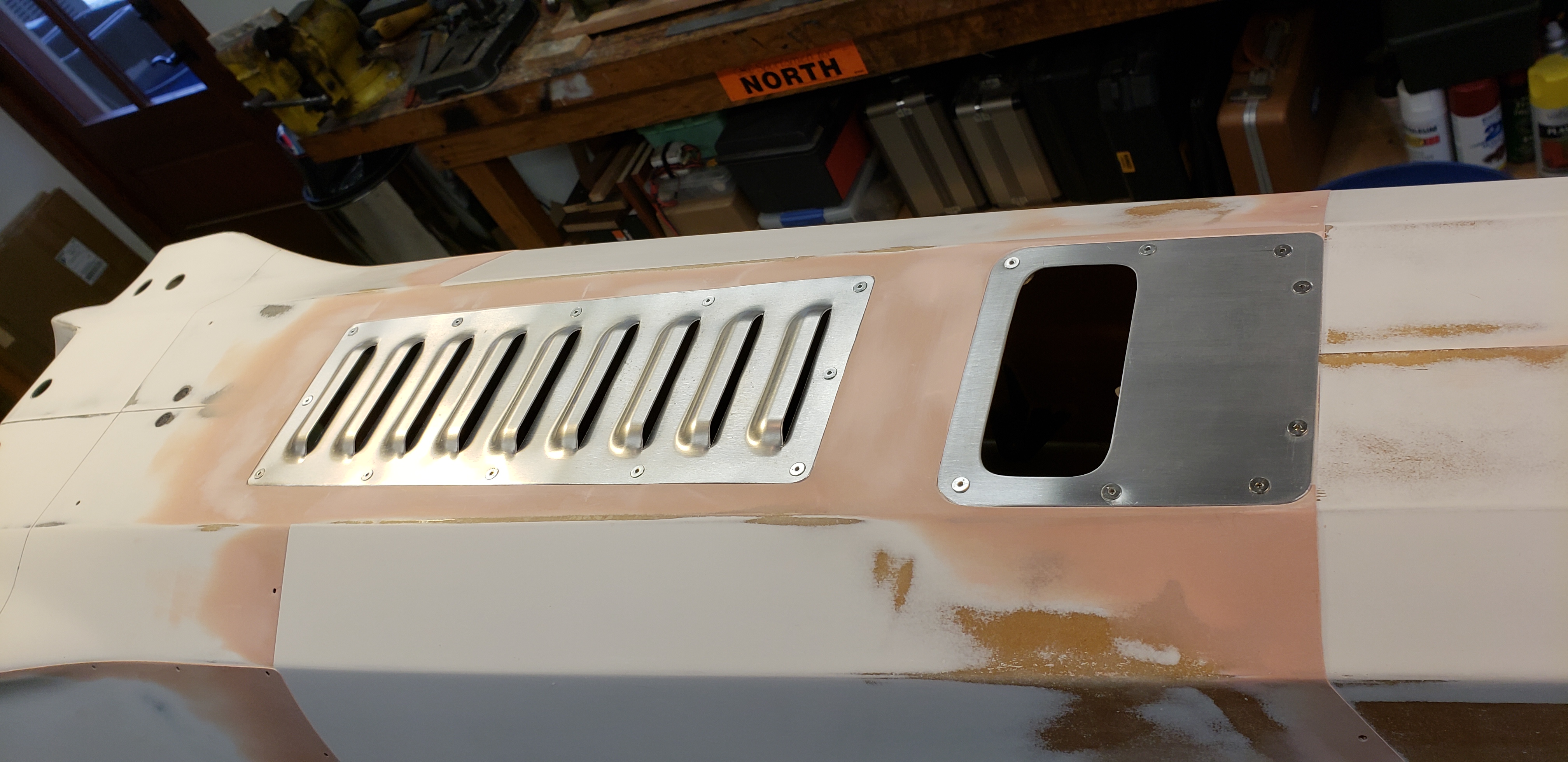

    400 grit at a minimum, I would say 500 or 600 for your final sanding would be great. SEM Self Etch works good, but doesn't fill very well. We use it on small sand through areas here in the shop, and have for many years.

    Back in the Enamel and Lacquer days we used 360 as our final sanding grit. Basecoat is much thinner paint and sometimes the metallic will lay strange and show funny scratches if you use to rough a grit. I will add that I don't miss Lacquer or Enamel at all. ;)

    Thanks for the feedback guys. Looks like I'll finish with 600 before primer!

    Anyone who takes all the time and effort to CREATE raised panels....and then FLUSH mounts louvers and exhaust exit trim us NUTS!!!

    Very nice, how did you make the raised panels?
