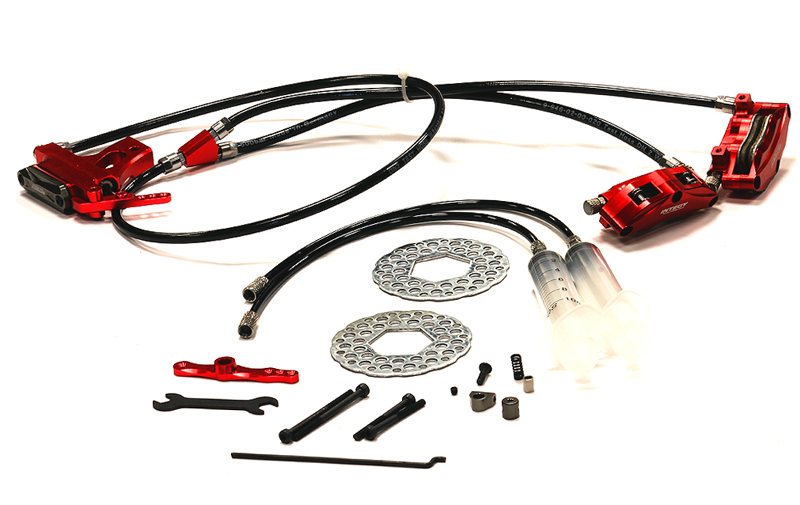

    Not all that expensive. Under 150.00 for some and about 225.00 for all four wheels on a 1/5th scale car or truck.

    Have to see if we can get it mounted on the tail wheel.

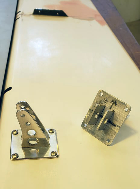

    Well....I guess I'm fully committed to one servo per aileron! I'll be using a single Futaba A700 on the inboard locations only. These put out 1000 in/oz of torque which will be plenty. To help assure that the single control horn handles the loads, I made up some aluminum mounting plates that capture each horn. There's a steel cross-pin through the control horns just beneath the surface of the pate. These assemblies will be Hysol epoxied in place, including the 4 corner screws that are threaded into the existing hardwood block inside the aileron.

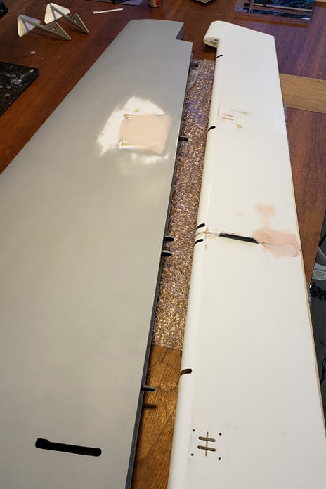

    I thought about just leaving the outboard servo hatch and slots accessible if needed down the road....but then thought "GO FOR IT" and sealed them up, so they'll disappear under the paint. I did make a tracing of their locations just in case I wish to find them at some point in the future...although doubtful :confused:

    More than enough torque and like the brackets they are never coming out. You hang the plane of one bracket and then hang on the plane and they will still be connected.
