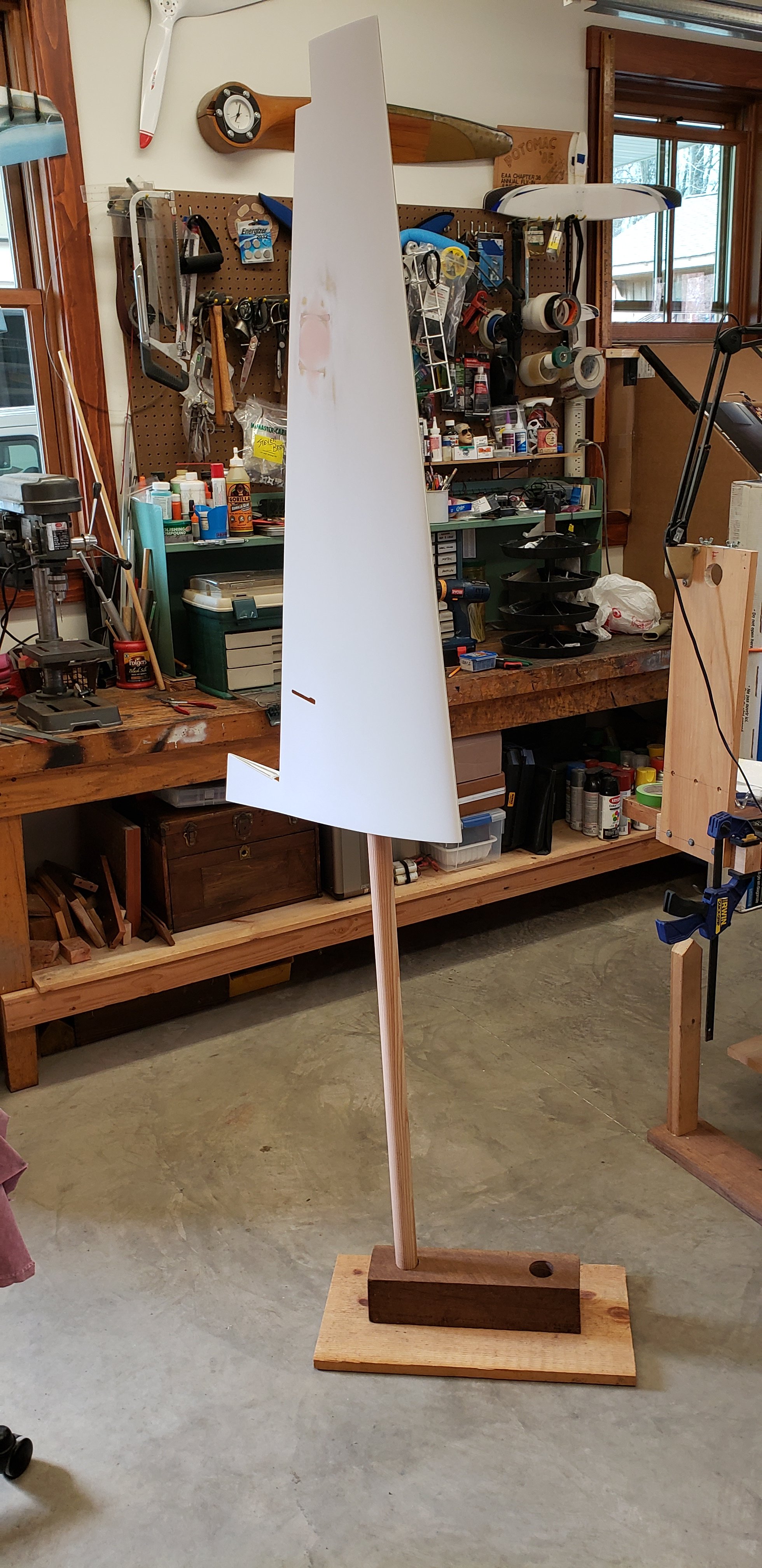

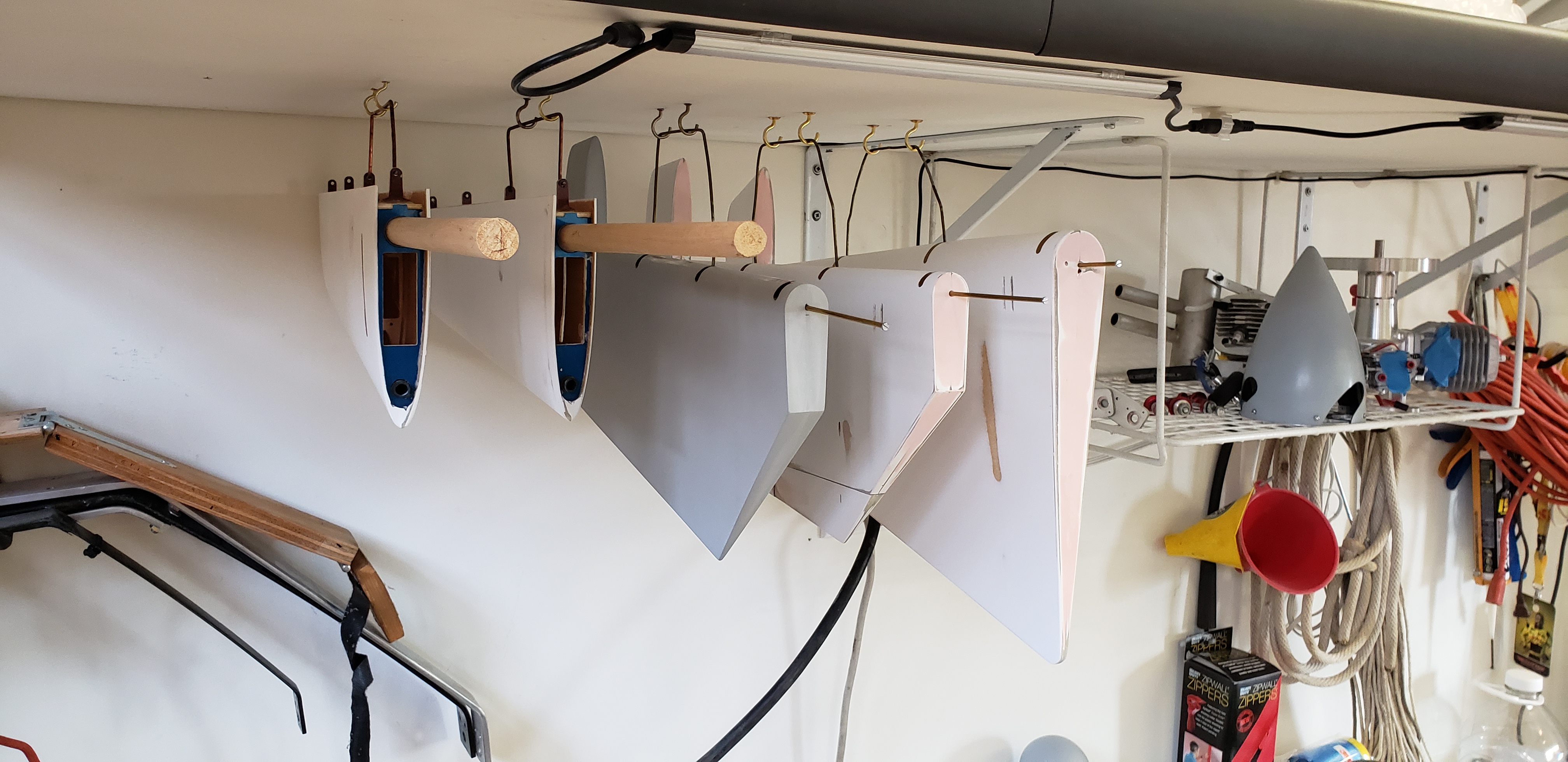

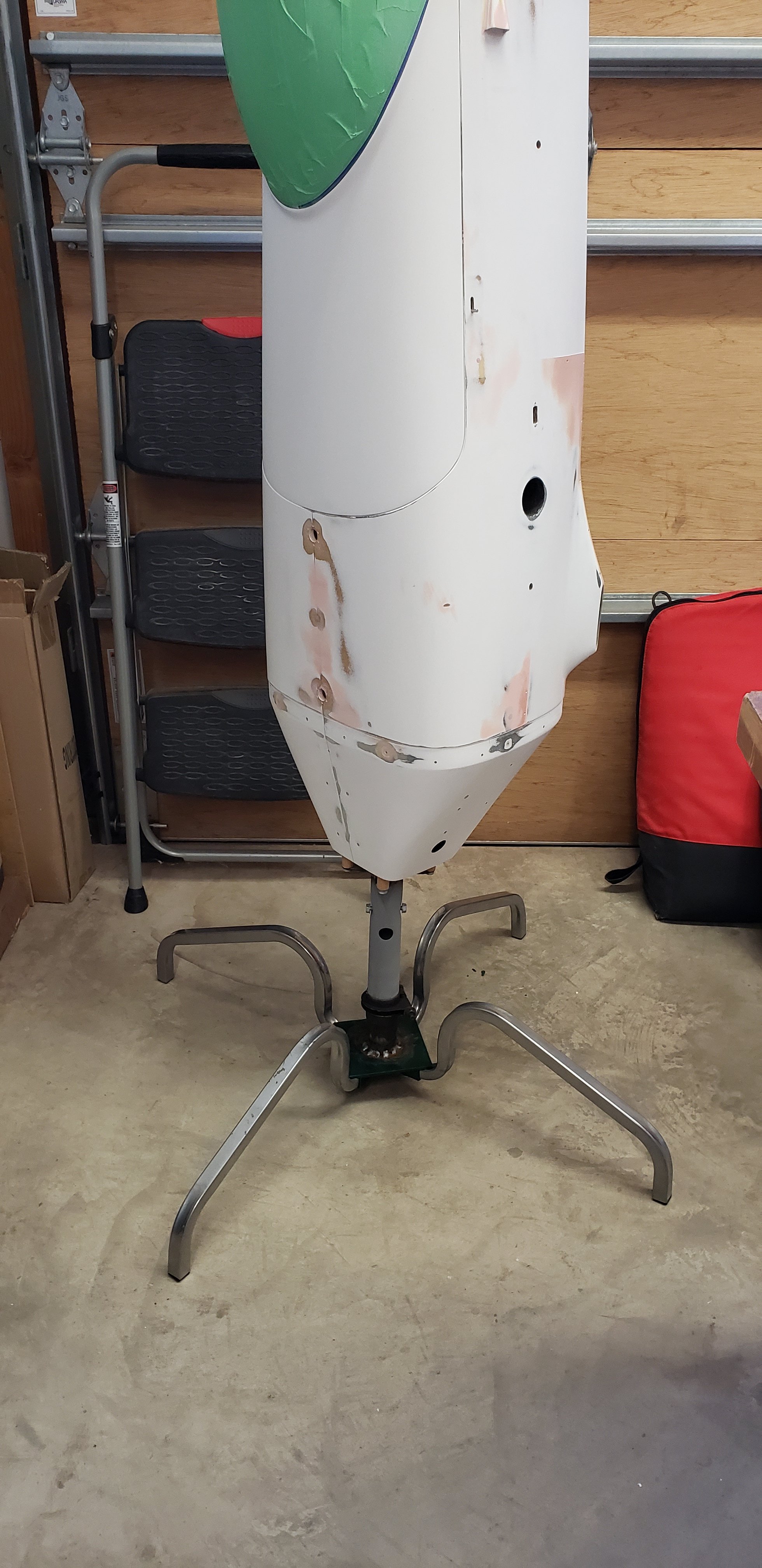

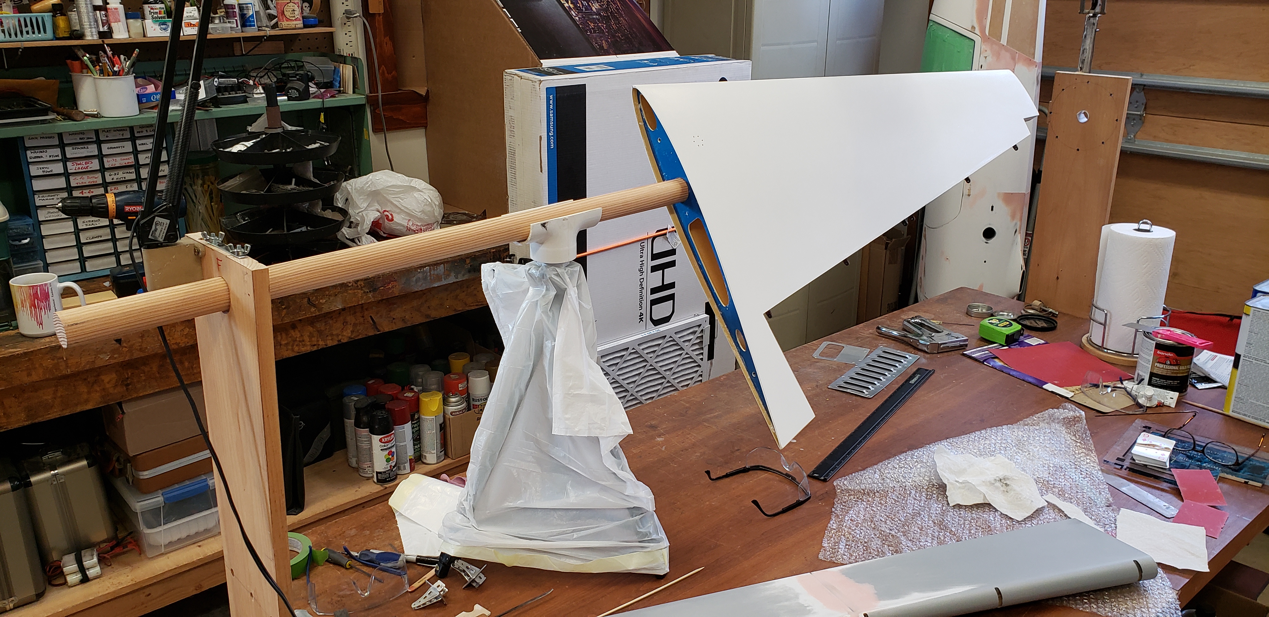

    Repurposed an old Christmas tree stand for fuse. Wing in painting rack...rotatable and drying rack on floor.
    Decided I better figure out how to hold all these peices during the painting/curing process.
    Will be setting up my paint booth this weekend.

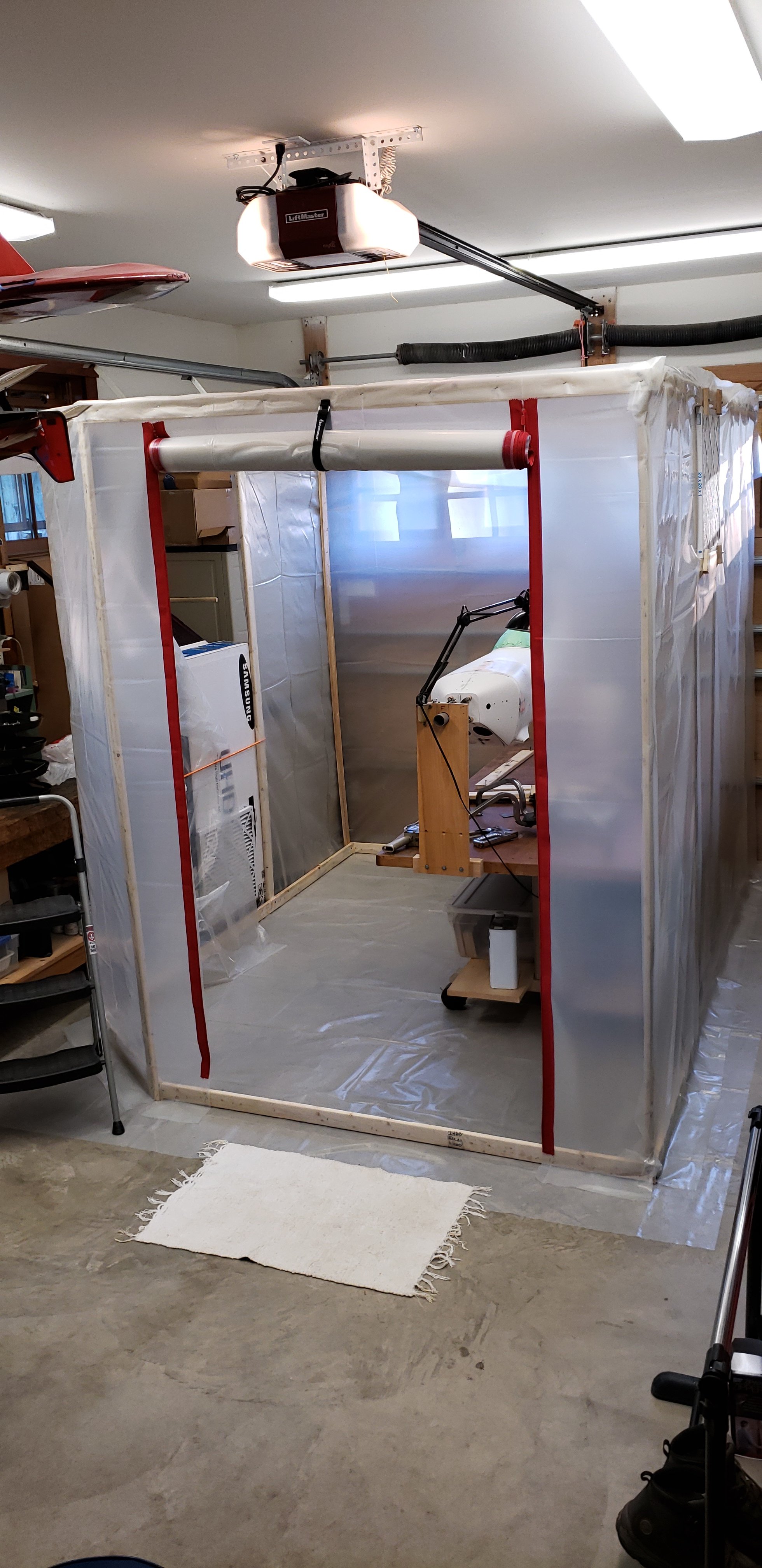

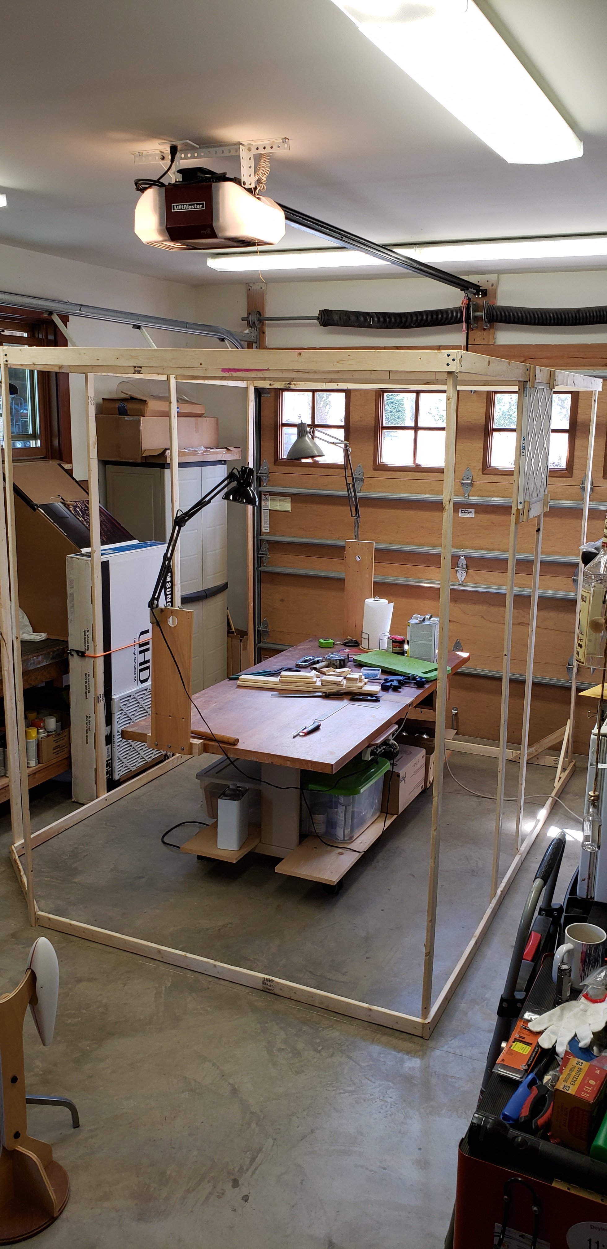

    Almost ready to shoot some paint! Guess I better get to the paint store, eh!

    It’s amazing how we do things the same. One question do you have fan to extract the air.
  10. Pistolera
    Yep...in the 1st pic on the left side note the box with the filter low near the floor. It's connected via cardboard ducting to a box fan in the shop window.
    High on the right sidewall is the intake air filter.
    Hoping to get a nice down/side draft. We'll see!
