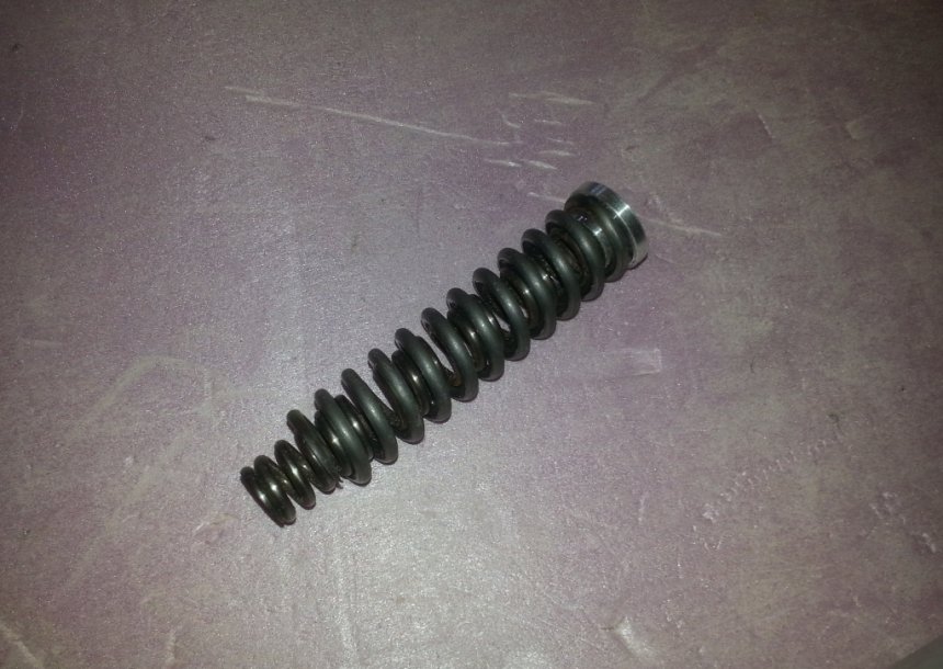

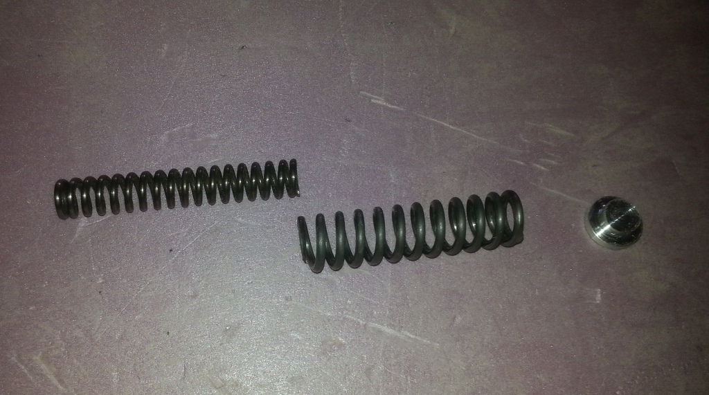

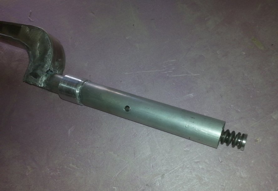

got the springs for the oleo struts, , you will notice there is a small one inside the bigger on, and its 1/2 inch longer , this is to smooth out any bumps in the pits or whatever , but when the actual landing occurs, the small one will dampen quickly and the bigger one takes over. (hopefully) at least that's the plan LOL.
