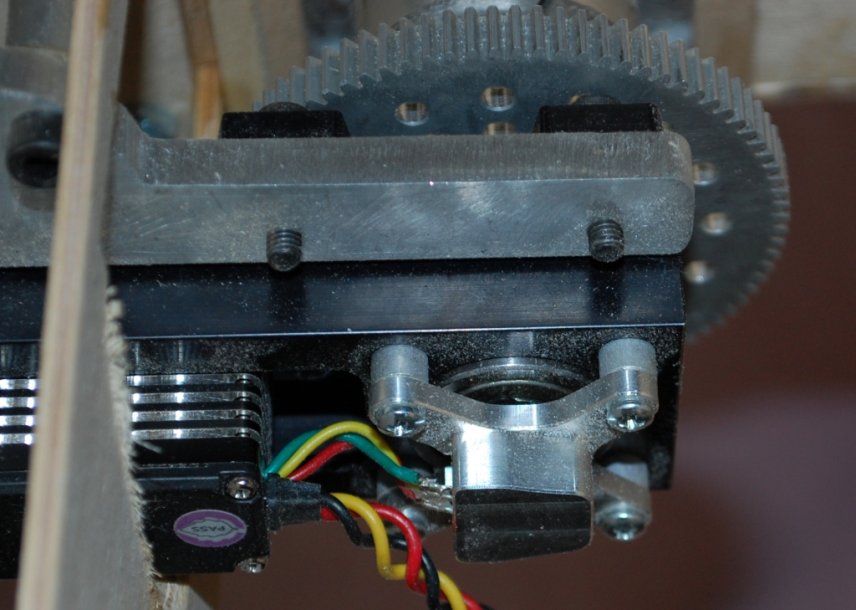

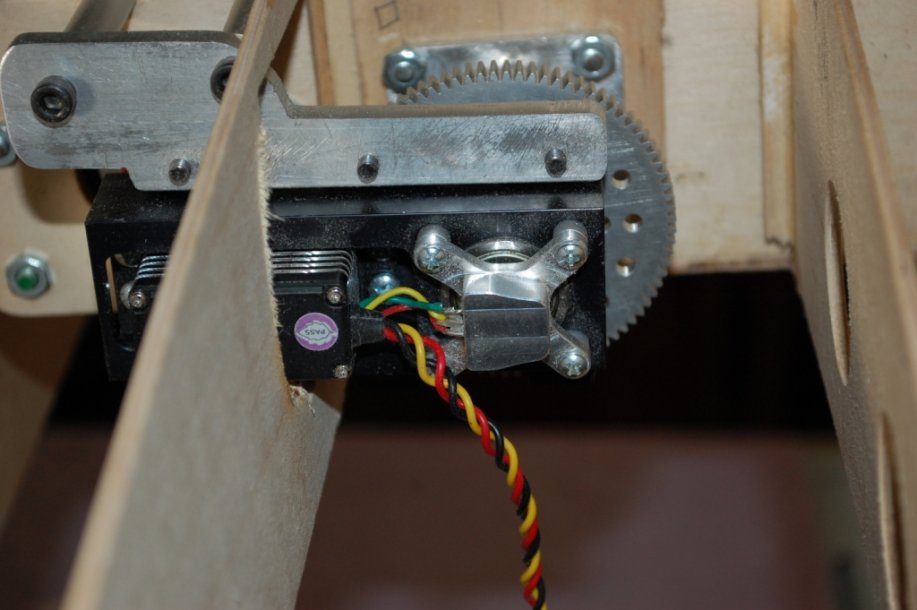

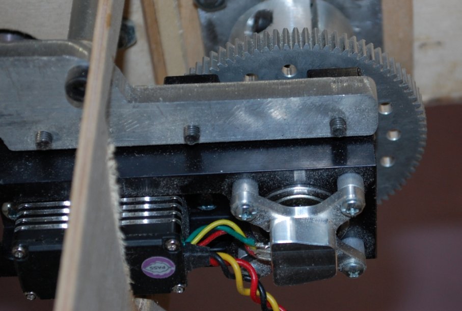

Another thing you all have taught me! I didn't know you get more degree out of a servo like this, I thought they all had a 180* mechanical stop? Thanks for the info!
These particular servo/gearbox combo for servo city, , you can also get them without feed back pots or without servos, so its great they have these
without the servo feedback pot inside the servo, means the servo will rotate continuously, and this is why the feedback pot is under the big gear I will have to remove the servo from the wing to send to them so I will show more about the feedback pot
Here are a few pictures of the back of the servo/gear feedback pot
Well shut my mouth...I didn't realize the "POT" was on the outside of the servo. Very clever. Now it all makes sense..... (that moment when the lights finally come on in a very darkened room) PRICELESS.... LOL
