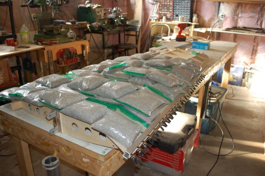

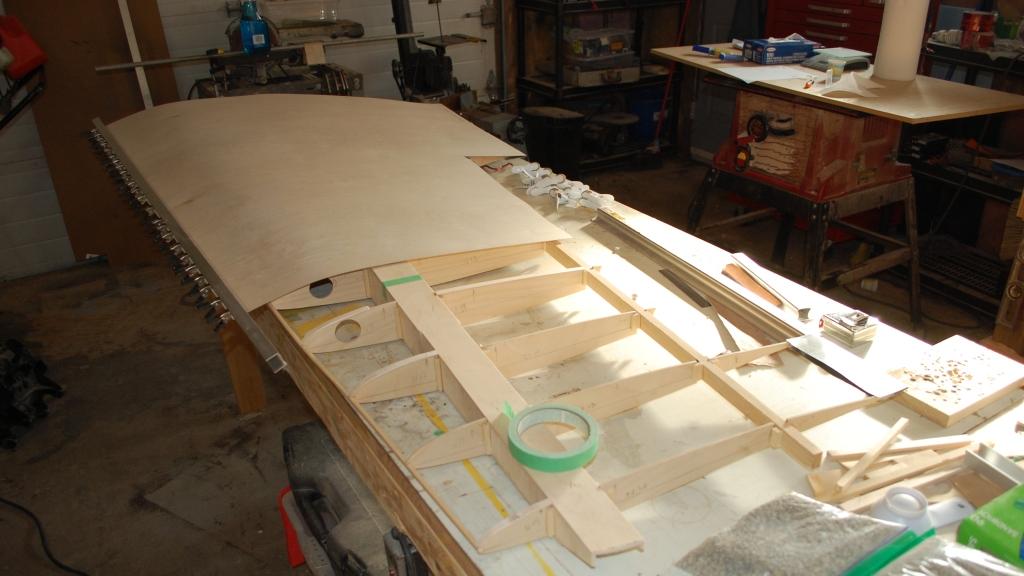

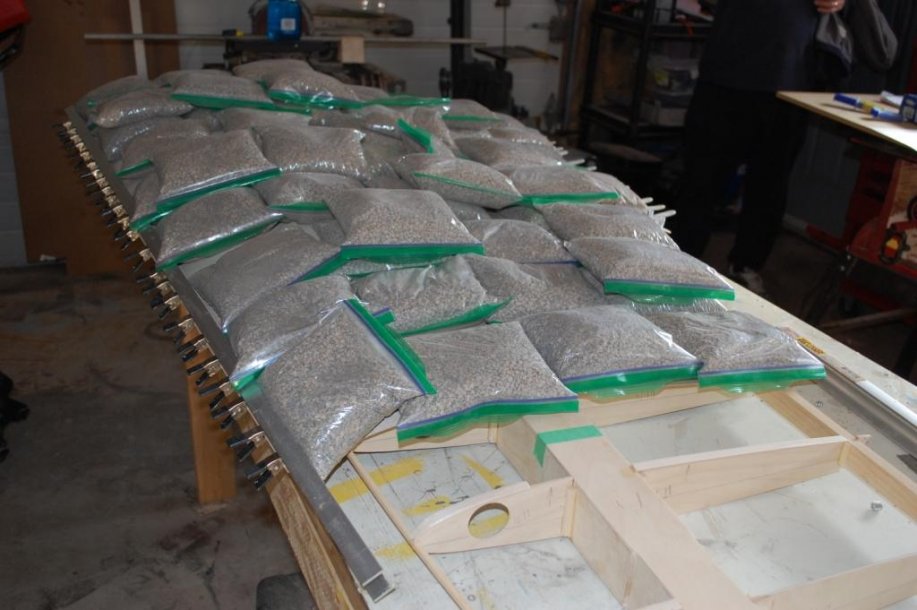

One part sheeted with all of 36 kg of cat litter spread out in sandwhich bags, 24 hours to wait before removing the bags , and start on the other end of the wing.

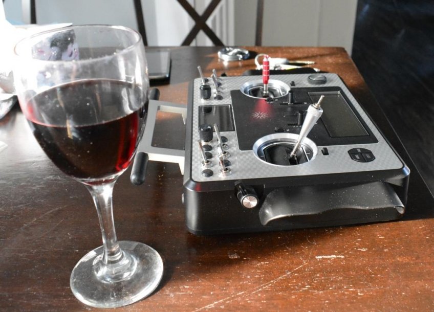

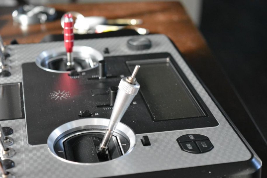

while waiting for the plywood to take shape I made a stick for the radio with a tiny switch in it , still touch up to do but.

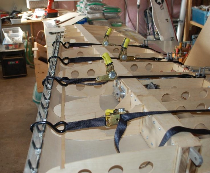

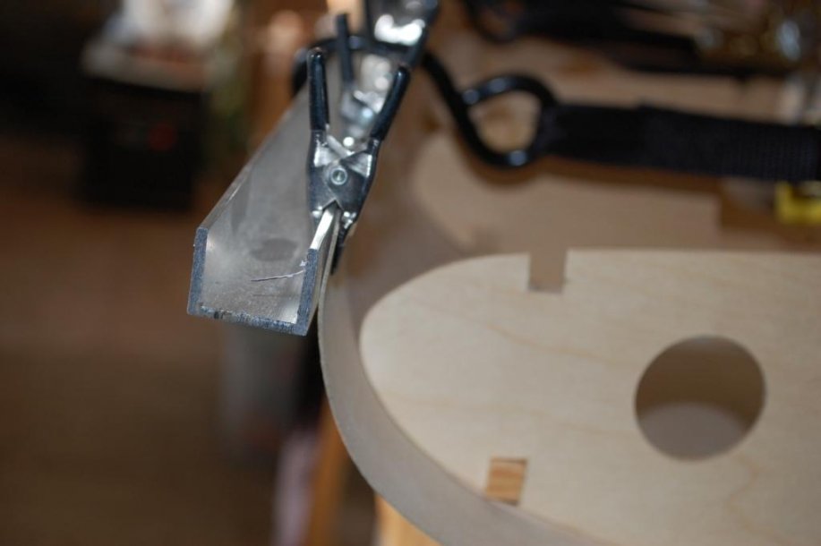

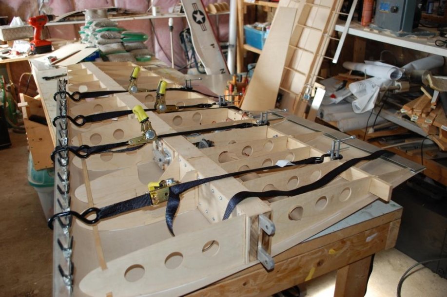

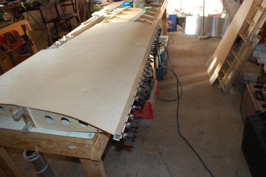

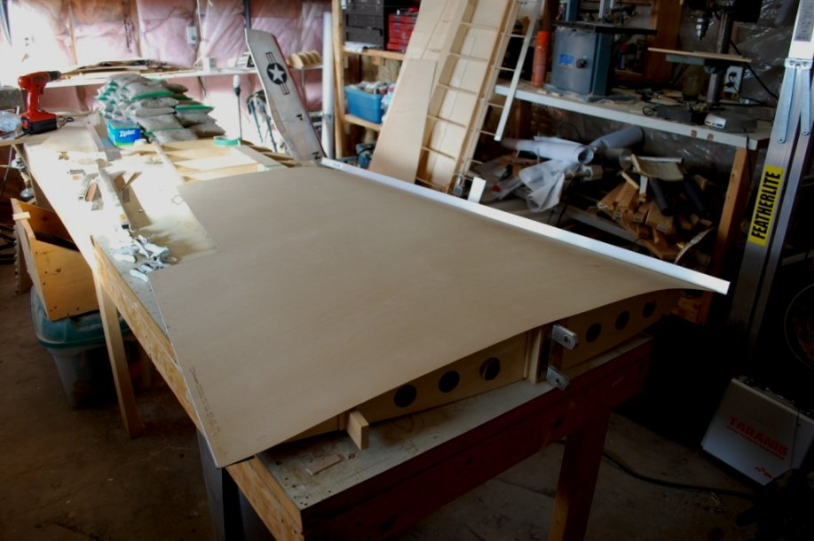

the sheeting done , not all the way to the tip but for now turned it over and double checked the glue joints and all is good, at the same time I am continuing the folding over the leading edge and it is going very well,
