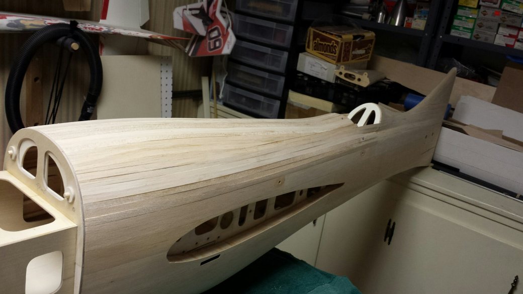

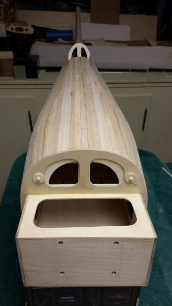

I installed he last of the planks on the hatch tonight. I see a lot of sanding in my future tomorrow.

Very nice... always impressive to see someone who can start with an idea and some sticks and stay with it until it flies. I bought a Stearman kit once, never glued the first 2 pieces together, sold it about 4 years later.
Do you plan on the typical red/white scheme?

I'm not sure on the scheme yet, but it will be in a classic style. The red and white was always on the top of my list, but I also like red and black and yellow and black.

Don't know if you mentioned it, but what glue are you using for the planks?
I'm using thick CA to attach the planks to the framework and Sig "Sig-ment" on the edges of the planks. Sig-ment is thick enough to stay on the edge and sands really easy when dry.
