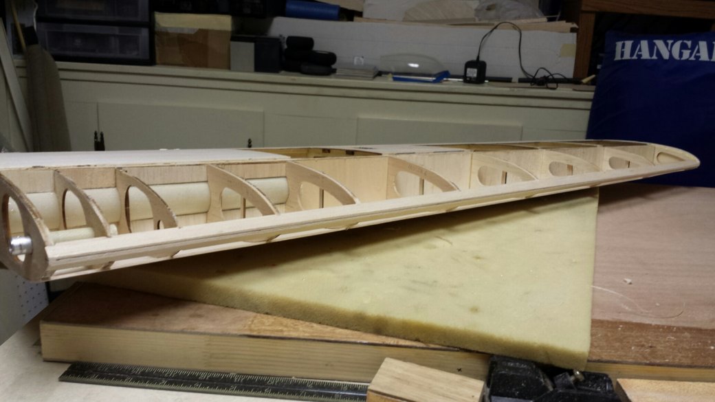

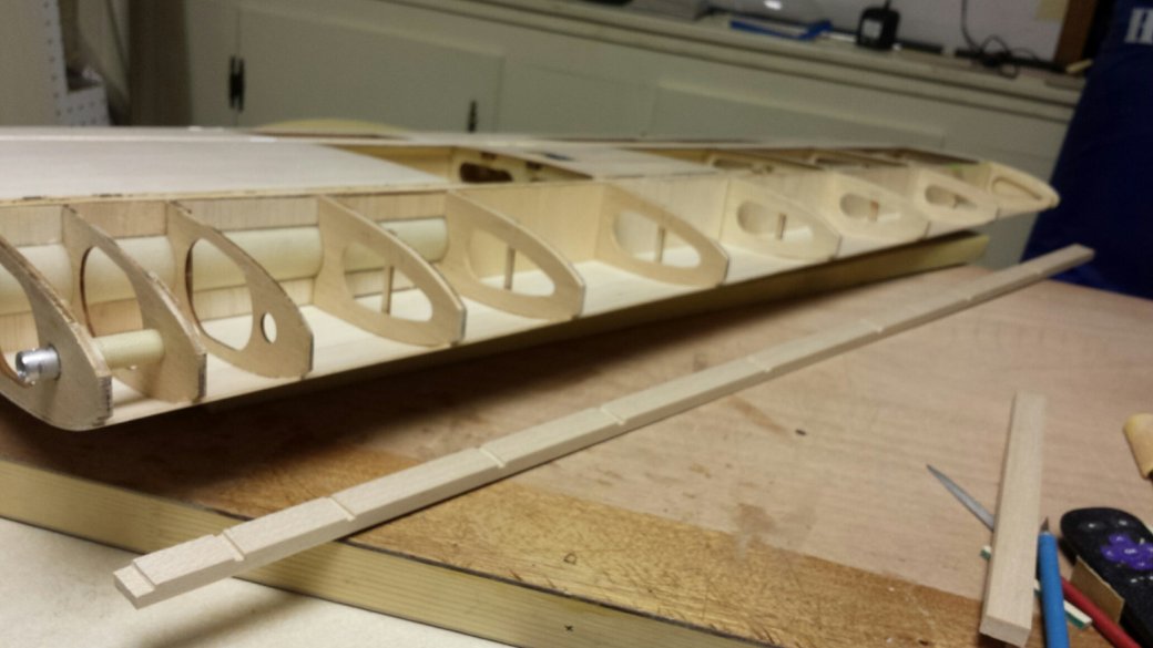

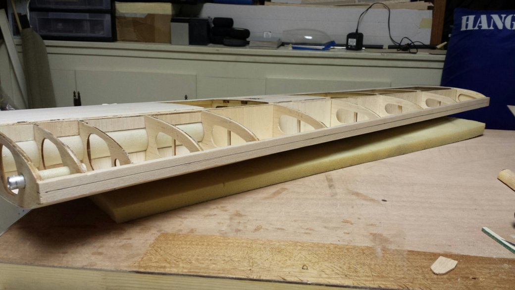

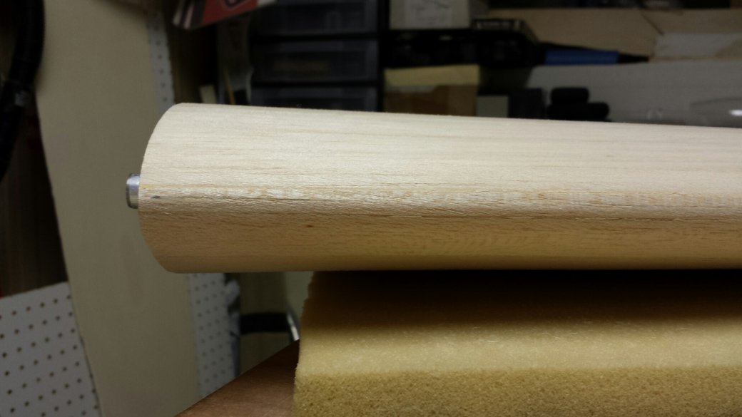

Very cool idea. I really like that....I built a new leading edge tonight from 3/8" x 3/4" balsa. It's grooved to fit each rib. Next up is a lot of sanding to prep the leading edge for sheeting.
View attachment 13411 View attachment 13412

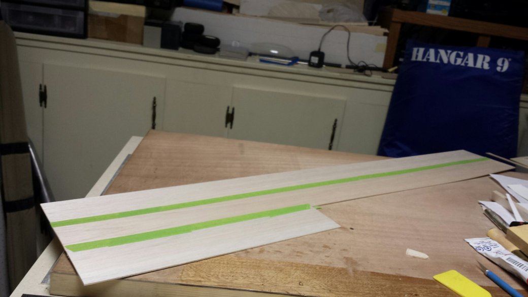

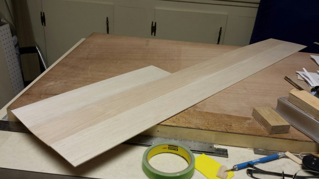

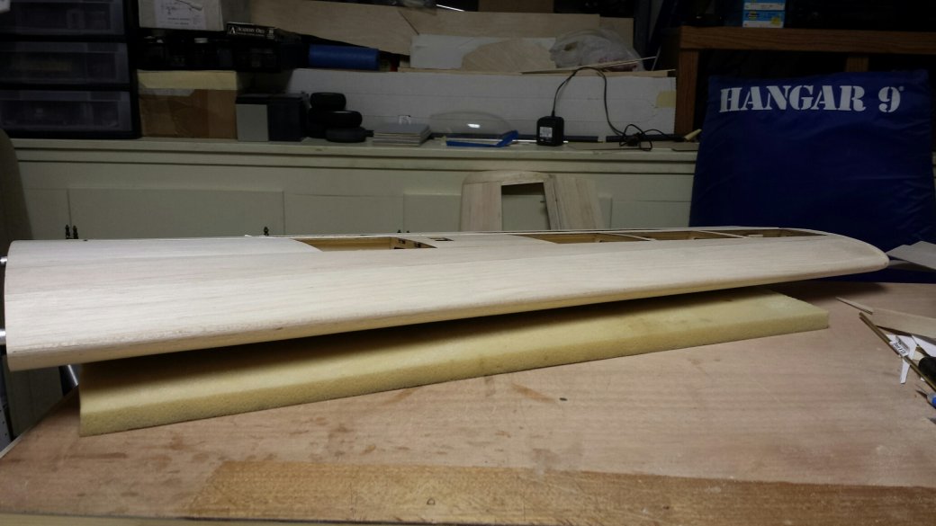

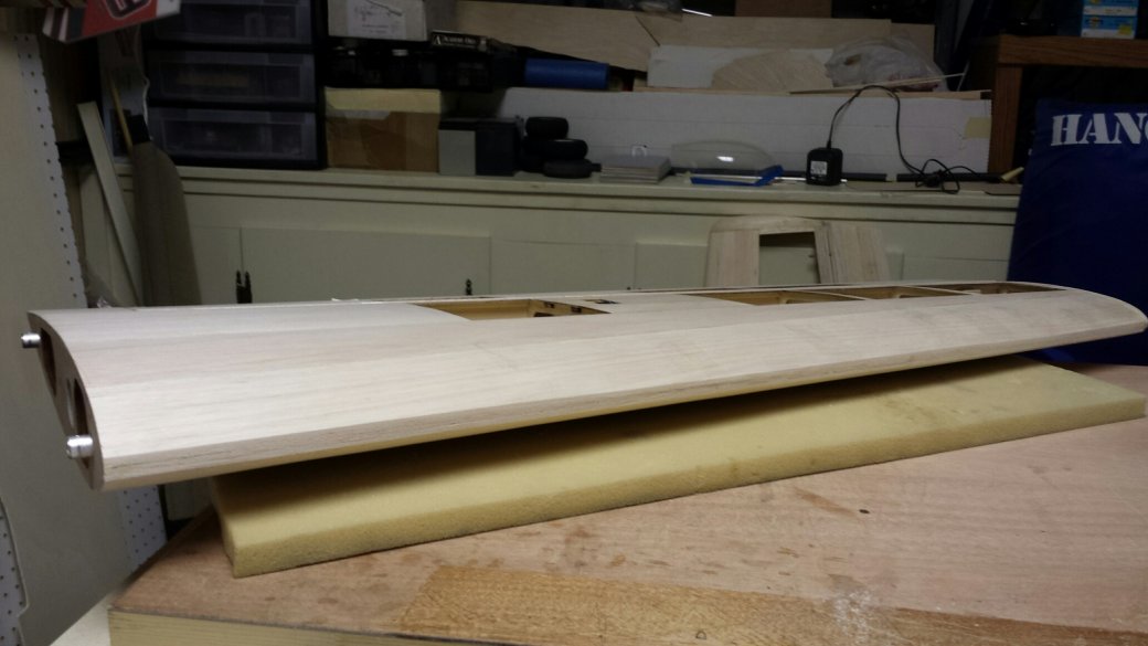

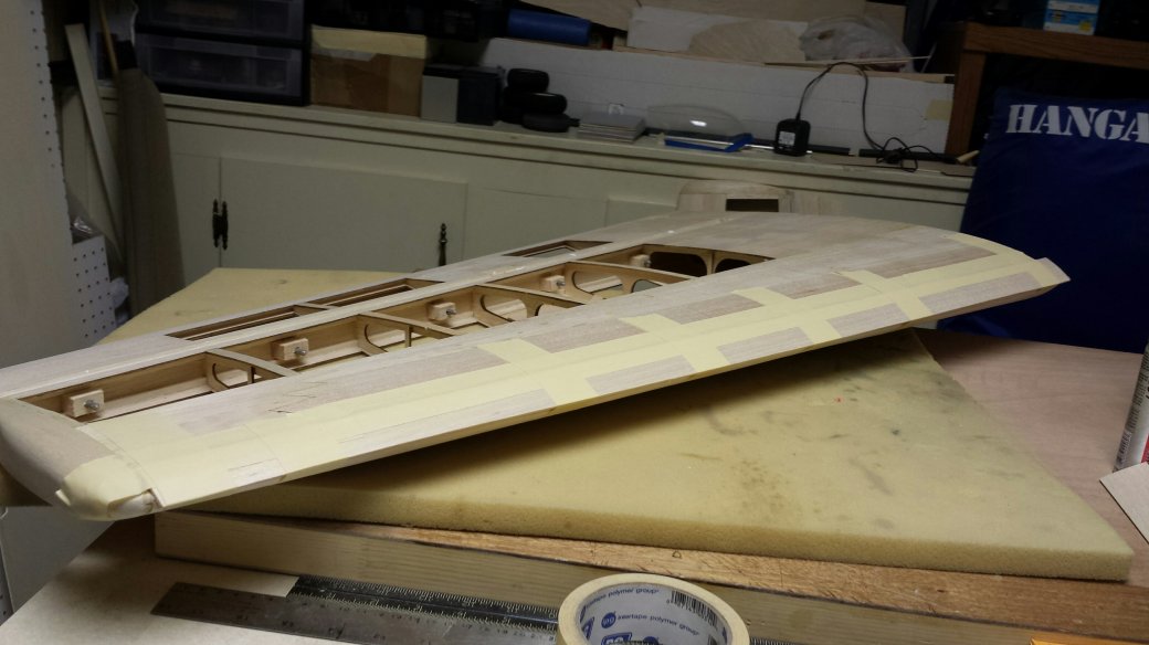

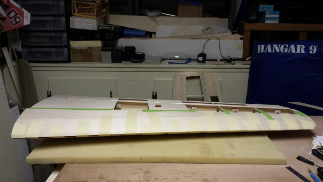

fricken fracken %$***..After a near disaster yesterday in a failed sheeting attempt, I did get the bottom of the wing sheeted this evening. I have sheeted many wooden wings over the years, but for some reason I really screwed up the first attempt. I was so mad I sounded like Ralphie from A Christmas Story when he was beating up the bully. Thankfully the second attempt went as smooth as silk.
View attachment 13825 View attachment 13826 View attachment 13827 View attachment 13828
Is there a huge benefit from the notches?I built a new leading edge tonight from 3/8" x 3/4" balsa. It's grooved to fit each rib. Next up is a lot of sanding to prep the leading edge for sheeting.

It's the way Aeroworks built the wing originally. I would guess for ease of assembly for the most part, but I imagine there is added strength as well.Is there a huge benefit from the notches?
