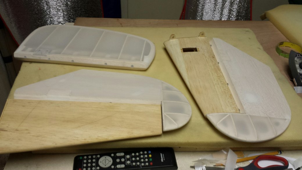

Well I finished covering the tail surfaces yesterday. After I covered the first half of the one I posted earlier this week I really didn't like the way I did structure in the tip, it just didn't look right covered. So, I added another rib at an angle in the front and recovered it. I'm much happier now.
The tail surfaces are ready for primer.
The angled rib looks terrific. It adds just the right contour and look.
You getting there slowly. It sure takes a lot of time to scratch build a plane the way you are doing it but when you are done there will be nothing like it and your own.
