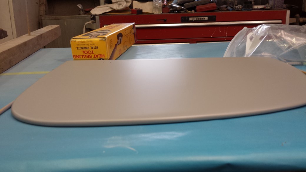

Just for the record when I primed yesterday I used Nason 421-19 primer with 483-87 activator at a 4 to 1 mix. To that I added 7.5% DuPont 2350S flexible additive. I then added a little less than 10% Nason 441-21 reducer. The cured primer is very flat and smooth and not grainy at all. It should sand easy.
I took a photo of the rudder trying to show the surface of the primer in the light reflection.

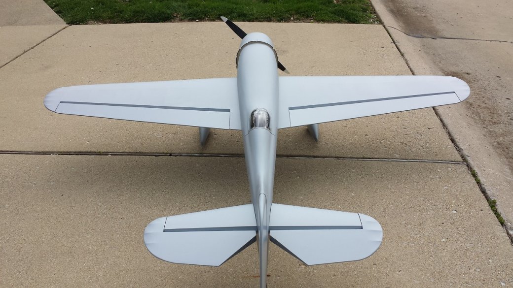

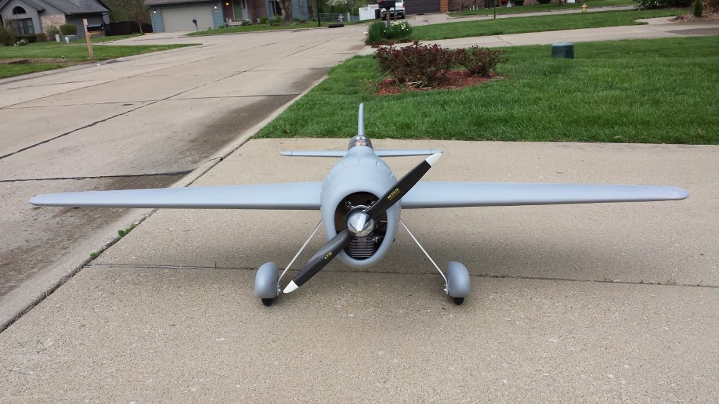

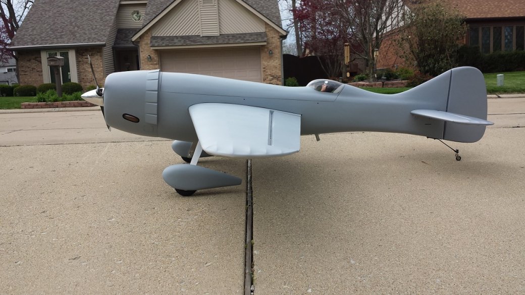

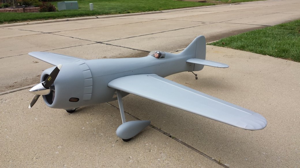

I assembled the plane this afternoon so I could take some pictures to stare at for finalizing the scheme.
View attachment 54225 View attachment 54226 View attachment 54227 View attachment 54228
It's just my opinion for what it's worth, but I really think a major ARF manufacturer should be offering you a ton of dollars for that design. Truth be known, I would buy one right this minute if it were available. I think that design of yours is totally bad ass. You are the master.
Hell yes! Might be time for another "design a scheme" contest. :D
I have to agree...
