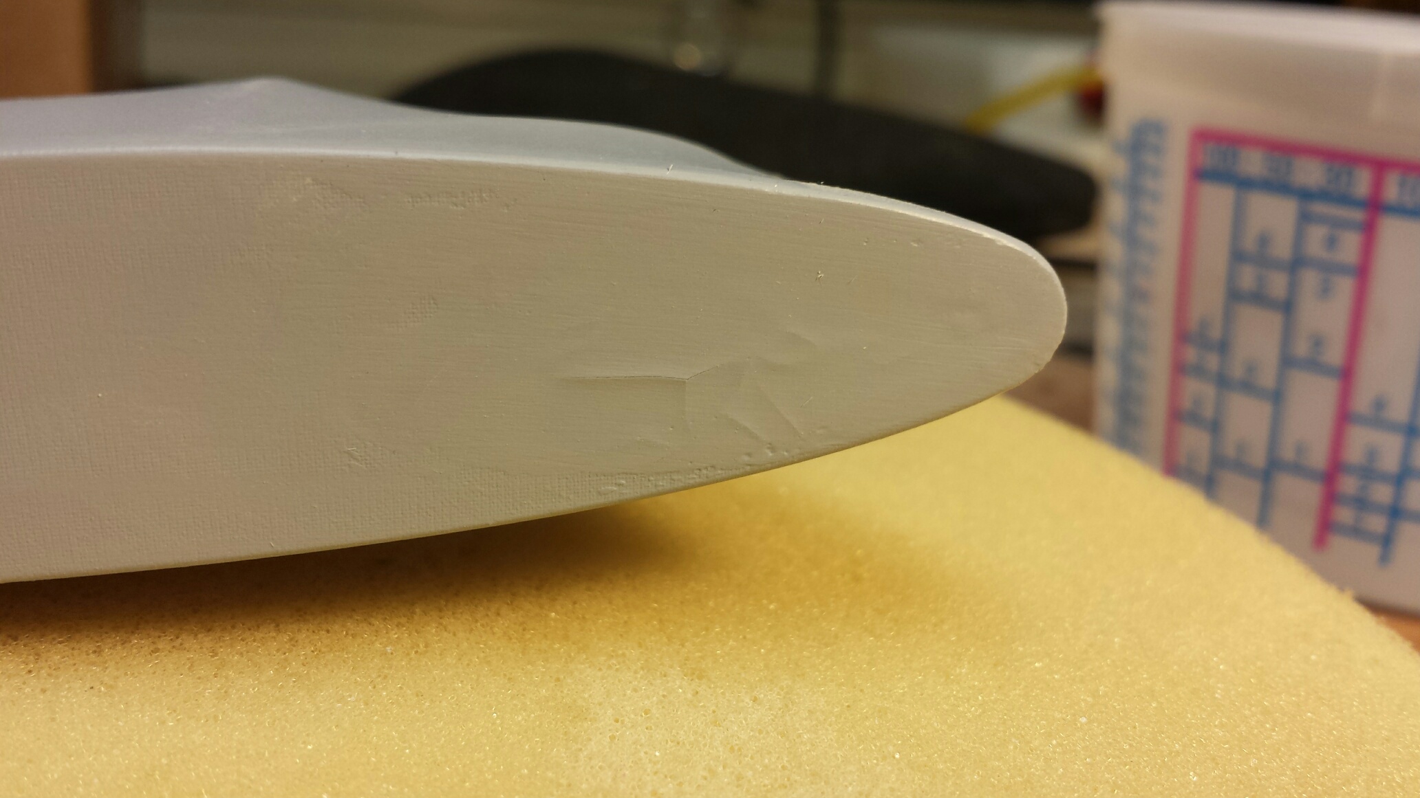

I always preach using only 2 part catalyzed products when painting. They only singe part product I use is the SEM Self Etch primer I talked about. Well, this is exactly what happens when I don't follow my own advice. The Lacquer based spot putty I used to get rid of some seems cracked.
So, I spent a good part of last night sanding it off. Thankfully it mainly only did it on the elevators on the flat inside ends where it's against the stabs, and the area that's angled for the rudder.:msn_slap:

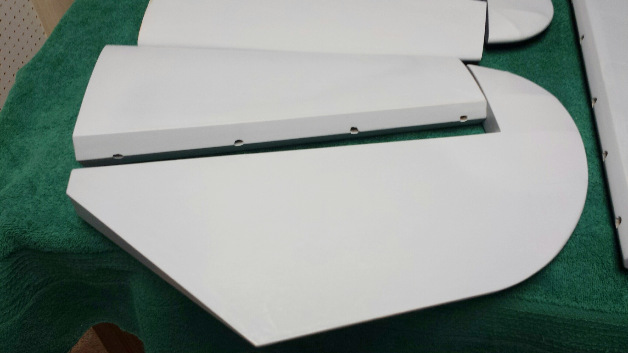

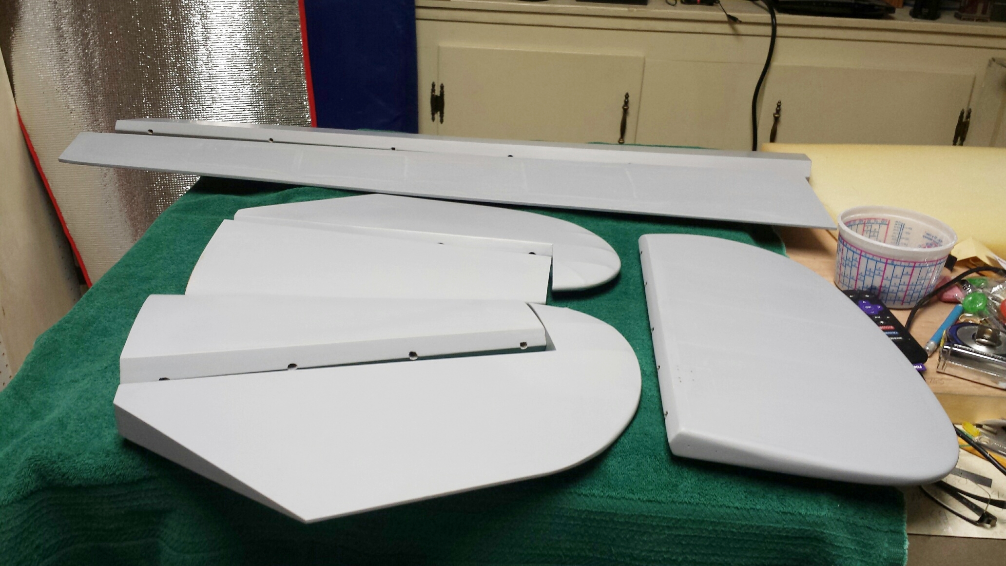

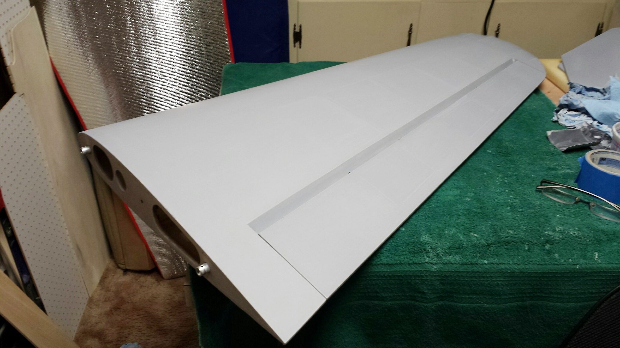

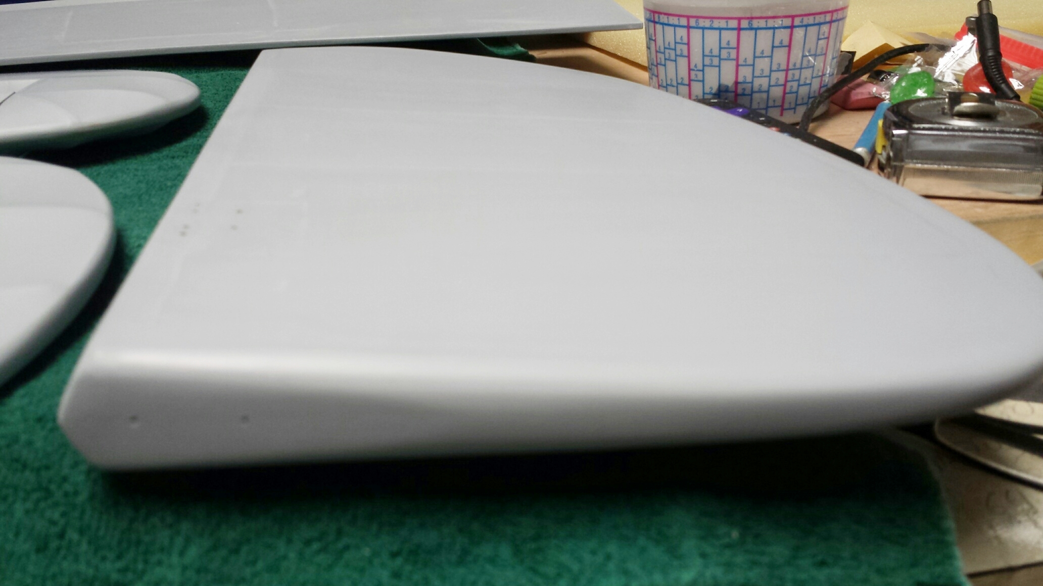

I've been sanding for the last few evenings and have all the tail surfaces, ailerons, and one wing ready to paint. I plan to finish the second wing tonight then I have to make a hatch to cover the tuned pipe exit in the fuse. After that I'll get the fuselage sanded.
