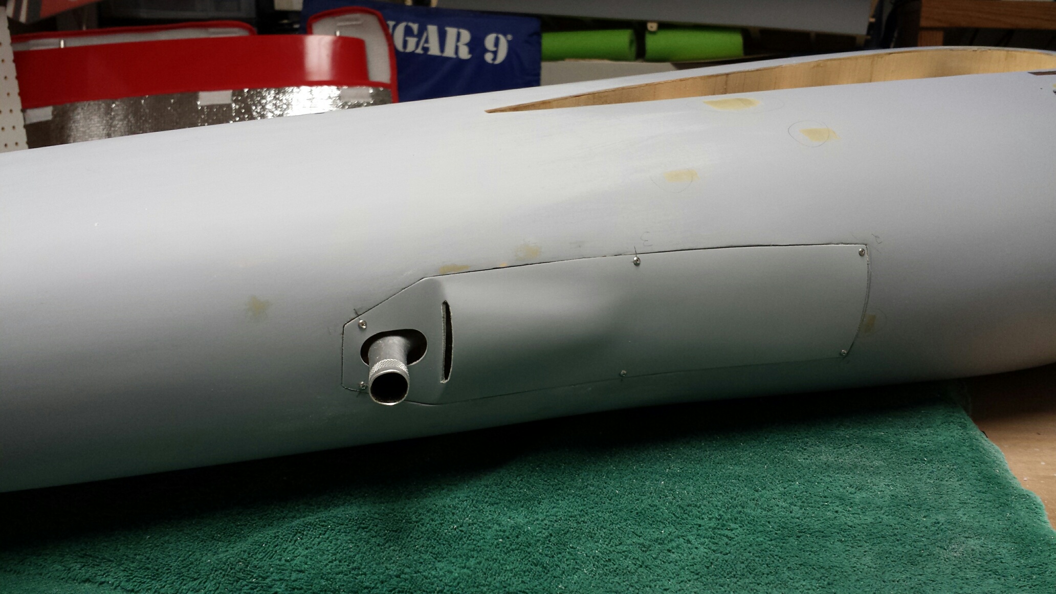

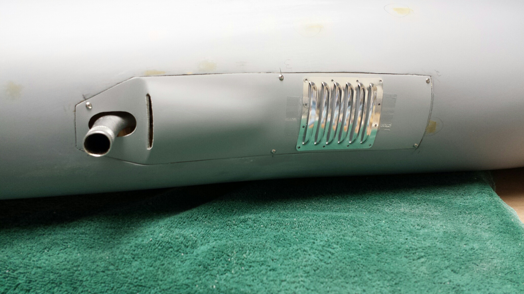

The glass cloth would not lay down in the louvers. If I was making a plug, then a mold, and pulling a part from that I would have had a better chance, but even then to get it thin enough to open up as a louver I think you would need to vacuum bag it.
I cut the hole for the pipe stinger in the hatch and opened up the small vent at the rear of the pipe bump. I'm going to cut a lengthwise vent in the pipe bump just above the pipe since it's pretty tight in there. I'm also going to add an aluminum louver to the front. I taped one on last night to see how it fit. I had to do a little bending, but it should work well. I'm going to try to use one and a half of the aluminum louvers, if I can make it look right. I just ordered two more of them from Taildragger.

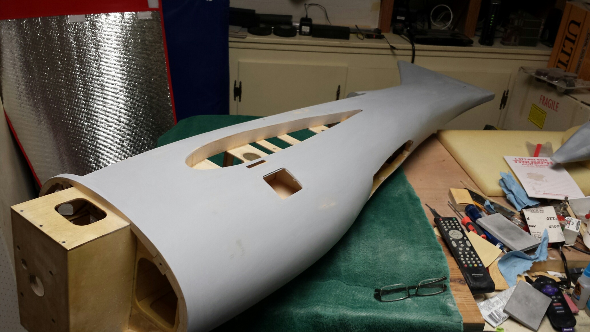

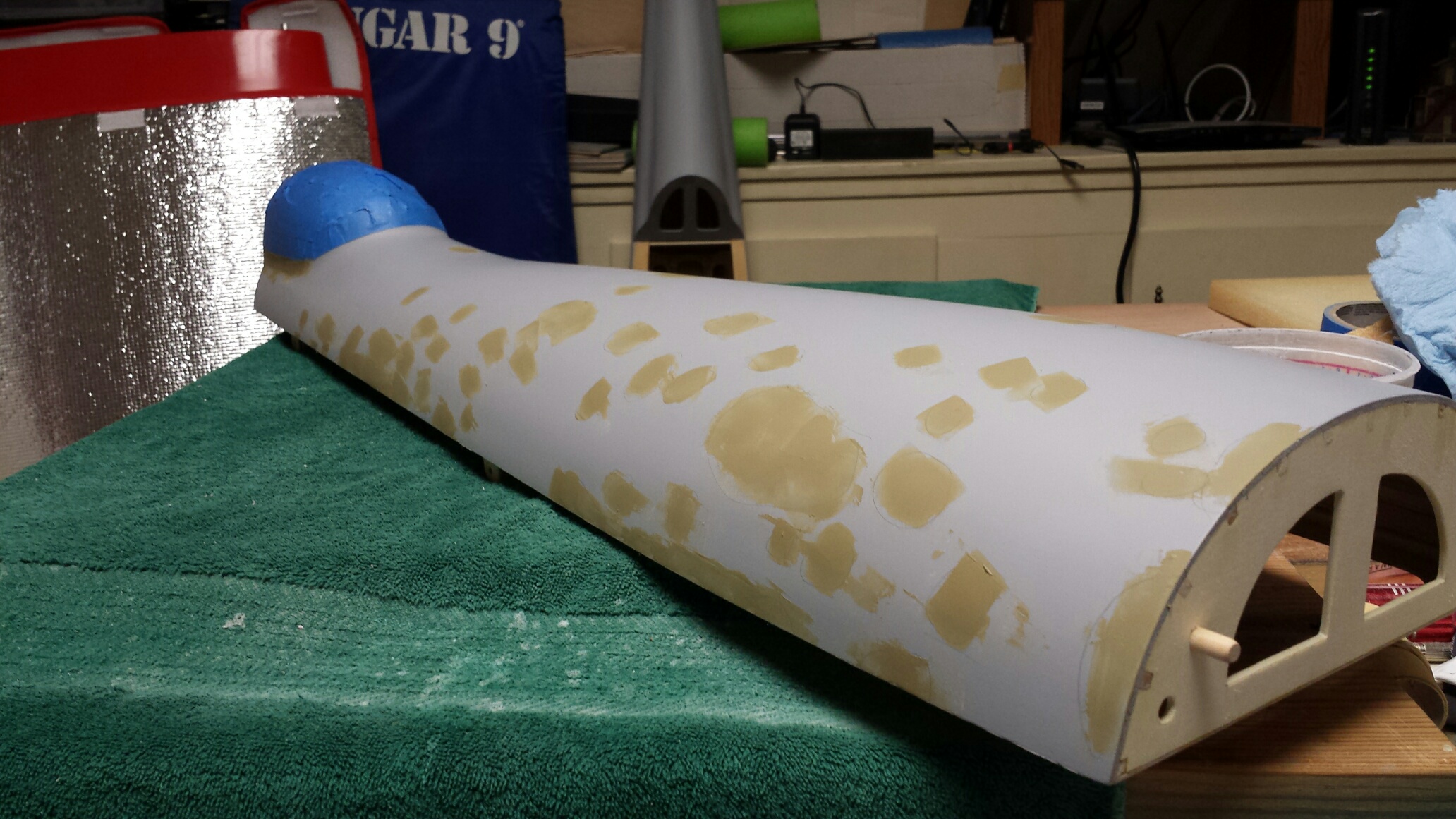

I finished getting the fuselage ready to paint tonight, after that I worked on the the hatch and the wheel pants. I've got the wheel pants almost ready, but the hatch had a few pinholes...... YIKES! Looking at it in normal light it looked pretty good, but when I used my flashlight trick there were tiny pinholes everywhere. Better to catch them now!:)

Looking great! Your up to the part I enjoy the most, painting. That thing sure has some nice curves to it, it would make a great subject for an all glass fuse (hint....hint)
Larry B
Ooh, a composite Culp Special? That could be intemaresting :)
I'm not sure the Culp would be my first choice for a fiberglass fuselage. Getting the stringers right in the plug would be a huge challenge. The green Culp, which is my favorite, has a lot more stringers than the other ones. I do love the Culp though.:)
