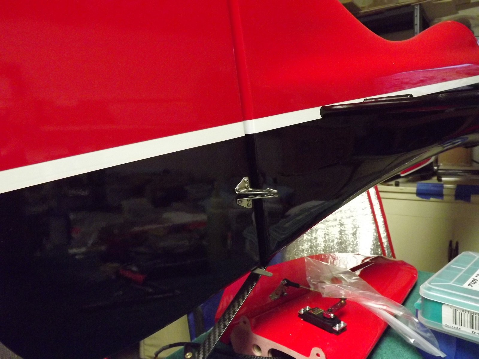

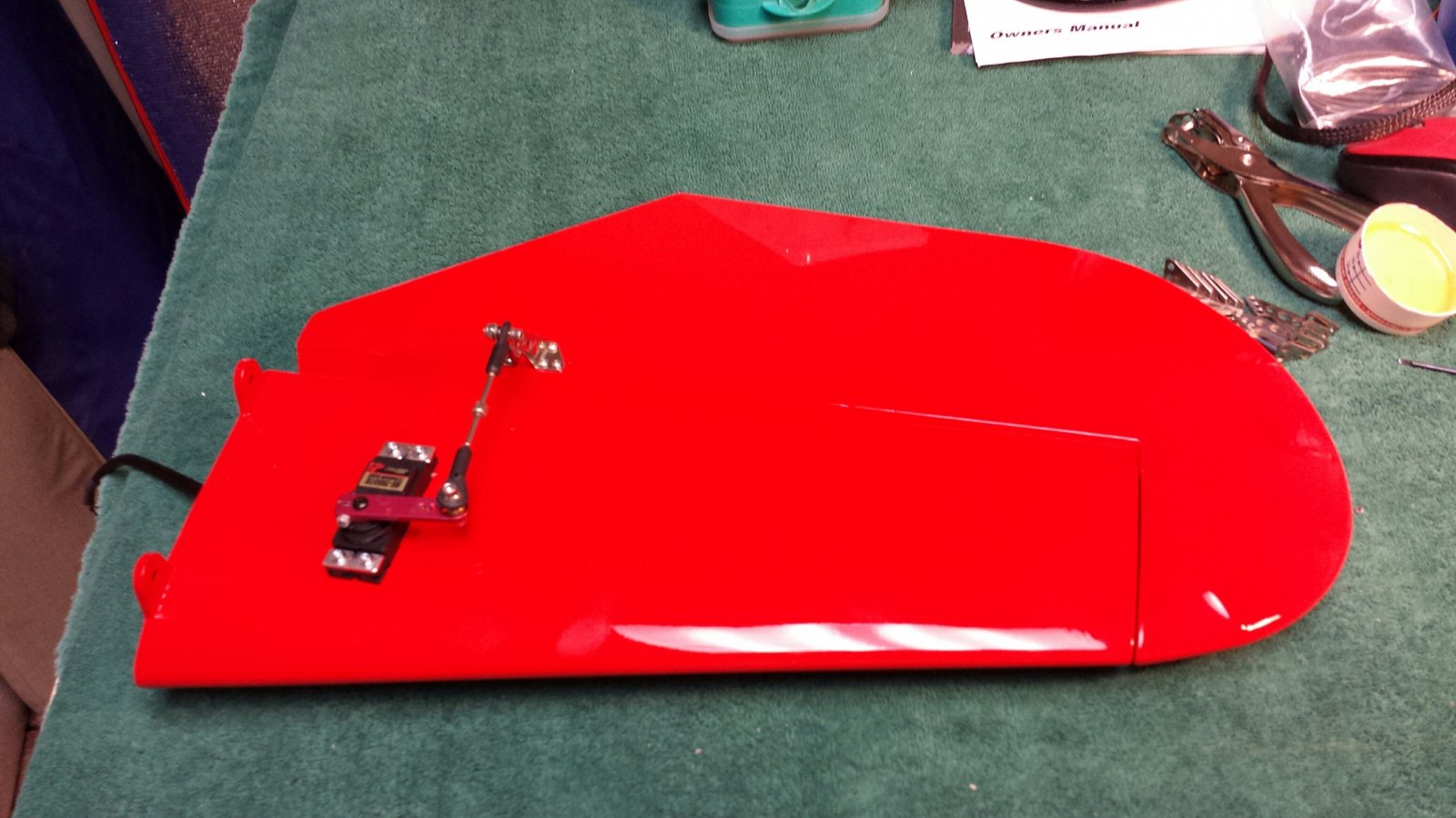

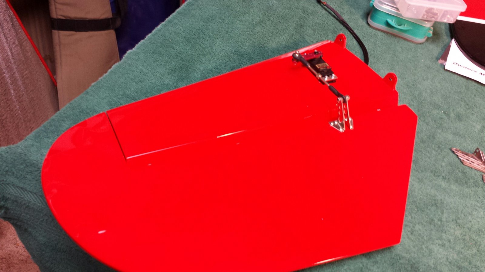

Since I finished my paint touch ups on my Carf Extra 330L and think I have it sold, it's time to get back on this project. I had a little time last night so I glued the hinges in one of the elevators. Tonight I installed the servo, horns, and linkage.
They've been forecasting "Icemageddon" here for this weekend , so I should get some work done on this thing. As long as the power stays on that is.:eek:

It will have HiTec 7955tg's on the elevators, JR8411's on the ailerons, a 7985mg on the throttle and a HiTec 7956shr rudder servo.

Was taking a closer look at the stabilizer see you are using those small flat plates across the servo bolts do you like them and were did you get them.

I use those servo plates on all of my planes including my 60 size pattern planes, I love them. . . . . . :yesss:. Unfortunately, I cannot remember where I got my last order of them as it has been a couple of years since I ordered any.:frown: For some reason Airwild comes to mind, but I'm not certain of that. If you decide to order some, and if I remember correctly, they differ based on servo manufacturer.

The plates are either from Spot-On or Secraft one or the other. I also like the carbon fiber ones from Align.

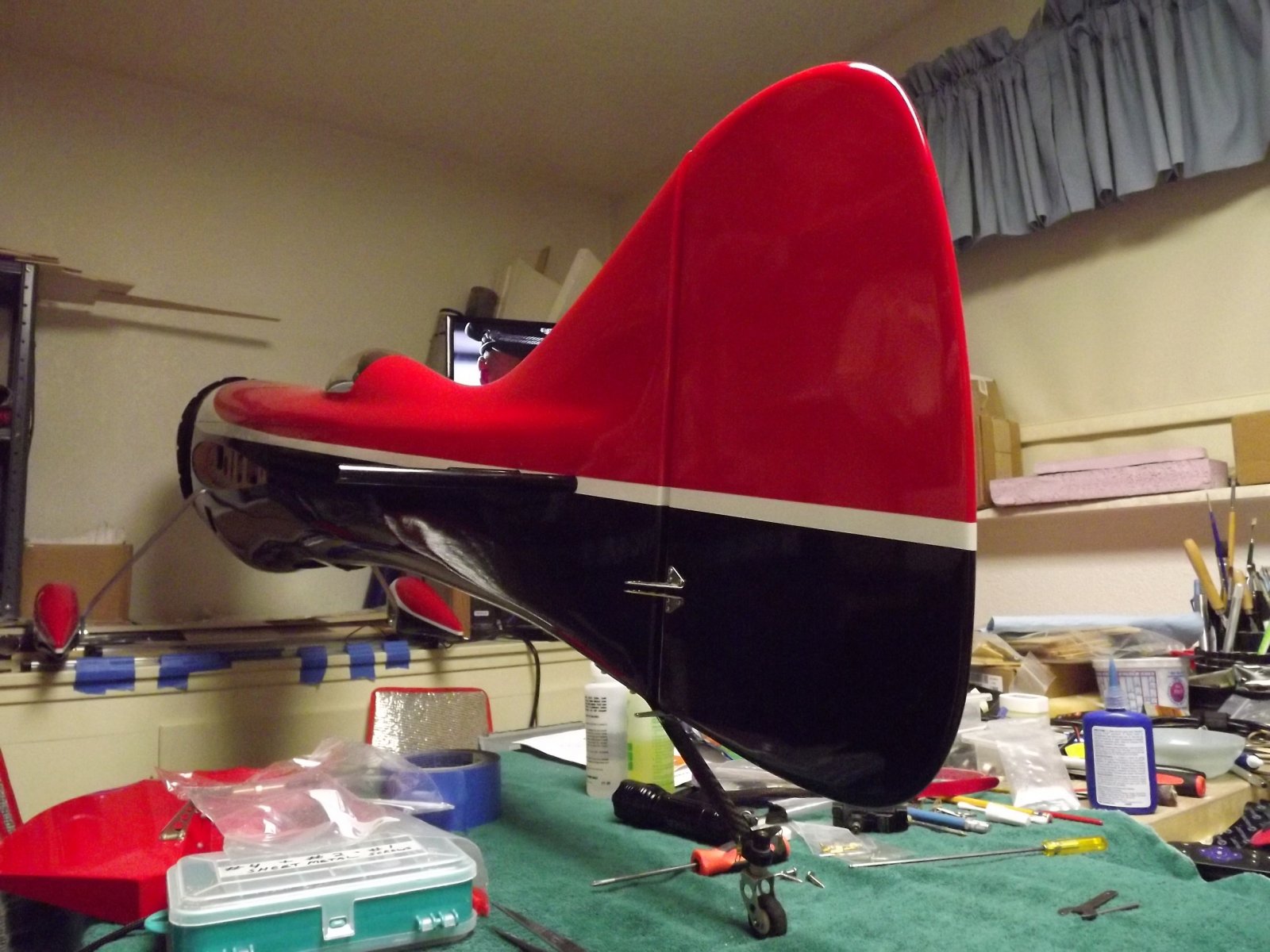

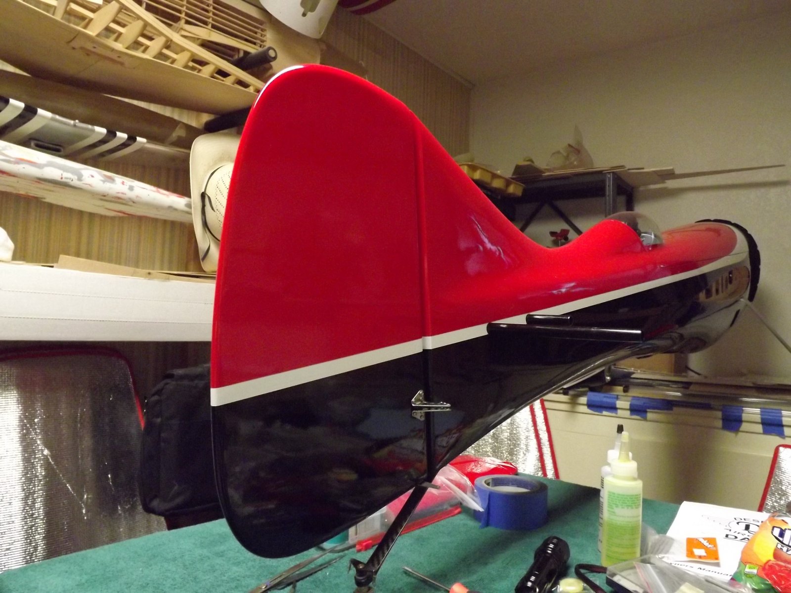

I closed the shop and stayed home today because of "Icemageddon". I got the rudder hinges glued in along with installing the tail wheel for the last time and mounted the horns and the steering tiller. I wasted over an hour looking for the tiller.:mad:
I apologize for the bad pictures Ive been posting. I just can't take a good picture here in my workshop. I even used my best camera for these and they look as bad as my cell phone pics I usually take.:(
