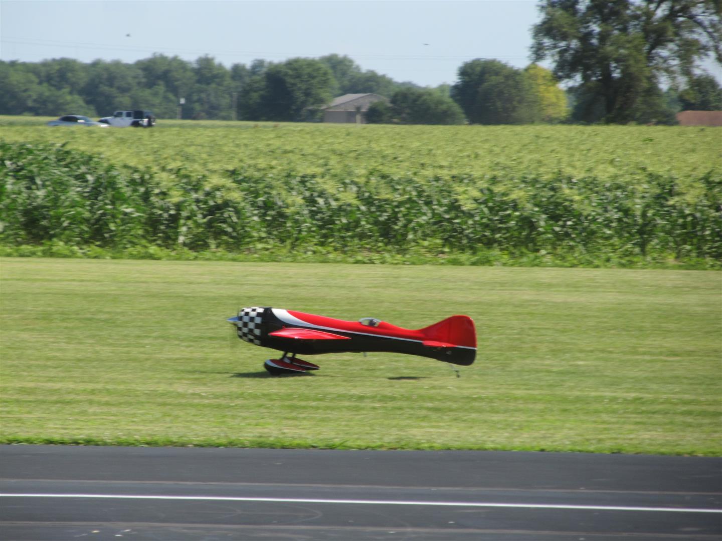

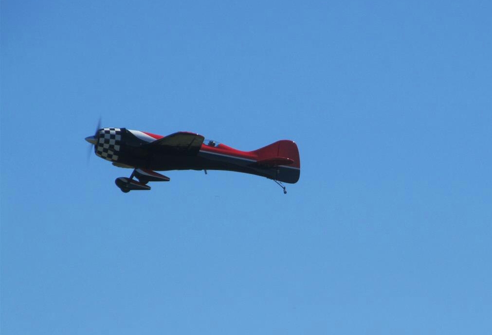

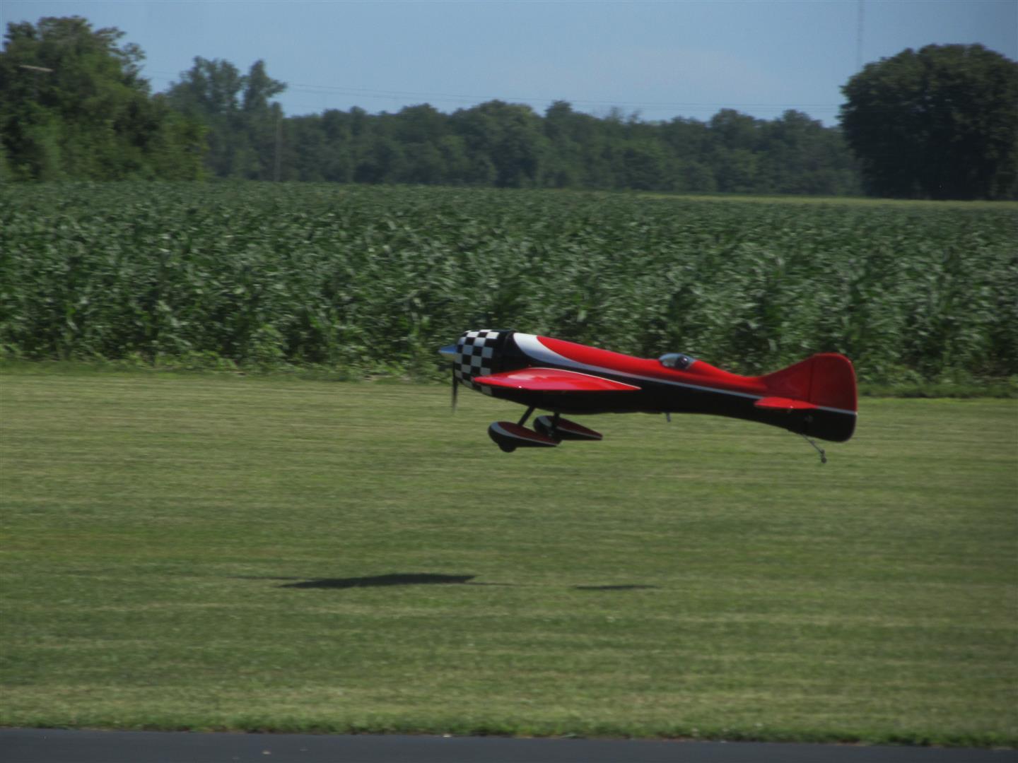

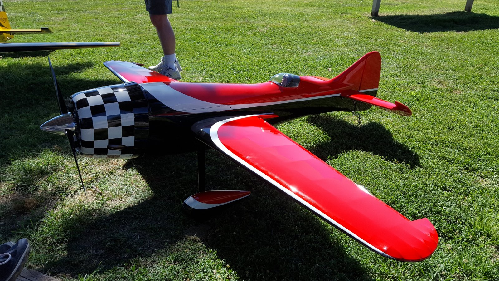

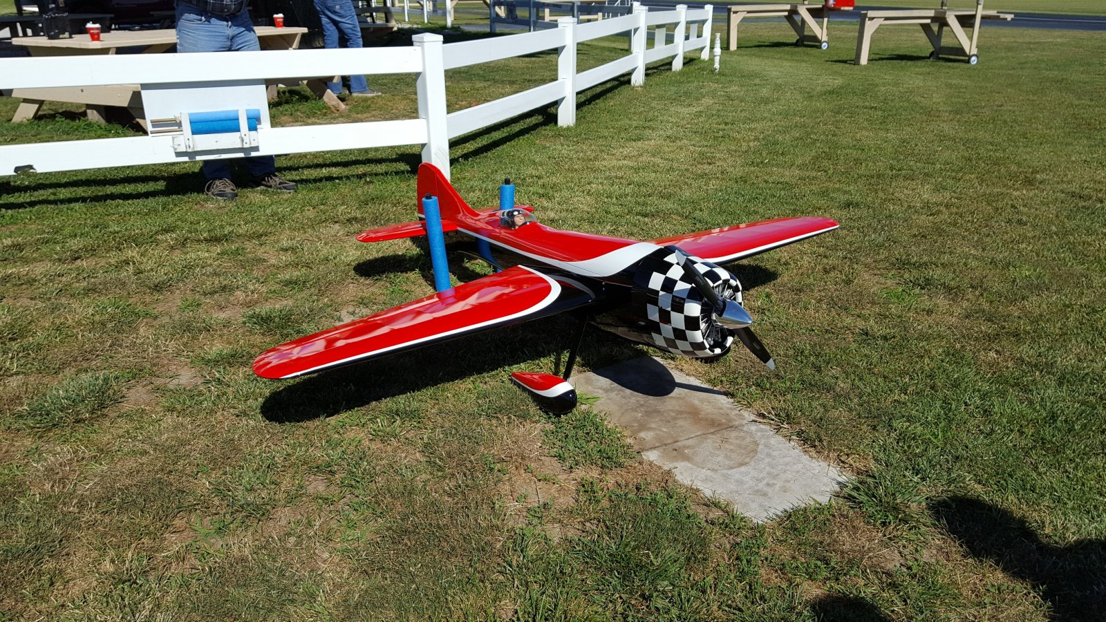

I have no video, but a friend did take some in flight pictures that he's going to email me, so I'll post them when I get them. Here is a before and after picture , I'm very happy that they look so much alike.
View attachment 97064 View attachment 97065
