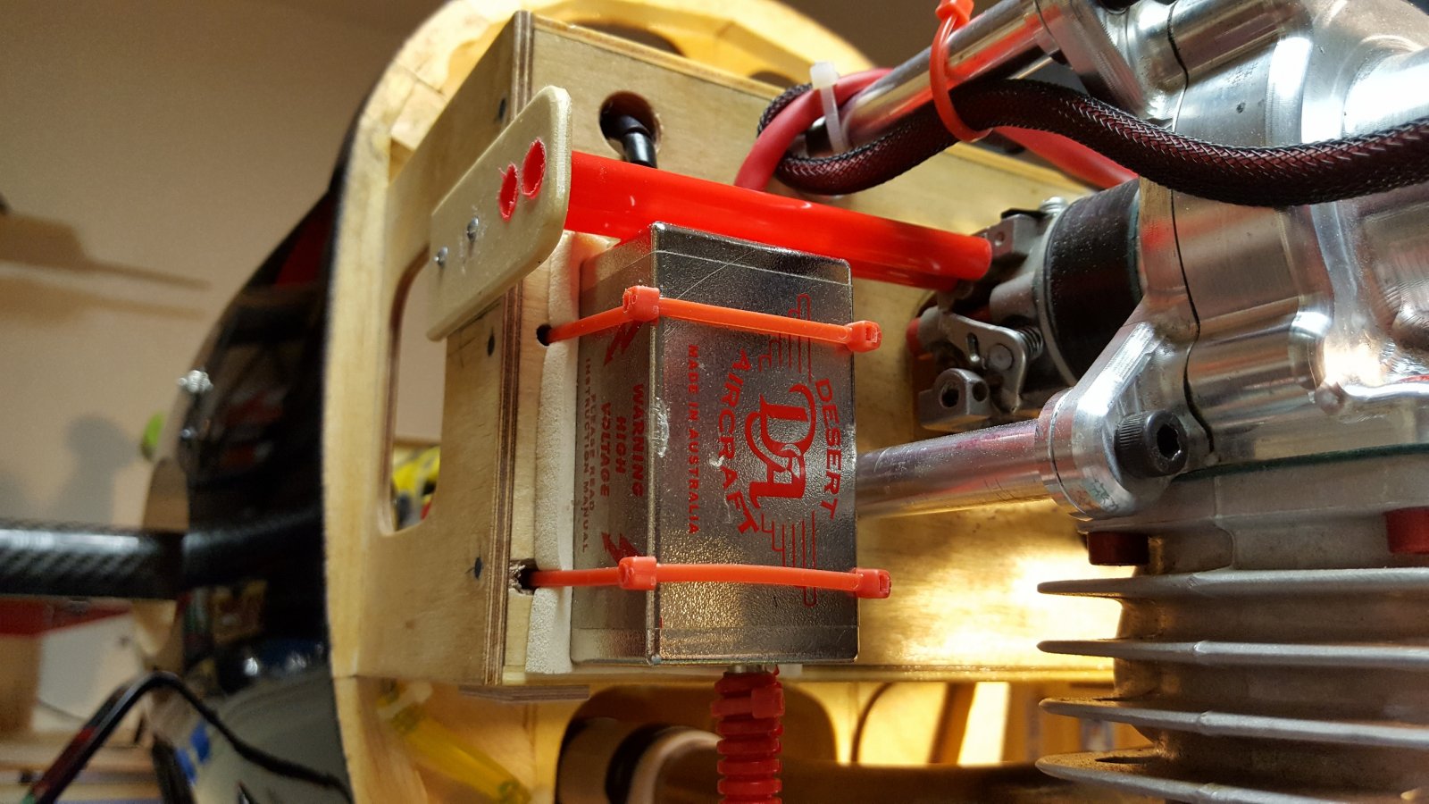

    Tonight I put Miss Moana back in the workshop and did a little tinkering. I added some straws to make it easier to tune and checked everything over.

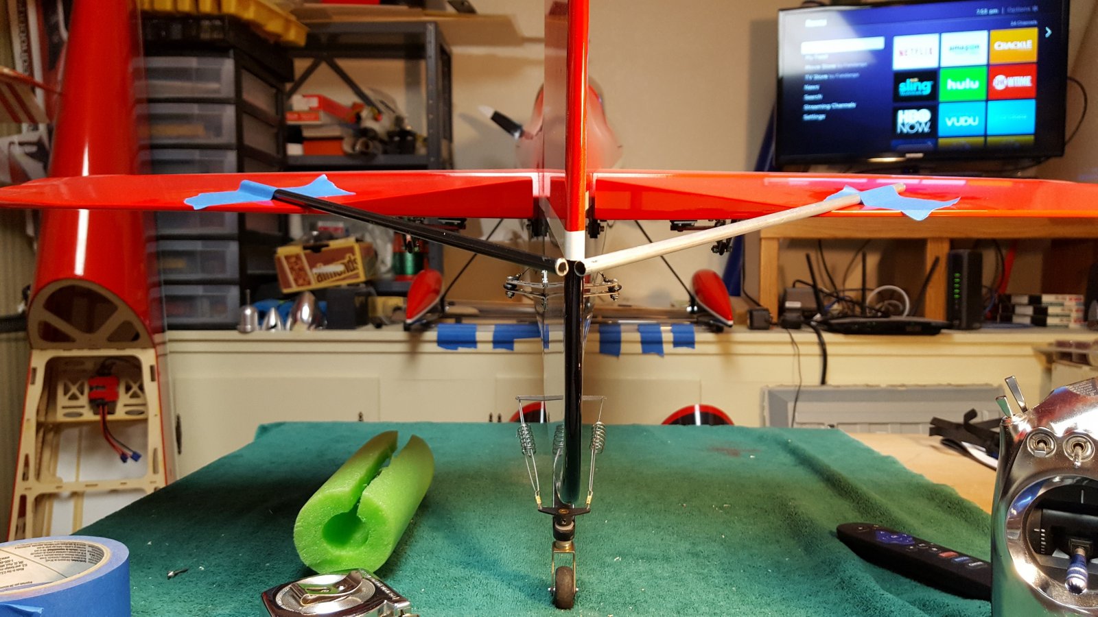

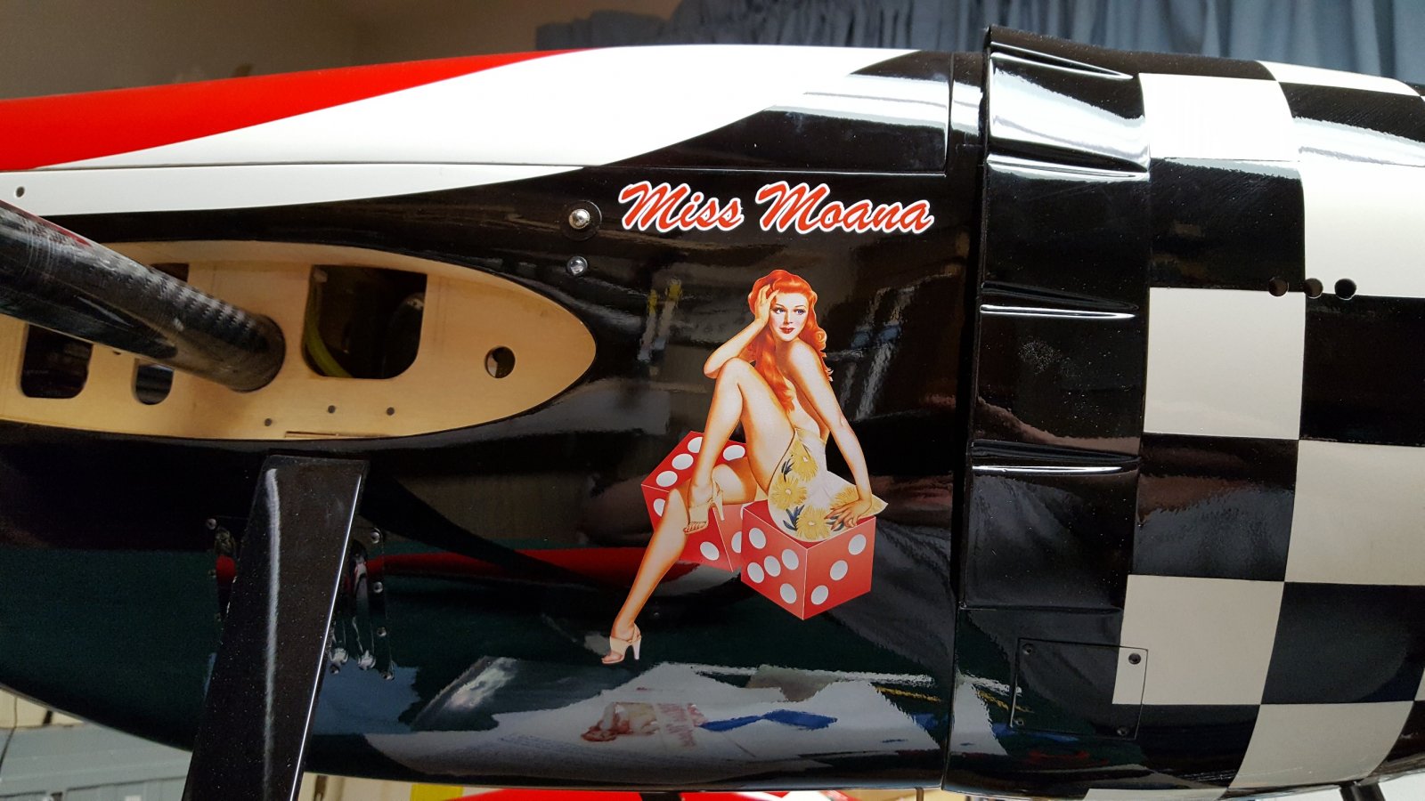

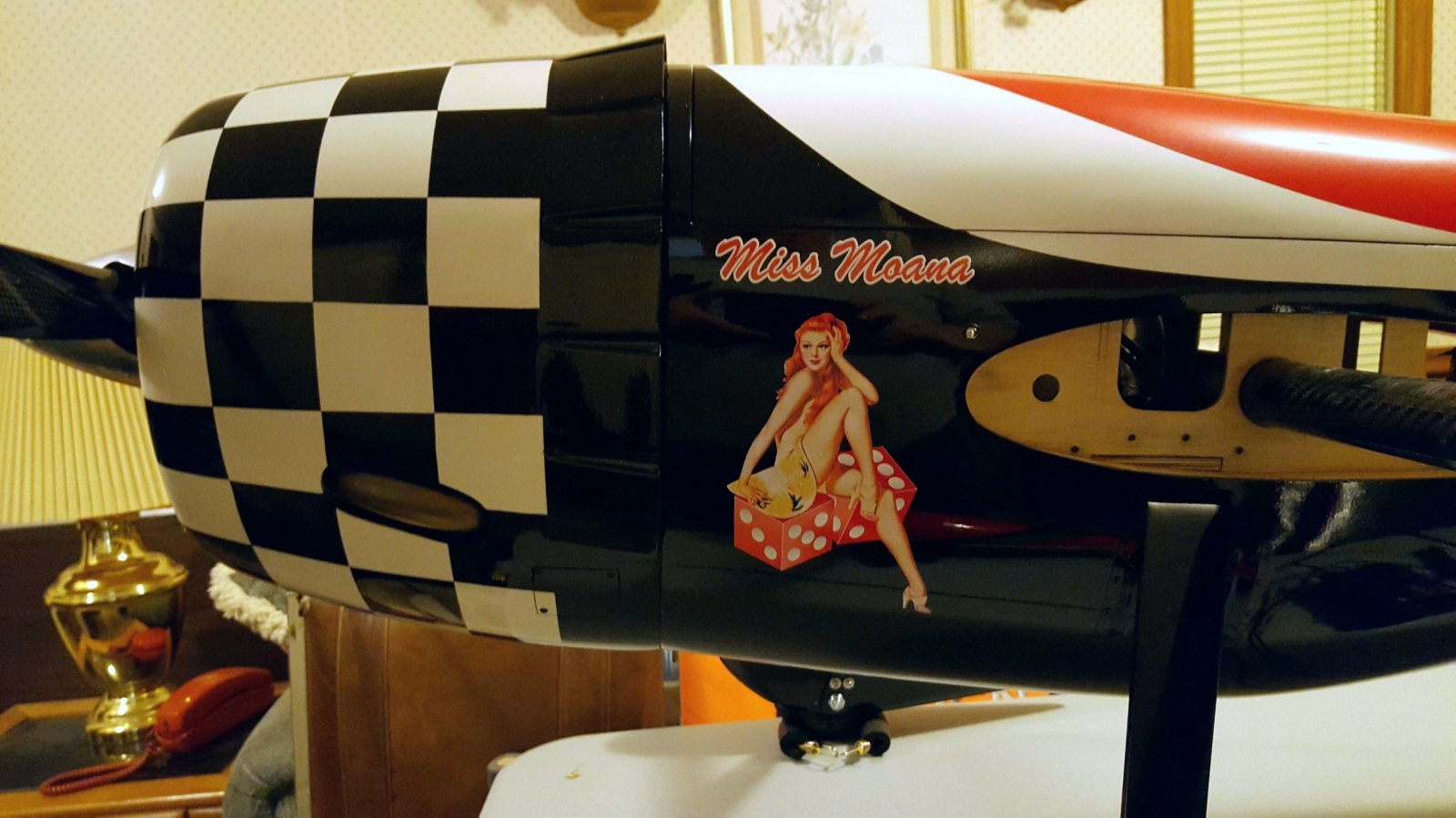

    Tonight I check to make sure the elevators traveled the same. I should have done this before, but I didn't. They were relatively even at neutral when I started, but the right one had more travel up and down. All better now.
    After fixing the elevators I installed my nose art. Miss Moana lives!

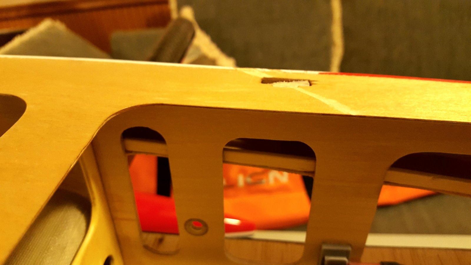

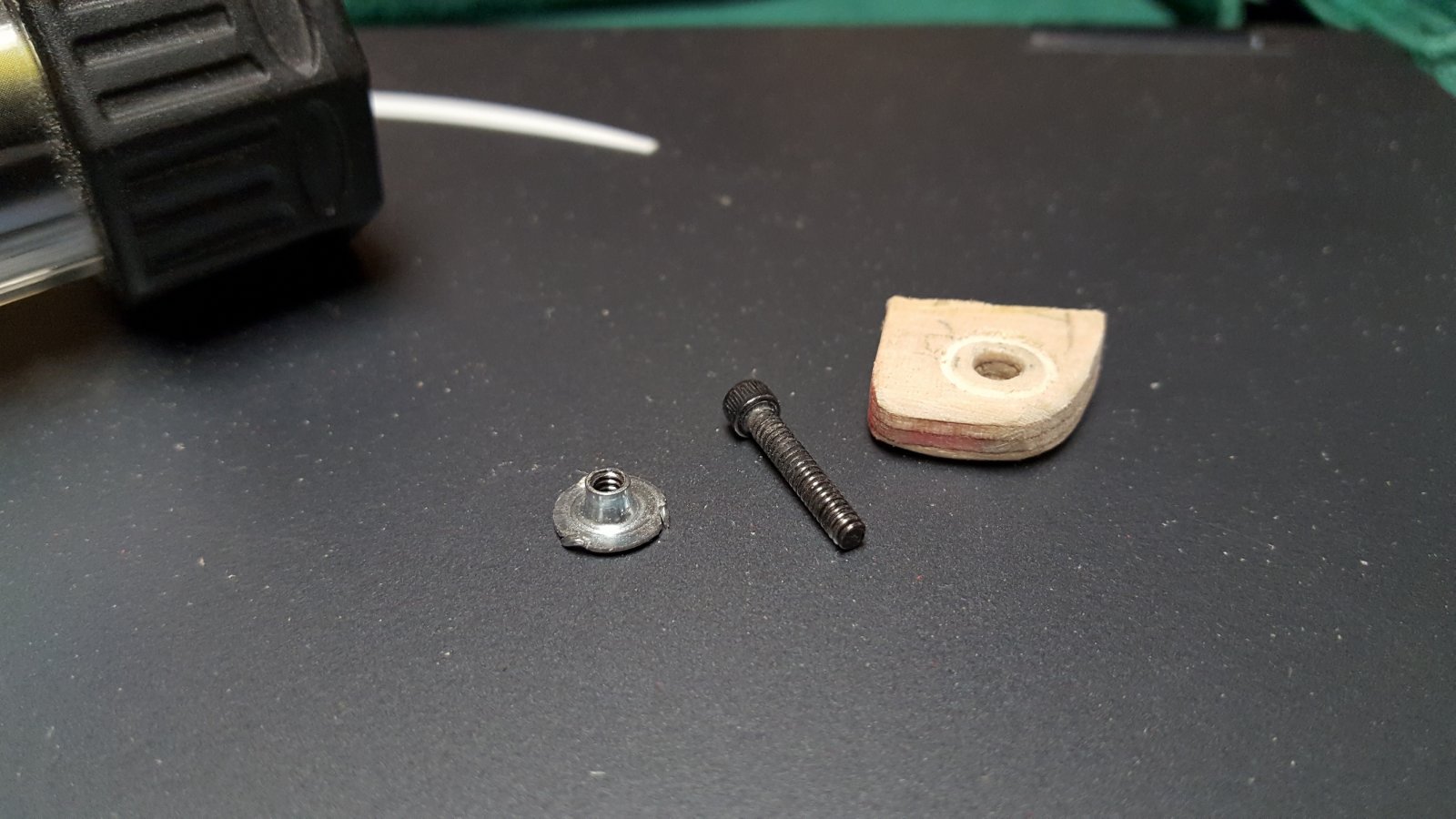

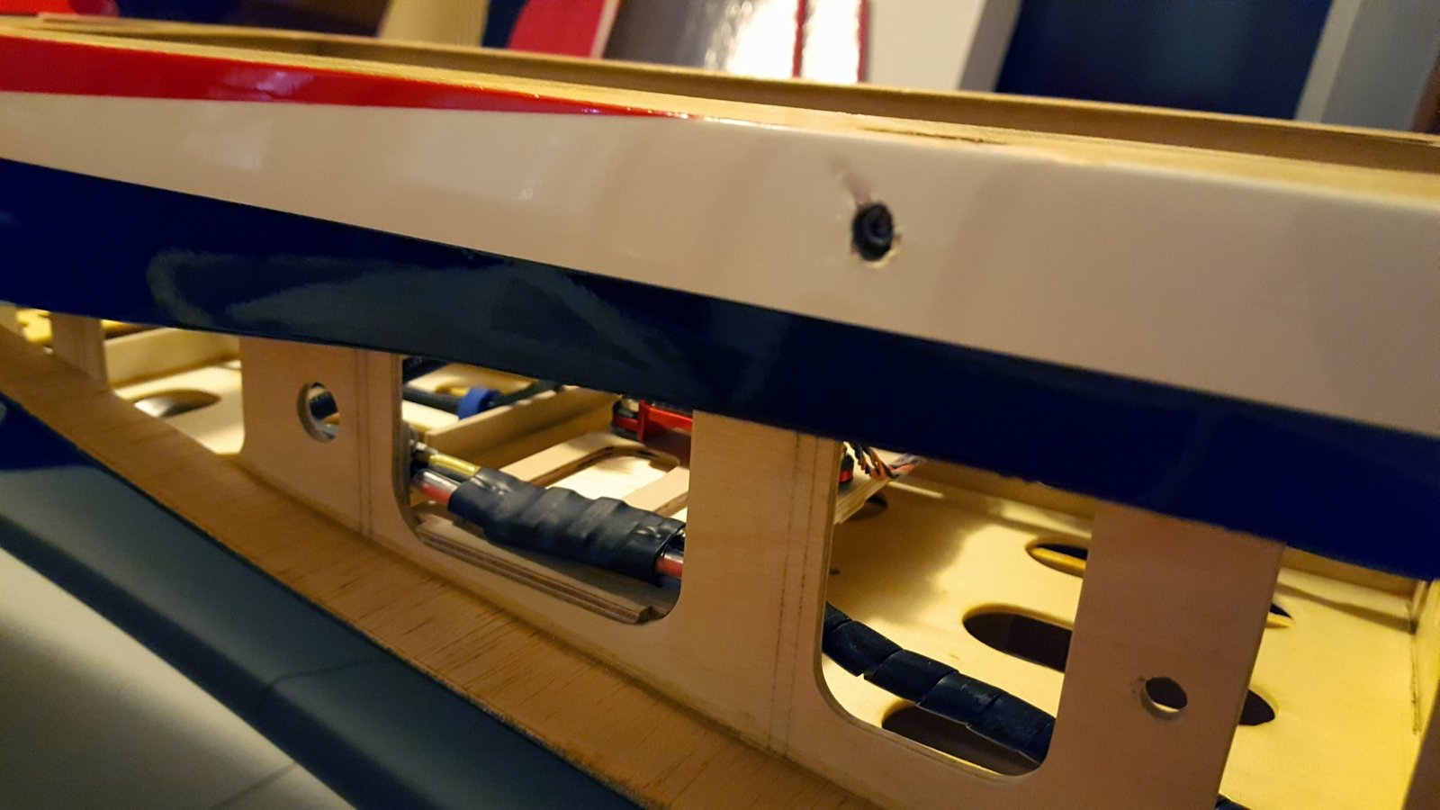

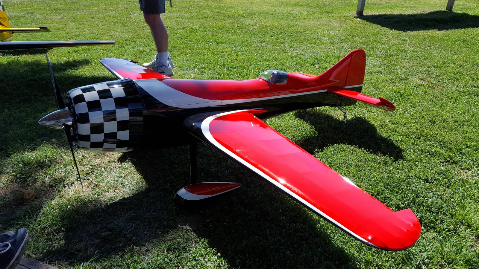

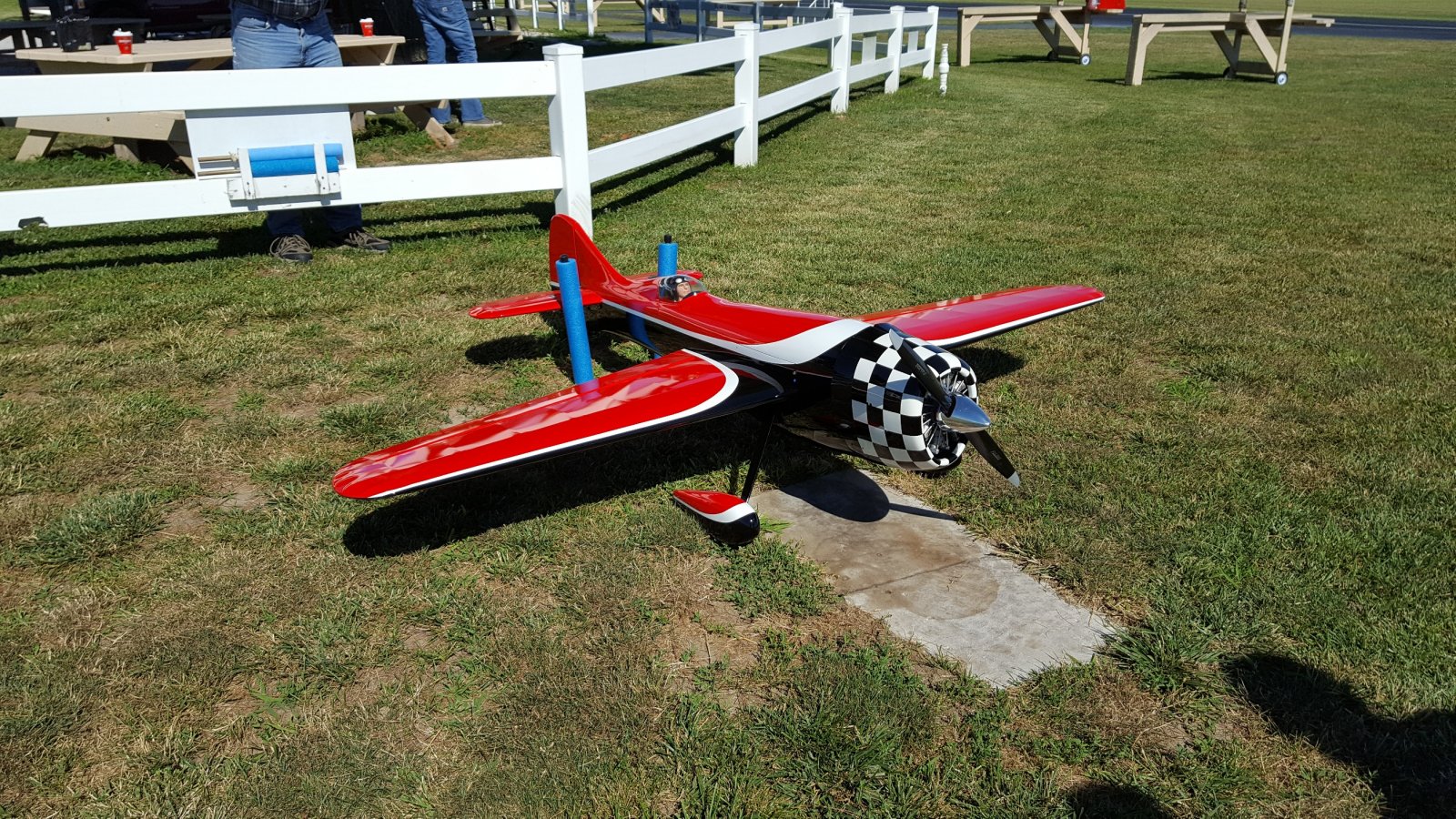

    20170702_164644_resized.jpg 20170702_164407_resized.jpg 20170702_164433_resized.jpg 20170702_170734_resized.jpg As some of you may know if you saw my post in the "I'm going out flying" thread I took Miss Moana out yesterday and it turned into a very frustrating day indeed. For those of you that didn't see that post the first flight went well, other than the engine being rich. I did test the CG in a 45 degree inverted climb and it is tail heavy. The frustrating part came after the flight when I went to pull the hatch off to let the pipe cool and check the fuel. On the third of four screws it turned several turns before I heard a "POP" and the screw went back into the hole. We worked on it for over an hour and couldn't get it out. I ended up borrowing a hack saw blade from a guy and I was able to get the hatch just high enough to cut off the tab and get the hatch off.
    When I got it home, I finally did get the screw out, but even with being able to get to the back side now that the hatch was off, it fought me the whole way. The threads on both the screw and the nut don't look bad, but they're definitely screwed up.
    Well I guess that's what I get for being an idiot and not epoxying them in.

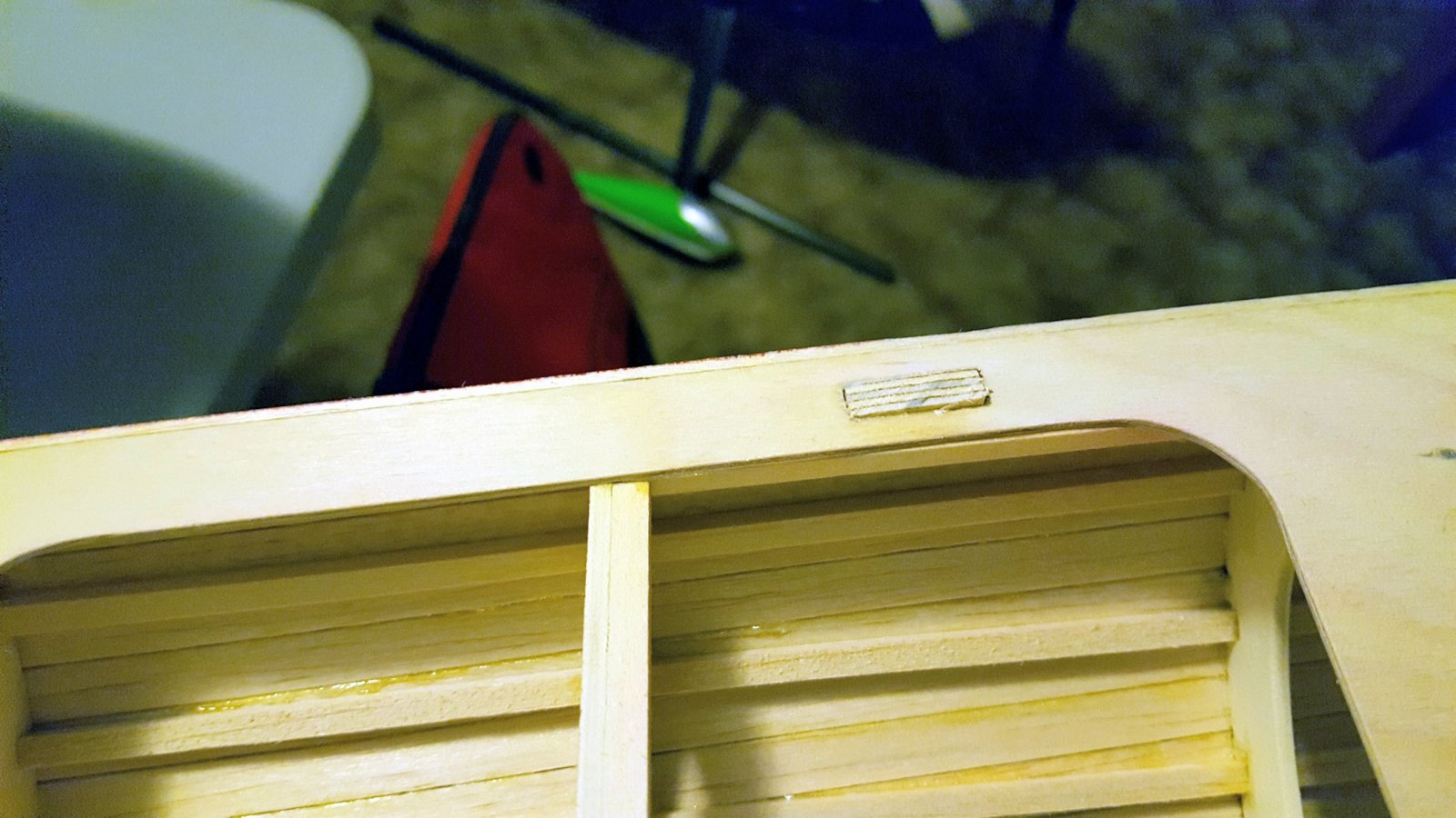

    Repairing the tab I had to saw off shouldn't be too hard, I'll Dremel out the leftover part in the hatch and make a new one. We did some damage to the outside trying to grab the bolt with pliers to put some pressure on the blind nut to get it out, with no luck. To get the hatch high enough to get the saw blade in there the bolt head also did it's own damage to the outside. None of it is that bad, just a pain.
