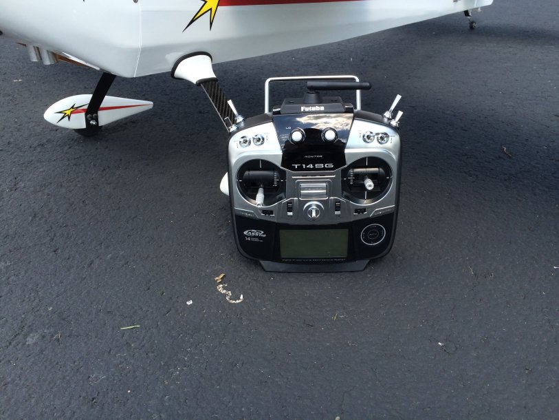

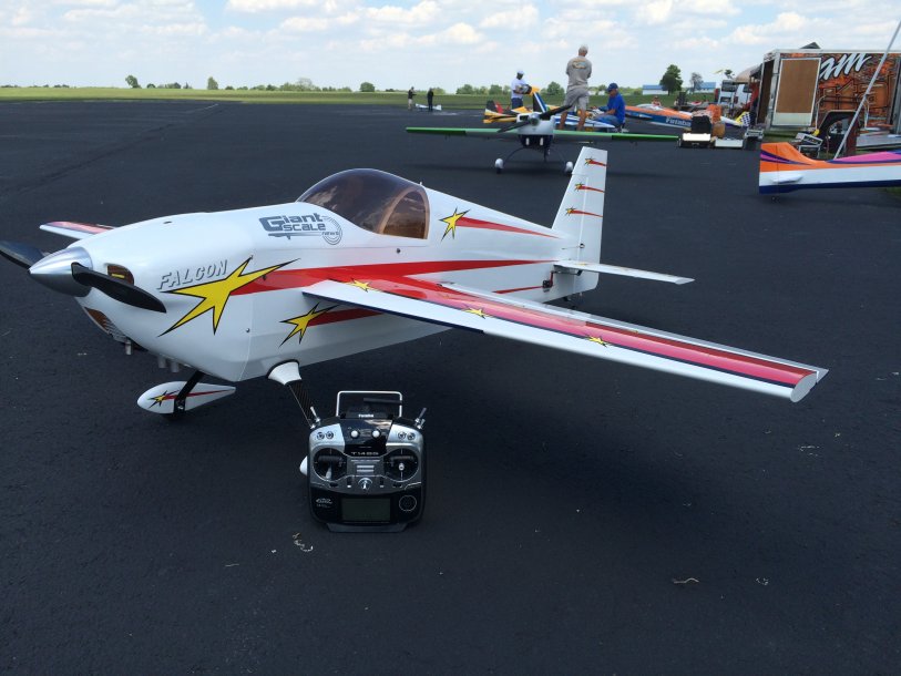

The Plan for the Laser was to fly it at Joe Nall after I picked up the new Cannopy... My Transmitter was acting up so that never happened. My Friend Dan Landis took it back with him to Hobbyco and got it fixed. New board and an antenna. They even tested it by flying with it for a day. Gave it back to me yesterday with a clean bill of health. Meanwhile I scored a new 14 SG. Now I have two transmitters that work. :)
Yesterday I was also invited to a fly in and Wedding Reception for Jenni and Greg Alderman. Had a great time all day... The only way I can describe the day was FUN. I managed to program and get 2 flights in with the Laser on the new transmitter. The first flight lasted about 6 minutes and ended in a dead stick landing. I found the plane to nose heavy and ended up moving the batteries back. The CG now is somewhere around the front half of the wing tube. This is where I like it. I'm going to mount it permanently when I get a chance. The second flight with the new CG went to my liking and had a full flight without incident. I'll have to do some knife edge mixing the next time out. It's still not set up but it's getting close.
