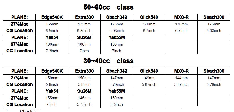

I forgot to mention..Alan from Aerobeez suggests a CG of 4.5 to 5 inches for first flights. The manual says 5.25inches, so I will have to recheck before I take her out, as I believe I was 5.25 +ish.
I'm building the same plane but my manual says the CG should be at 5.79". Wonder why your manual says 5.25"? I will do as Alan suggests. Also, could you post the pics of the canopy screw mod you did? Thanks
Are you building the 300 or 342? I am almost certain my chart shows both.

Post #68 you mention the mod. I'm building the 342 which by the chart I uploaded is the same as the 300.
