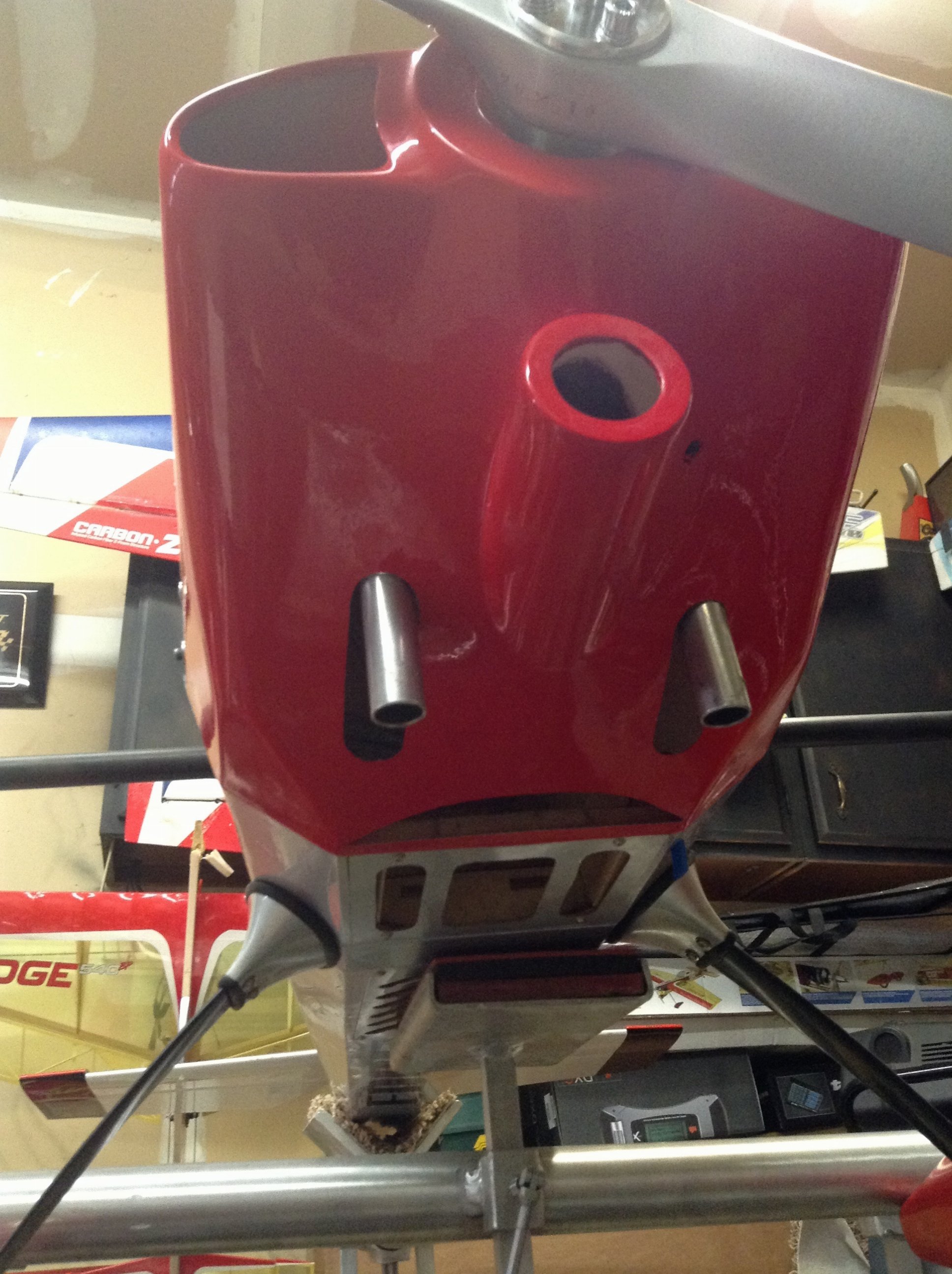

Got another flight in today and the cg is perfect. All my flights so far has been with the cowl off so I installed the cowl and after a minute the engine bogged down and shut off so I took the cowl off and no issues and then installed it again and it bogged to a shut down. I called vvrc and they said mite be a heat issue and I agree so I opened up the cowl holes and made a hole in the bottom of the cowl ,FYI VVRC has the best customer service I have ever seen . The plane was on the ground and wonder if it was in the air if this would happen but I am worried I will get a dead stick so I like to let it run on the ground till I see its running good.there is no room for baffles in the cowl but am thinking of installing louvres facing forward to grab more air. What do you guys think? image.jpg

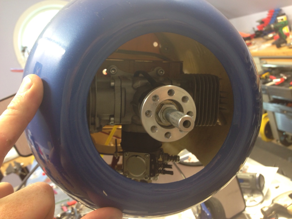

I think I have everything where it needs to be. CG is at 5 1/4. Now if only the weather would cooperate I could get out and get this 40cc fired-up. Not the best picture but here it is on the EZ-balancer:
Looks good rc feen. Let me know if you have any issues with heat when the cowl is on. I made some mods for air flow but is not tested yet. Good luck this weekend if maiden. Your gona love the way it flies.
So since I have the tunnel open will this be enough air-flow for the 40cc twin? I guess I'll see once I get the cowl cut and mounted but just thought I would ask. Thanks!
I don't have a heat issue with my 78 Extra install. I just opened up the last panel in the tunnel. Just flew it hard for 3 flights yesterday, granted it was only 50 degrees.
The pilot Yak 54 had just the bottom of the cowl opened up as I originally had it on a GT33.

I think you will need more exit air. I had a little issue with heat. I will post a pic of what i did later.
Chopper...yeah I saw where you opened a spot at the bottom of the cowl and then the two pannels on the bottom of the fues after the cowl were the tunnel is. I think I'll first cut some vents in the ply pannel I made so I could get to the throttle servo that is out-line below in blue:
