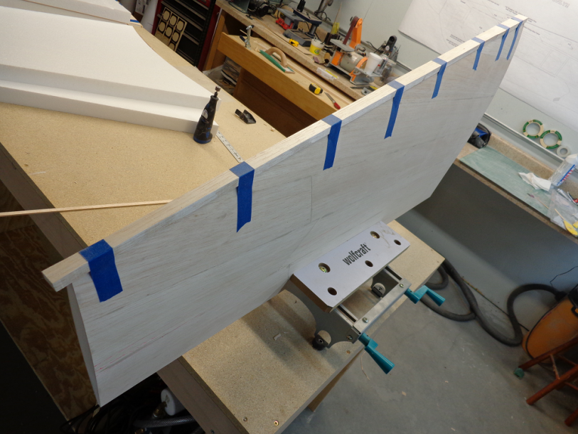

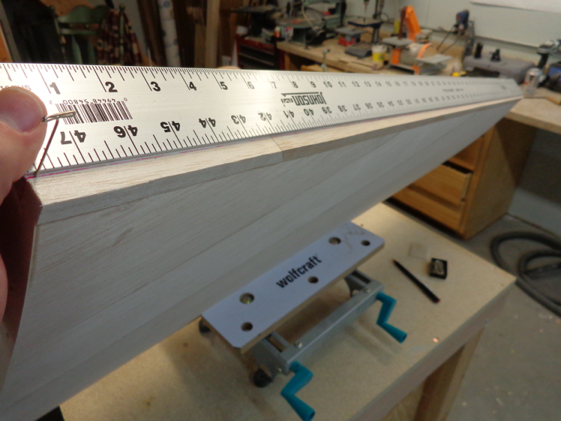

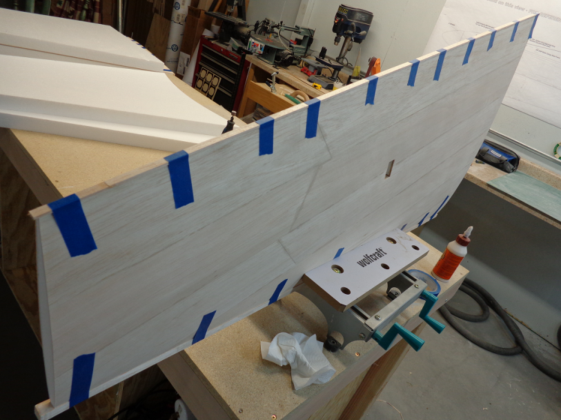

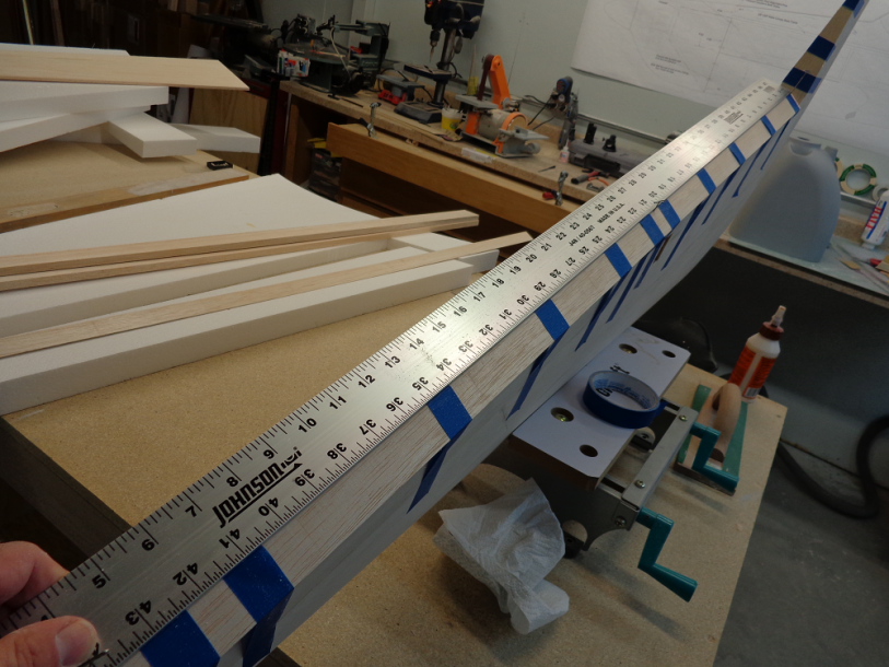

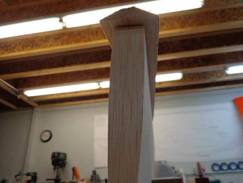

The wings got there LE and TE stock glue in place and shaved down. I like to mark the center point at each end and then stick a pin just below the mark. This allows me to hold the straight edge in correct position so I can draw the center line.

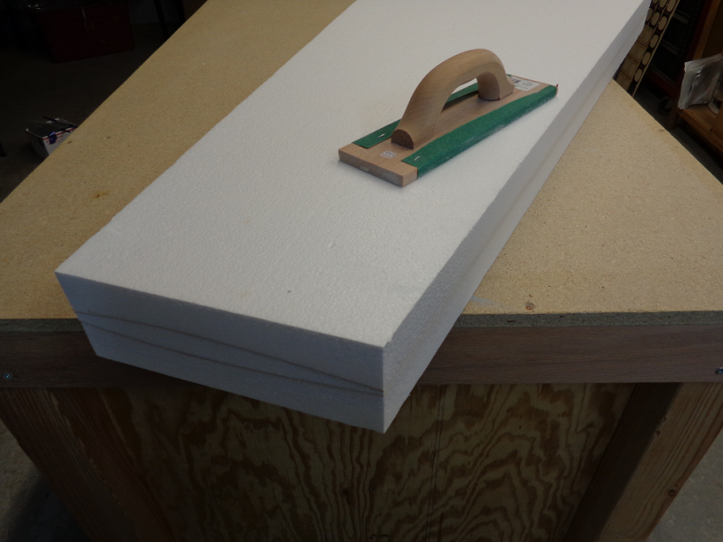

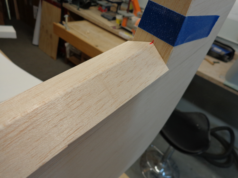

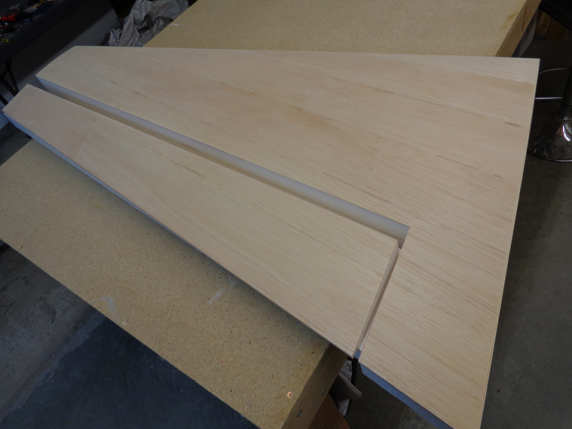

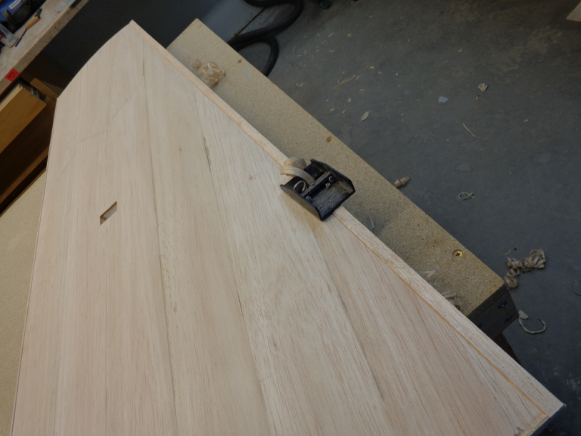

I used my 30 some year old razer plane to remove the jist of the wood and then do final shape with 80 grit then down to 150 and finish with 220.

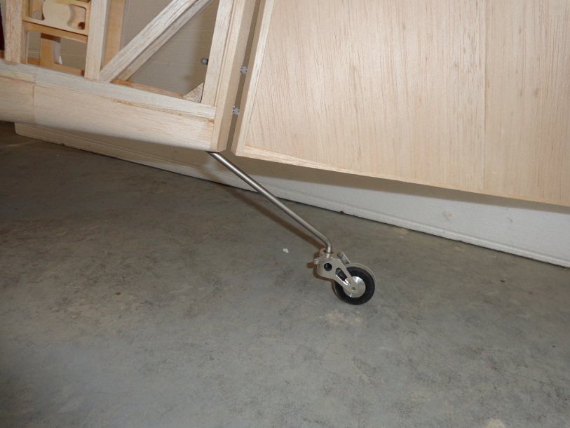

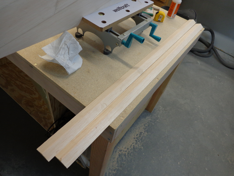

I got the tail wheel mounted and rest of fuse shaped around it. I just used some 1/2" balsa scrap and one to each side.
