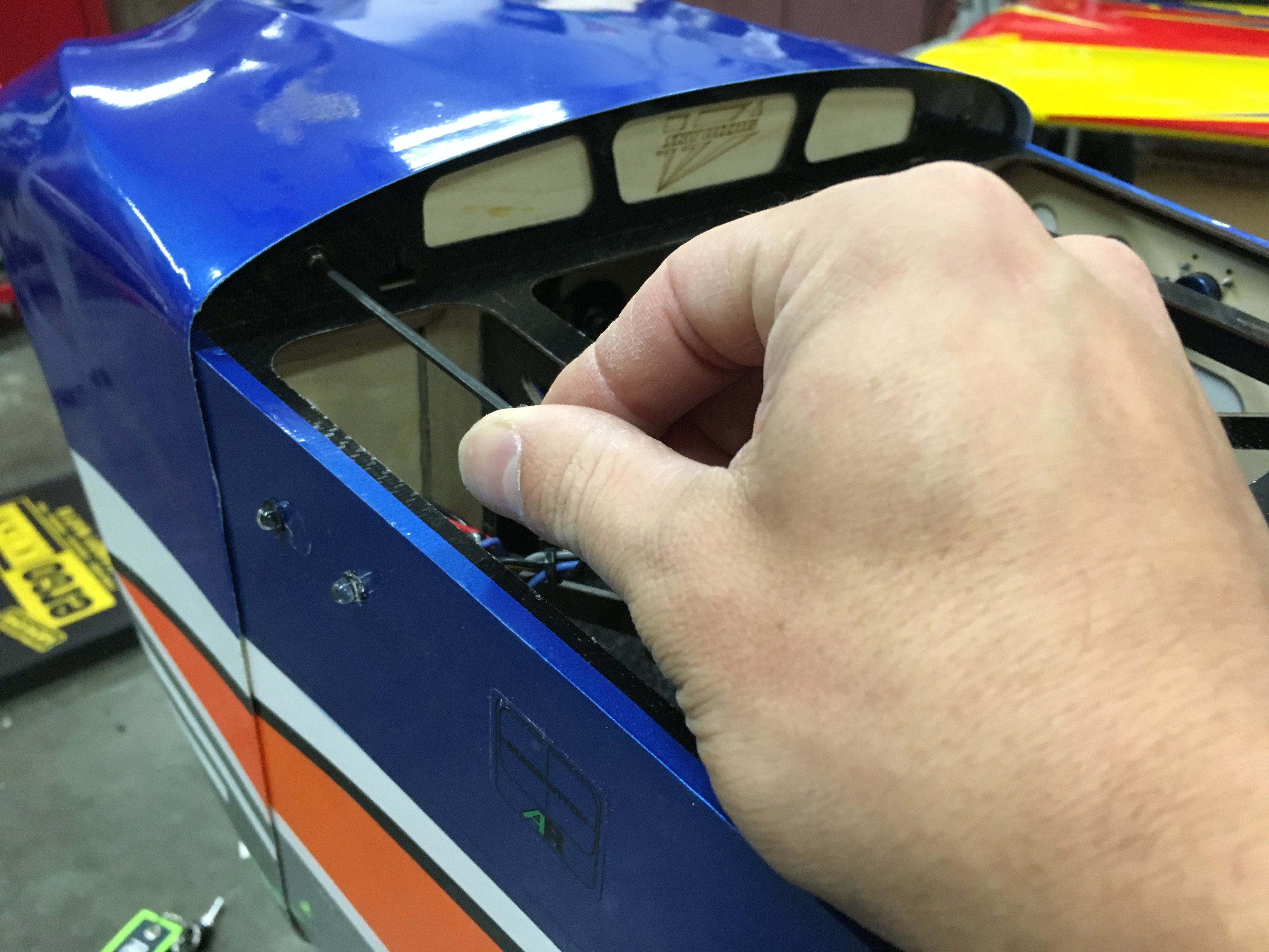

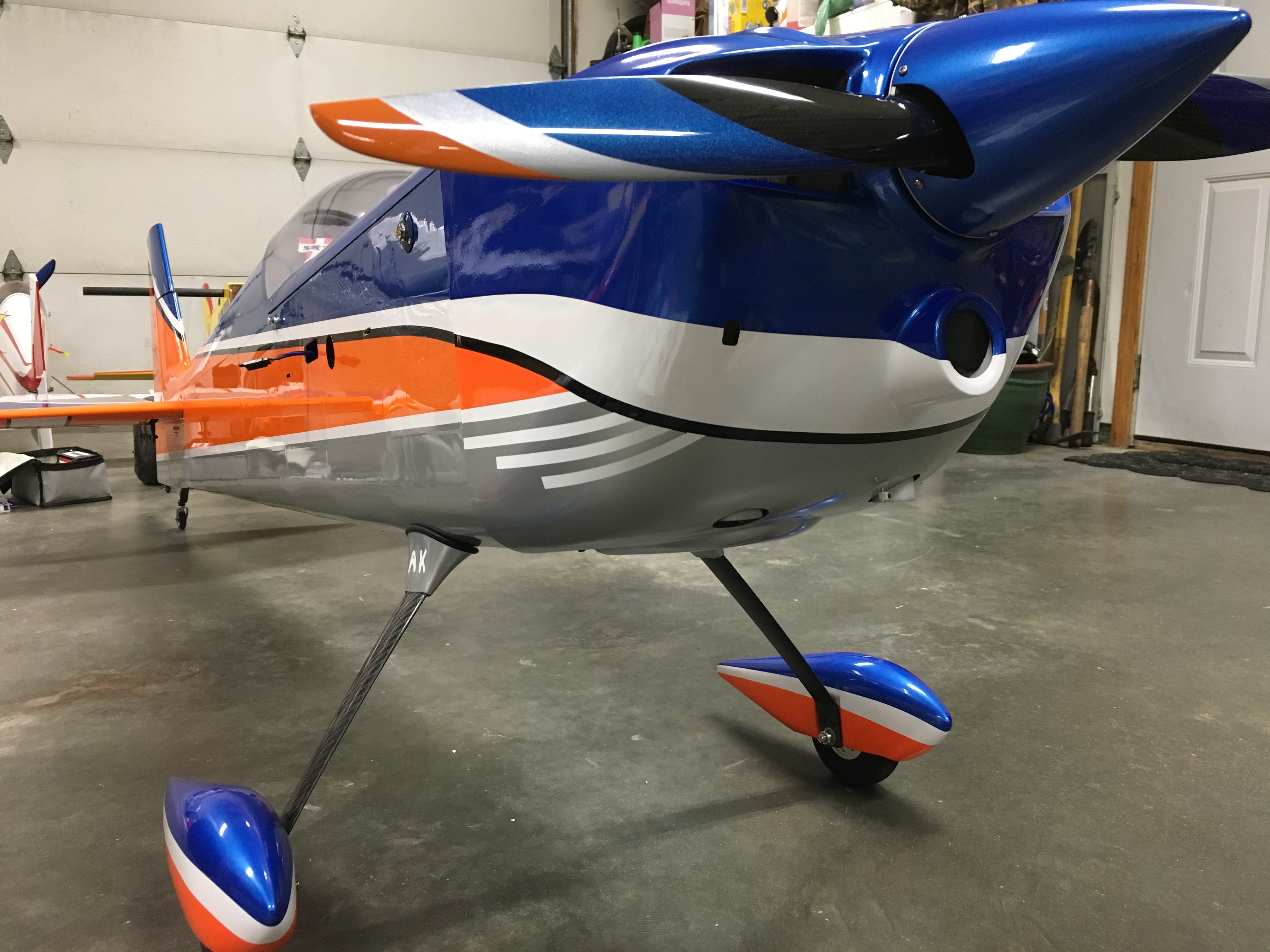

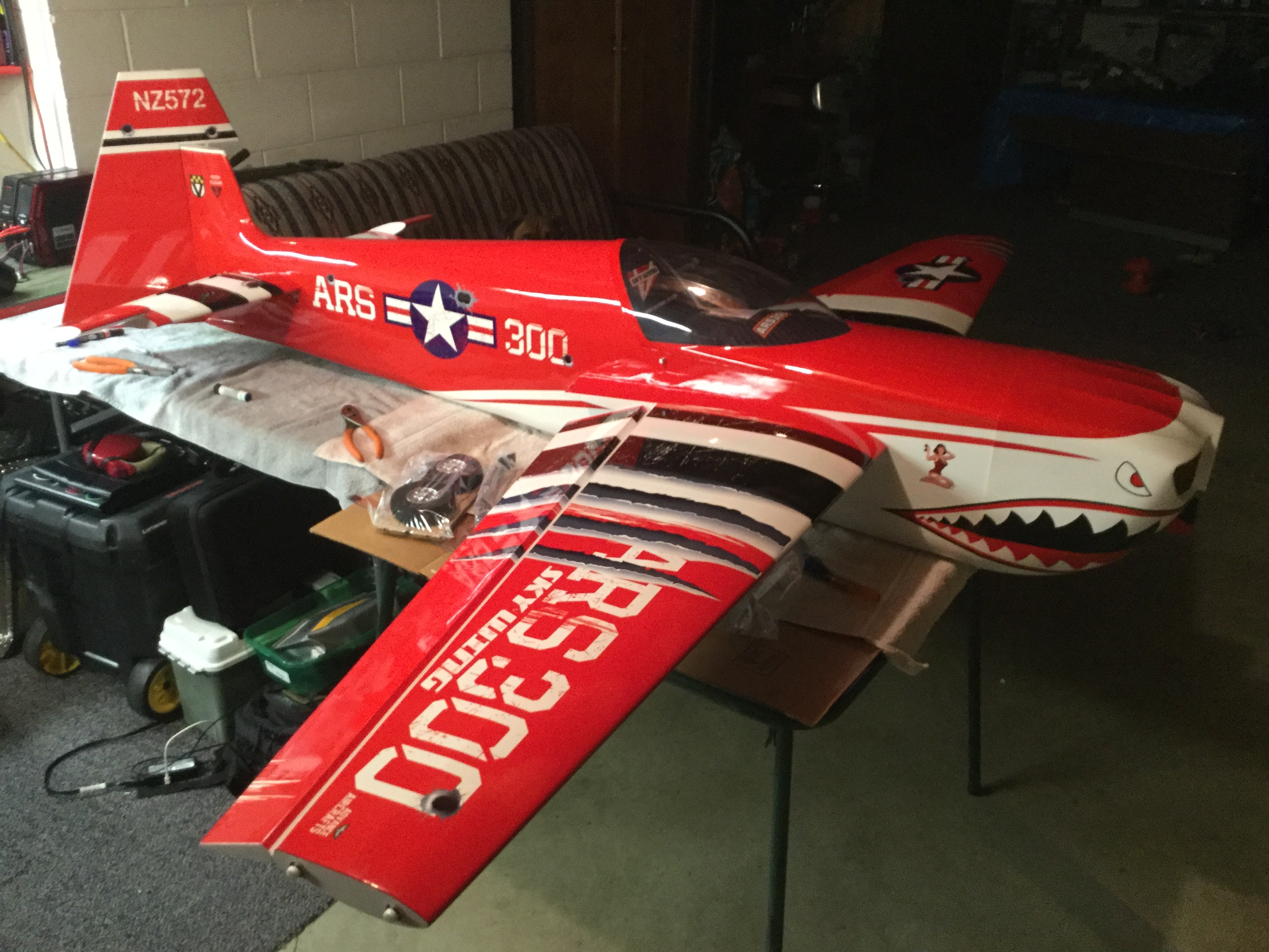

    Put the cowl and spinner on. Cowl is four Allen bolts, and the spinner is matched painted carbon. All included!
    You guys know what this means??
    I’m done. Just waiting on weather so I can run the engine a do a test flight. I will check my CG first though.

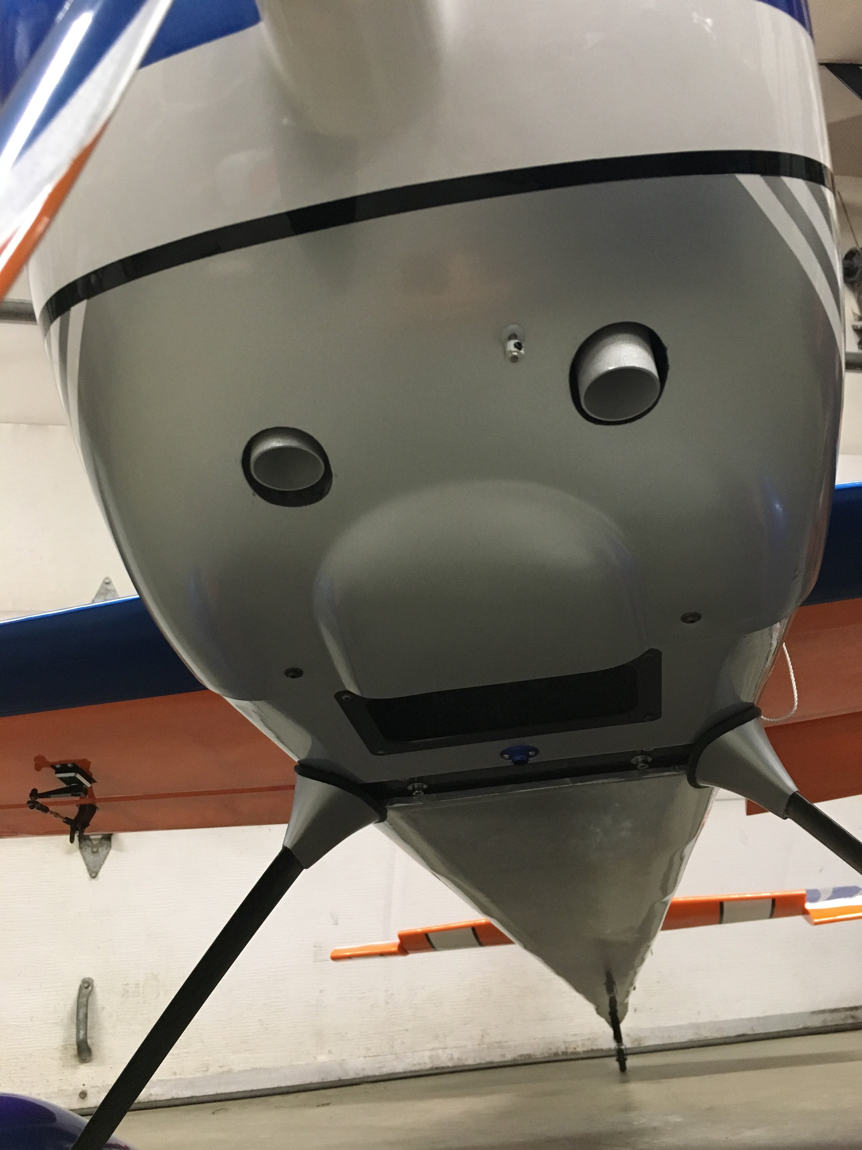

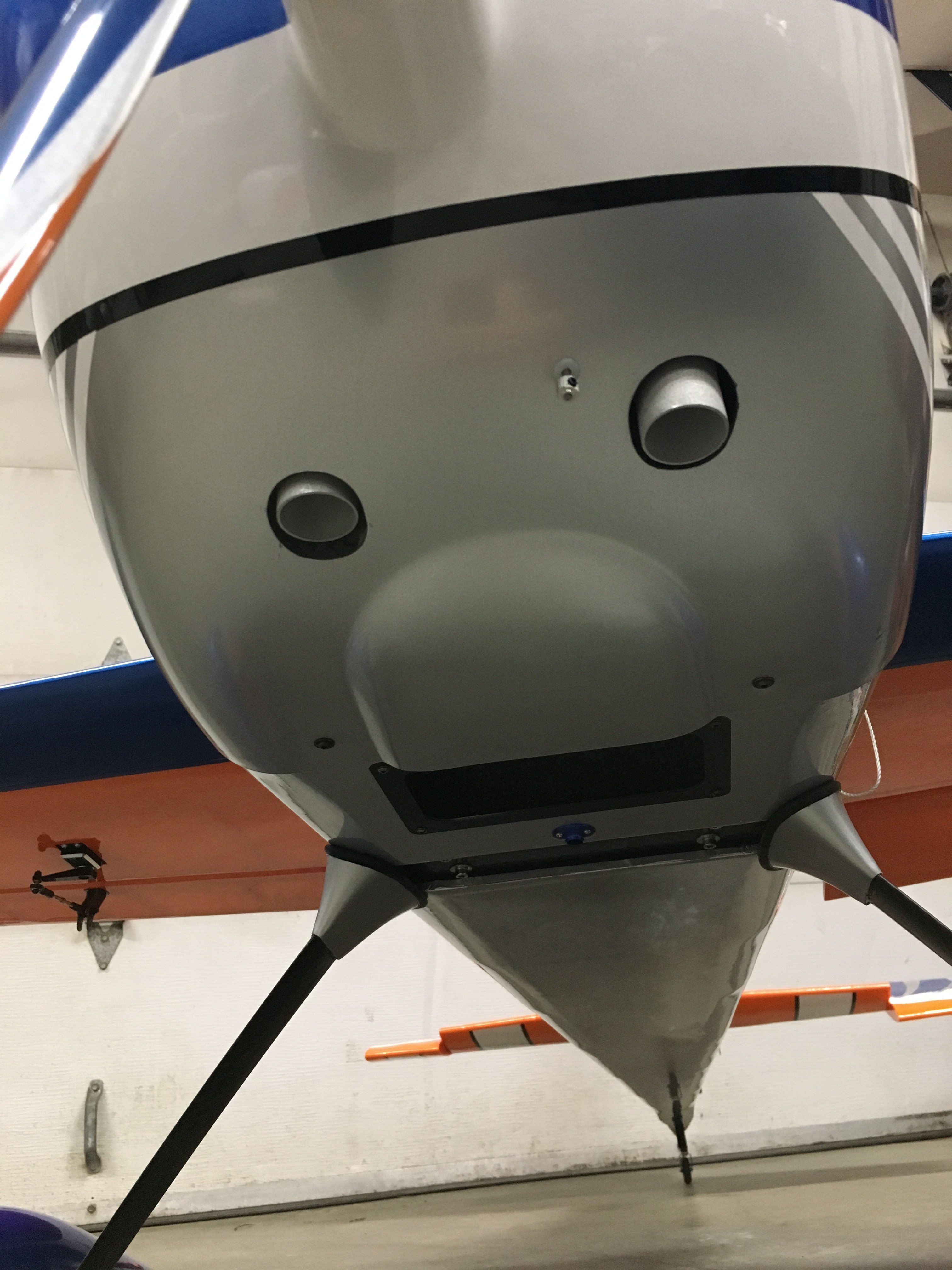

    Did you use any of the CF venting? Just starting my build. Plane is one bad mamma jamma.

    Nope! Just the one for the first opening in from of the tunnel where they made that neat air exit baffling.
    They even integrated an air dam into the cowling. Thought about opening up the air dam area in the cowl. But sometimes efficient airflow is better than a lot? With the strait muffs I don’t see the need to open up the aft fuselage.

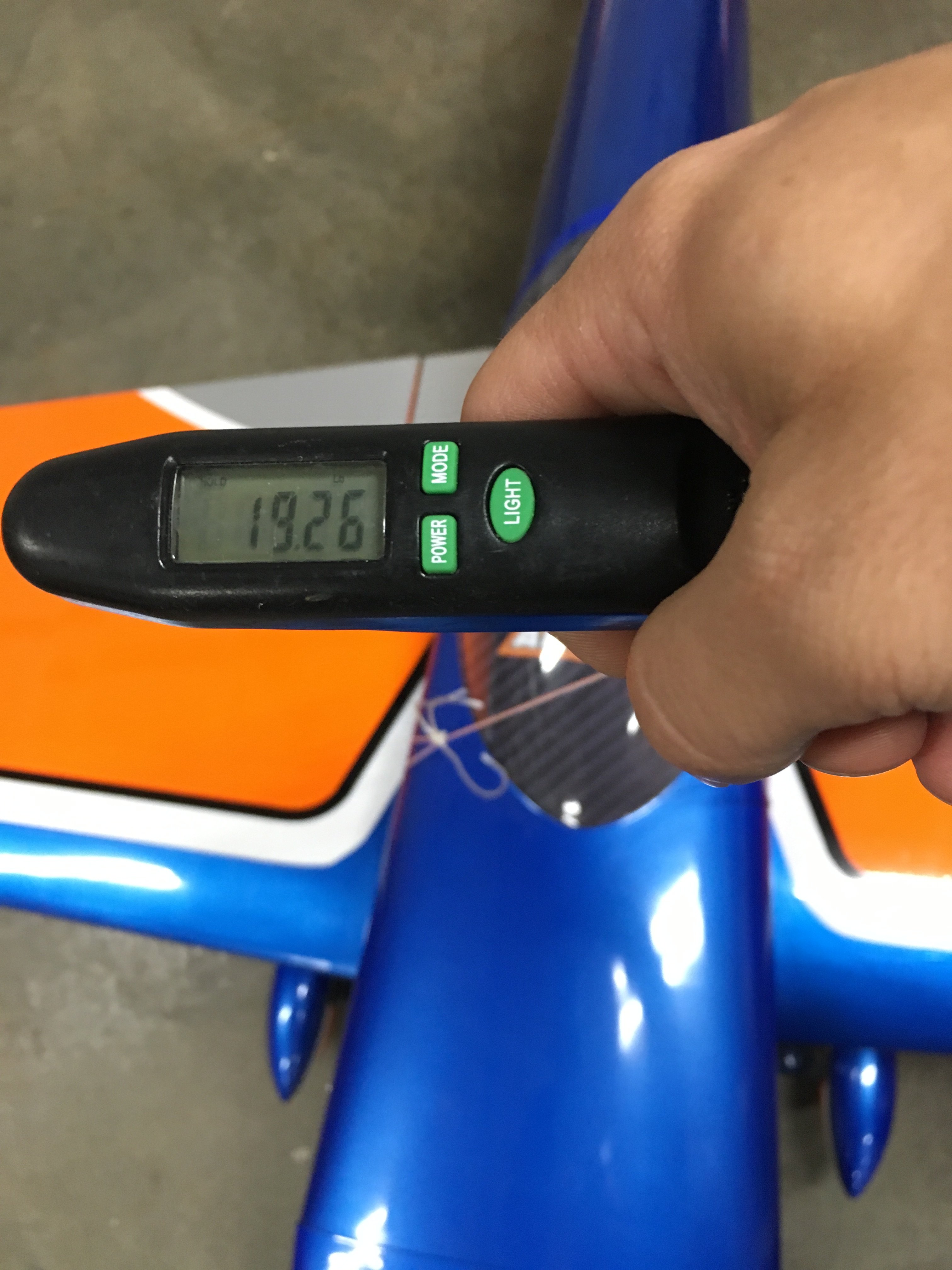

    Did a wingtube hang, empty. It weighs 19.3lbs level flight on the tube. 19.5 with two 2550 2S LiPos. Excellent for hanging a 76cc twin up front. Weighs 1.5 pounds less than my 110” timber with a 55cc LOL!!

    My thoughts exactly....with the air damn I don’t see much air going into the fuse. I thought about adding the small one just to dissipate some heat from the power source but I think I’ll wait and see how much heat is created in there. I think they were mainly included if you decided to use canisters.

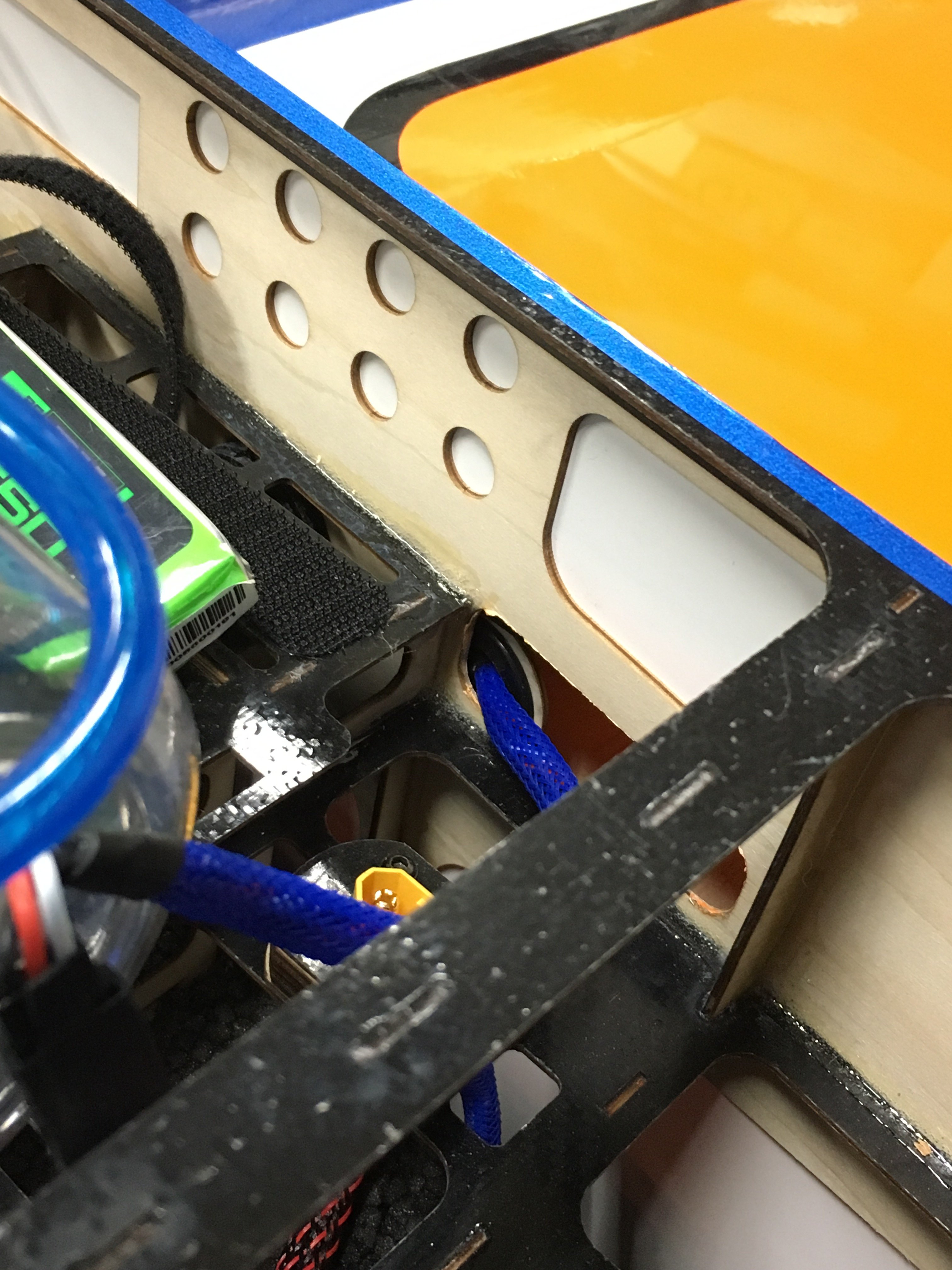

    I left the 22awg wires for the wings. 20Awg for the tail. Running brushless
    Which are pretty efficient too on the juice.
    I ran into this which confused me. The wing servo wire guides don’t line up the the opening much as all. So I will not use them. Only 1/4 of the grommet is showing.
