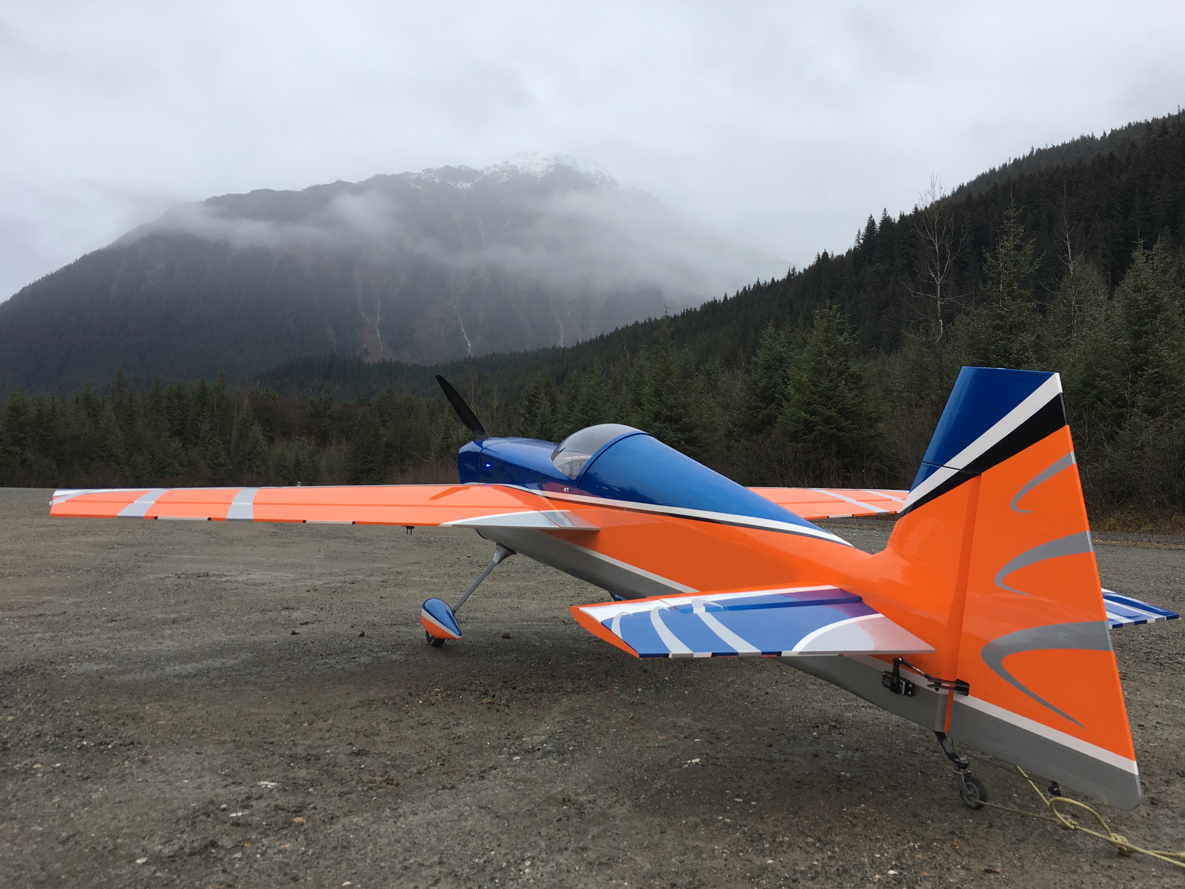

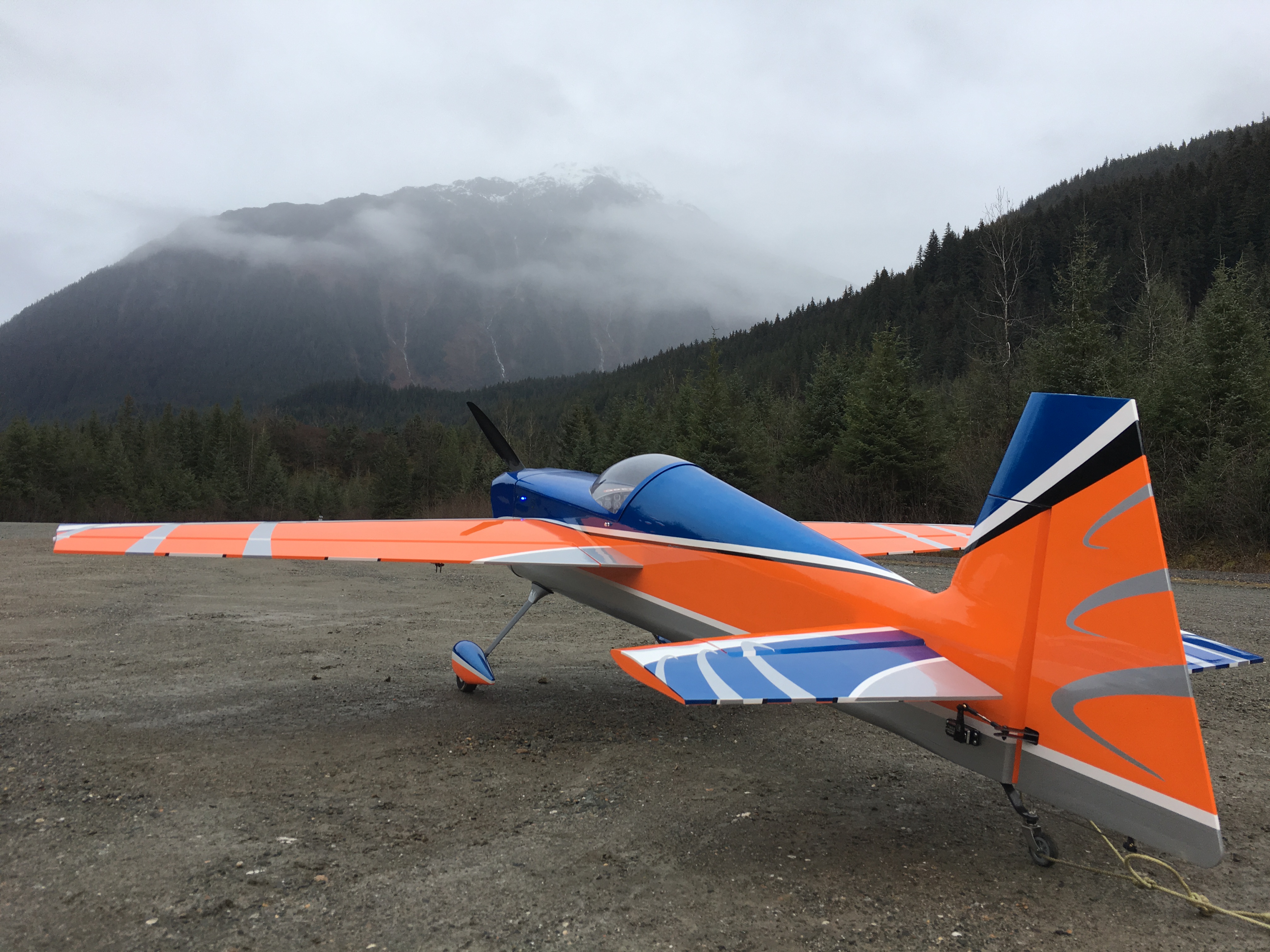

    Maiden Flight Video!!
    It was a bit dark and foggy out, but a video none the less!!

    Like that one, boy does that engine sound good and the low idle is rock solid. The plane looks like it will anything you ask of it. That a keeper. Nice flying.

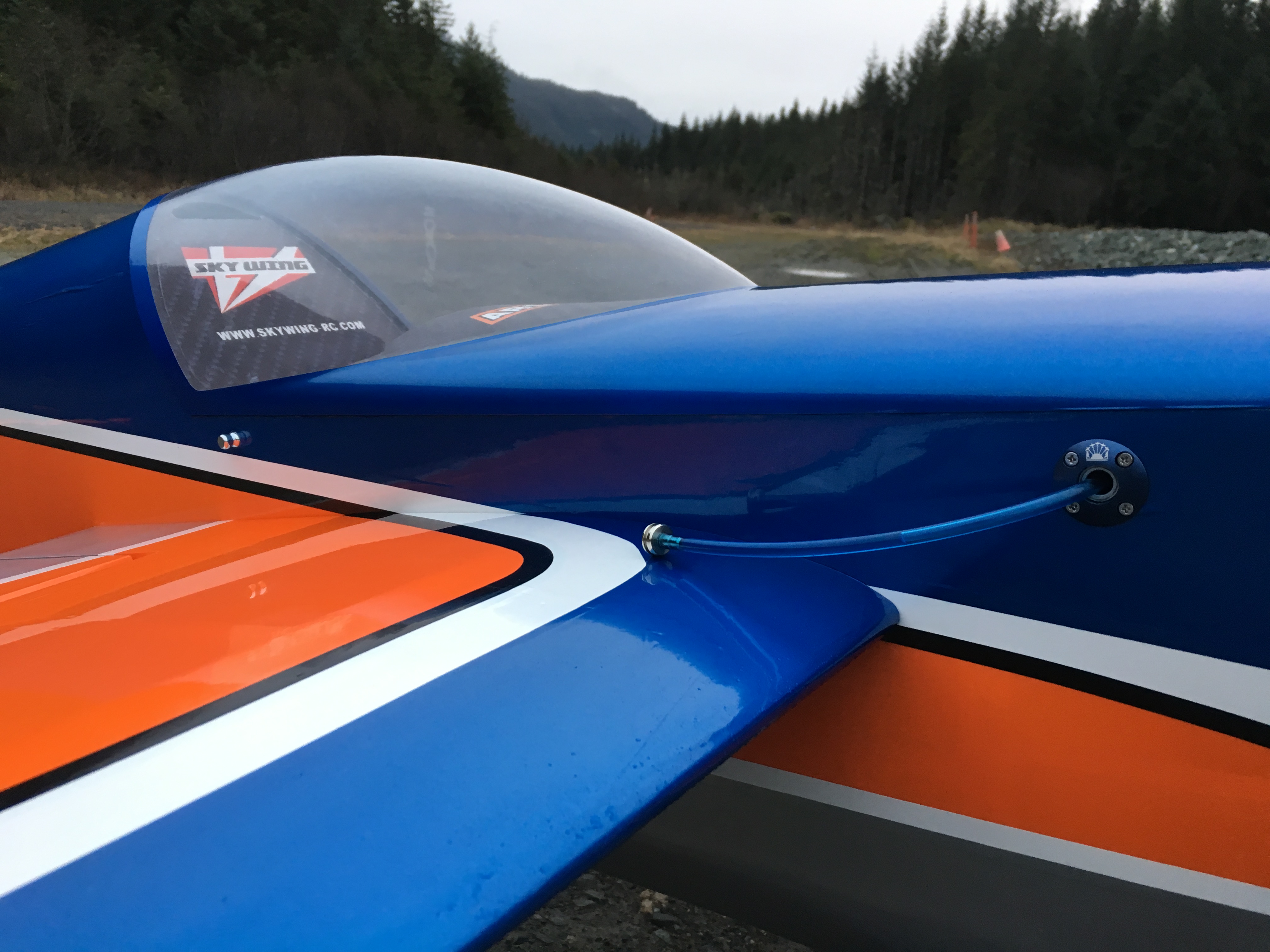

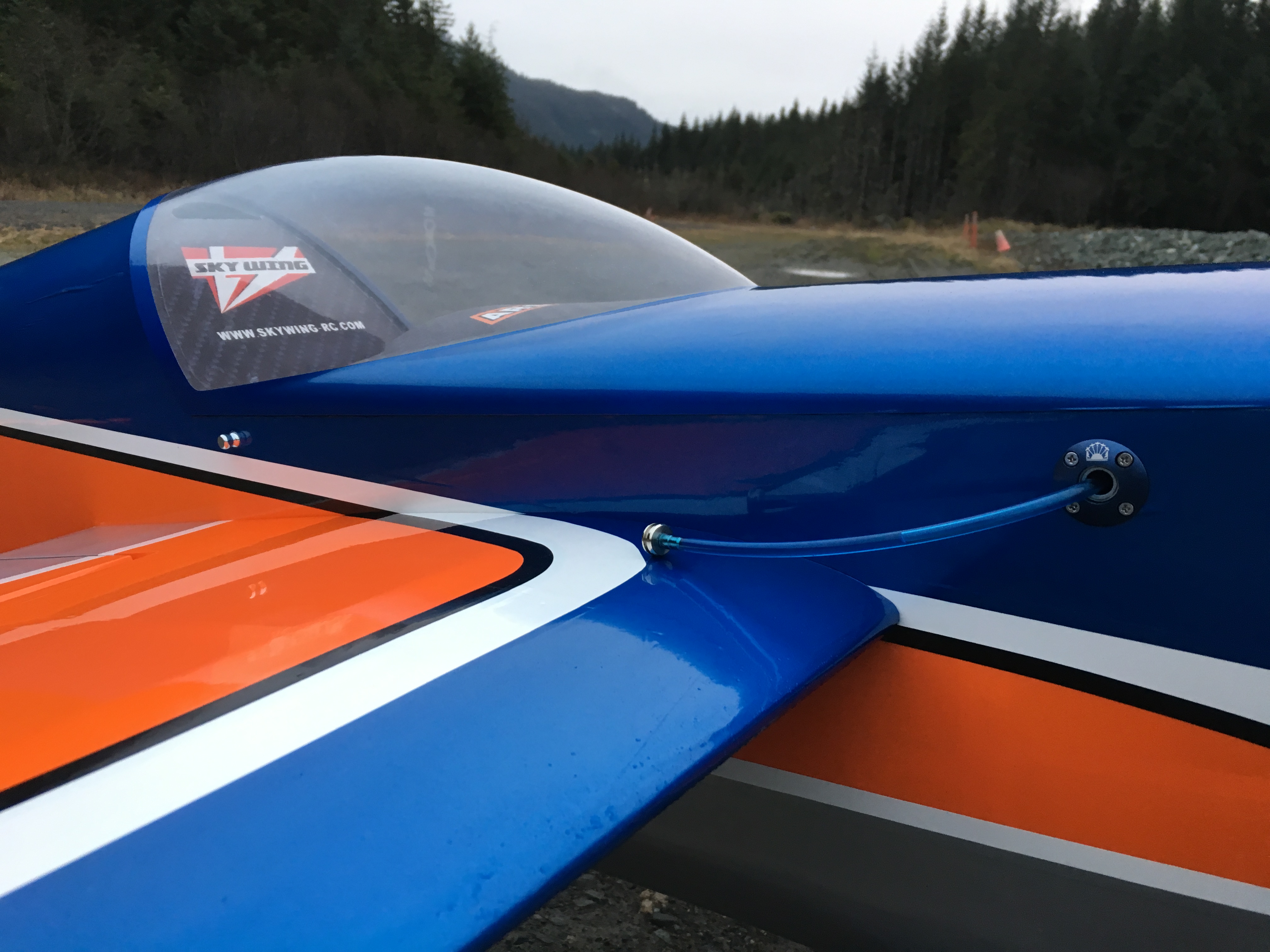

    Squeaked in a couple flights before the rain and darkness hit. Timer set to 14min now. Two flights brought both packs down to 60% capacity. I think 30min of flight time before a recharge sounds safe (2x 2550s). Haven’t had to adjust my rates. Plane flies great, might move the batteries aft.
    Apparently I was a little hard on the plane doing 3D turns, blenders, and pop tops because my fuel dot ejected.
    That poly line sticks so hard to the fuel dot, I may switch to Tygon to make it slip off easier, plus it may make a tighter connection within the receptacle.

    If I may suggest an easy fix. I have had a couple of fuel dot that were impossible to remove. So what I did is add a couple of inches of silicone fuel tube to the end it makes removing the fuel dot off and back on a lot easier. I know it does not last but I just change every couple of months and it works great.

    Not a bad idea. I’ve been sticking with tygon, just had a wild hair to use the matching blue line that came with the plane. The tygon is thicker too, which might help me here too.
