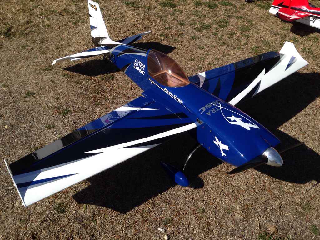

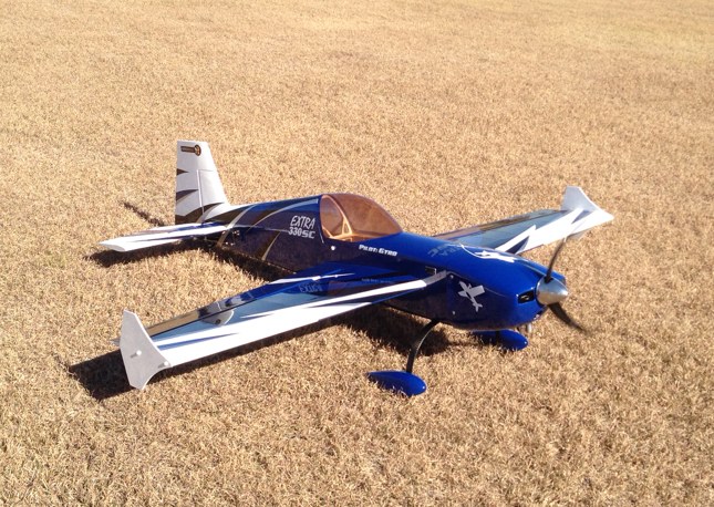

Above photo was just before take off on the maiden, and this one is after:
Yup, still in one piece!
She flew great, I was really impressed!
Highlights:
Great pop tops with multiple rotations.
Easy harriers, no wing rock.
Effortless knife edge, no coupling. Didn't need any mixes to fly nice and straight. Knife edge snaps were easy and crisp.
Balanced perfectly for 3D (pinch nose heavy) with my guesstimate of electronics placement.
The scheme is a pinch dark, but the big checkers on the bottom of the wings help.
I like it! :D
