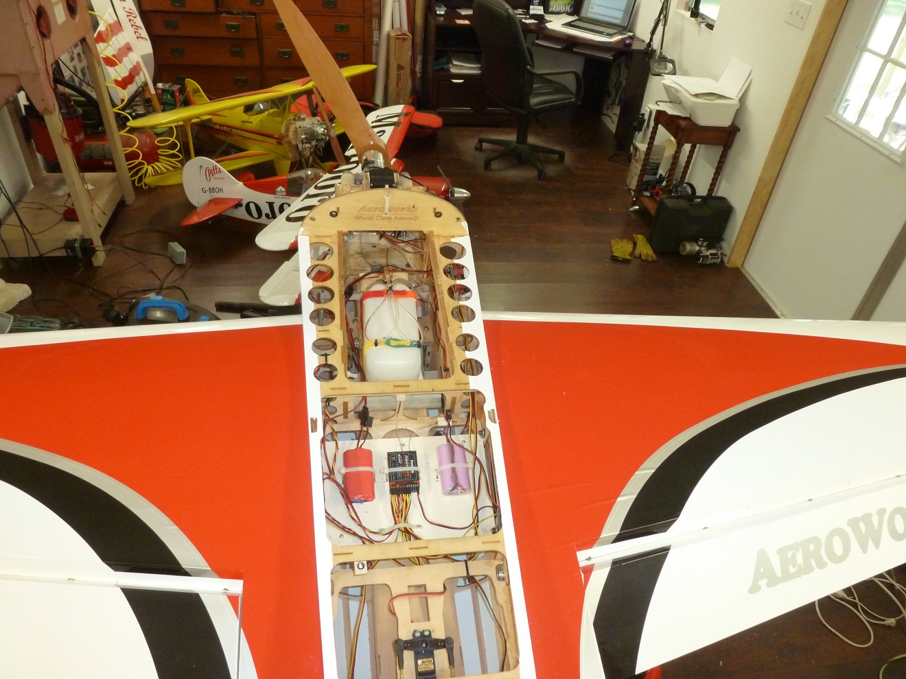

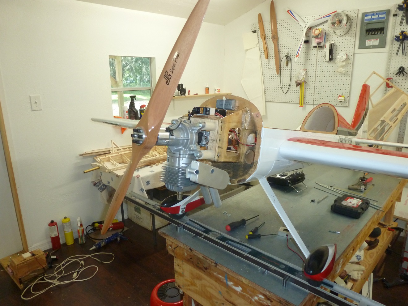

I was headed for the truck to go pick up some supplies for around the yard when all at once UPS, FedEx, and USPS pulled in the driveway. Never had all of them show up at the same time but they were all welcome. The muffler and fuel lines have been installed, have to drill the prop and I can button it up, and check the CG.
acerc
The plumbing is done, the prop is drilled, and everything has been secured. Waiting on the spinner so as to fire it up, run it a bit, and do a first flight tune. I do have one issue, the canopy hatch has a bow to it and I assume the fuse did as well prior to the rebuild. I can get the hatch on well enough for now but may replace it if I decide keep this bird and do a recover.
Also, I have never had to support a pitts style muffler before but this thing is so big that if there is much vibration I may have to do just that.

I forgot to mention it only took 9.11 oz. on the engine box to balance. I could have stopped at 9 oz. but I would rather have just a touch of nose heavy for a maiden.
Nice job on the repairs! The hatch can be straightened out pretty easily, just wet the frame with some water/ammonia mix and then bolt it to the fuse with all four bolts, it will re-warp back into the correct position.
acerc
I do that with warped lumber when building but was not sure with this thing being pre built and having the canopy affixed.
Even with the canopy installed the frame can warp a little, at least enough to go back into alighnment. The key is to leave it bolted in place all the time with the exception of assembly/maintenance to help keep it the correct shape.
