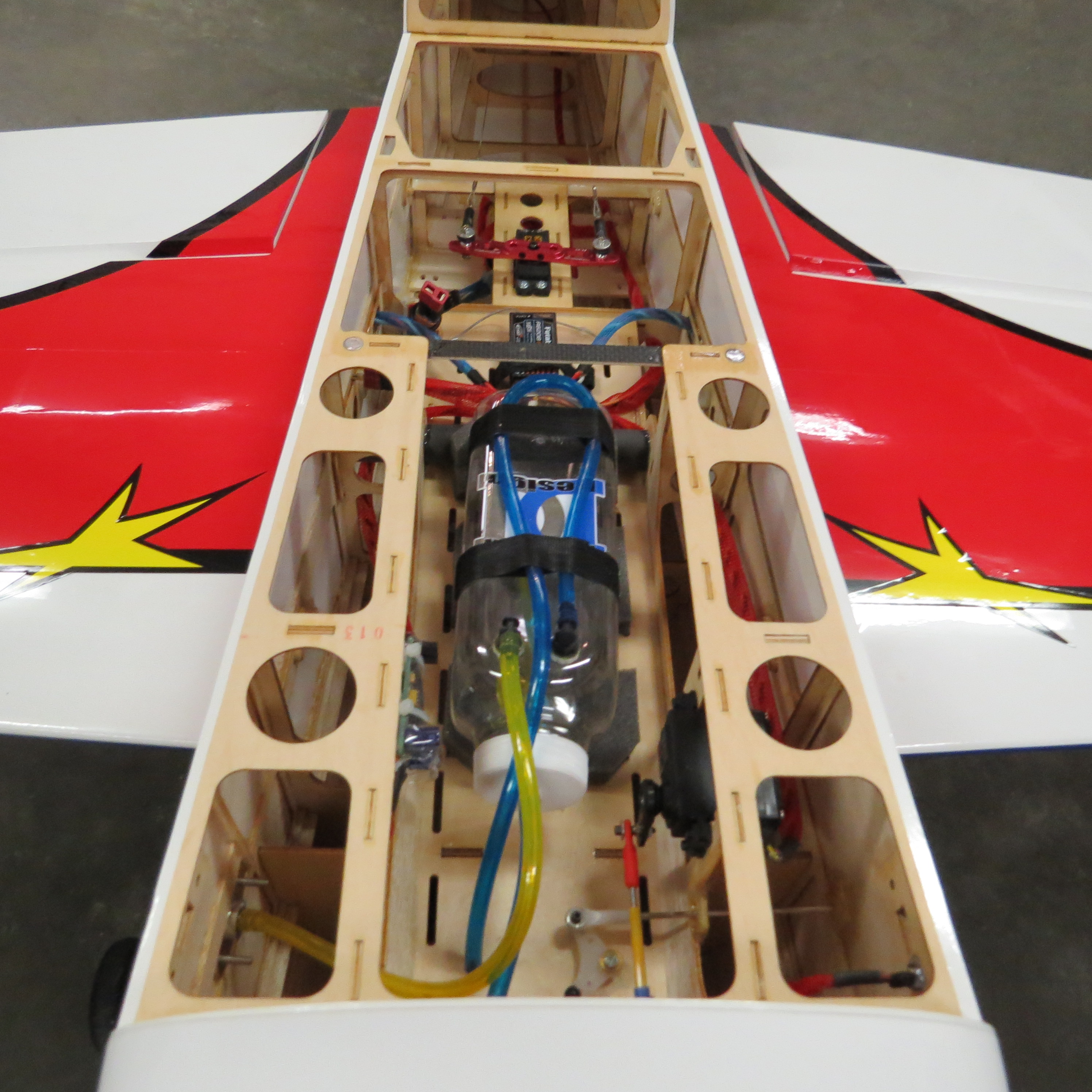

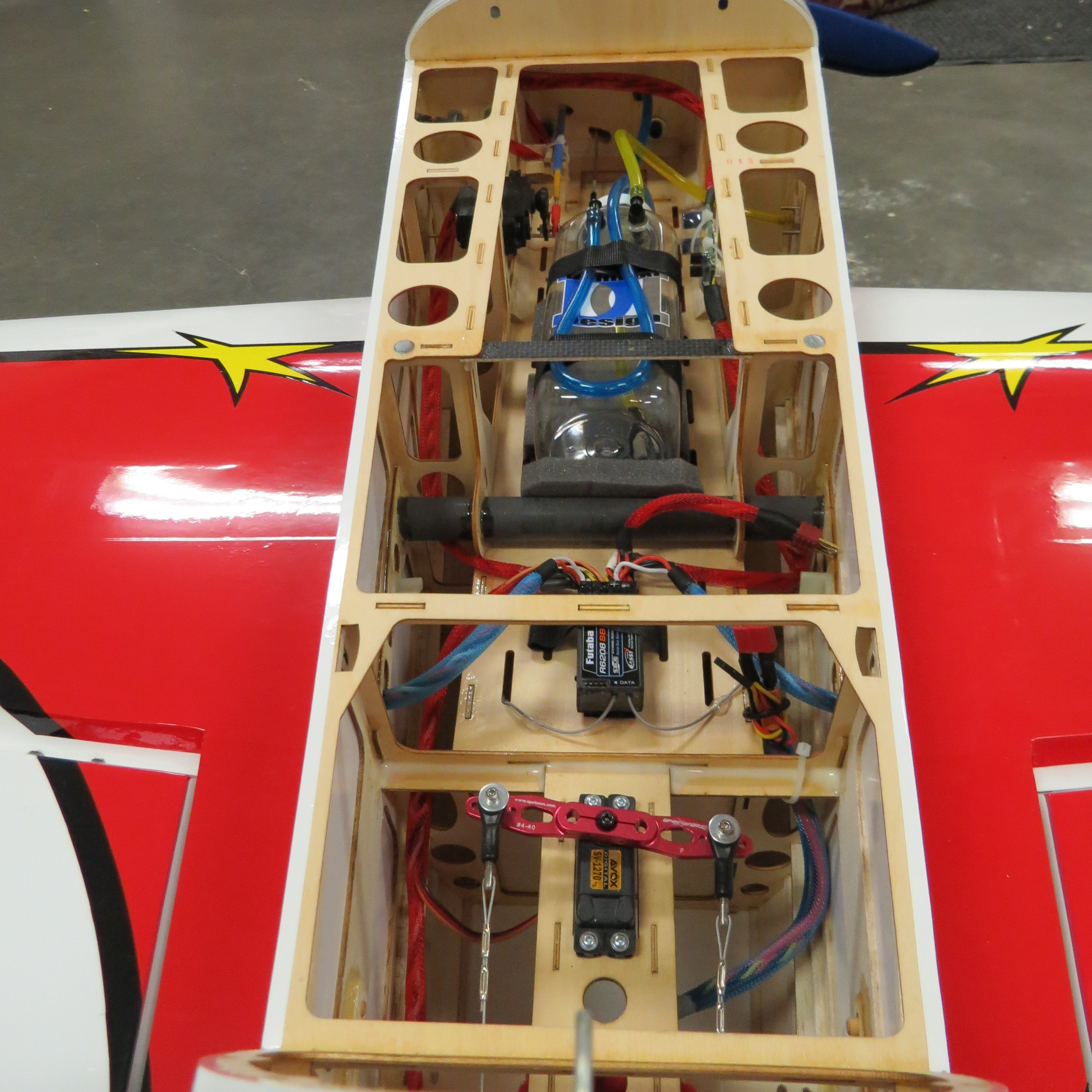

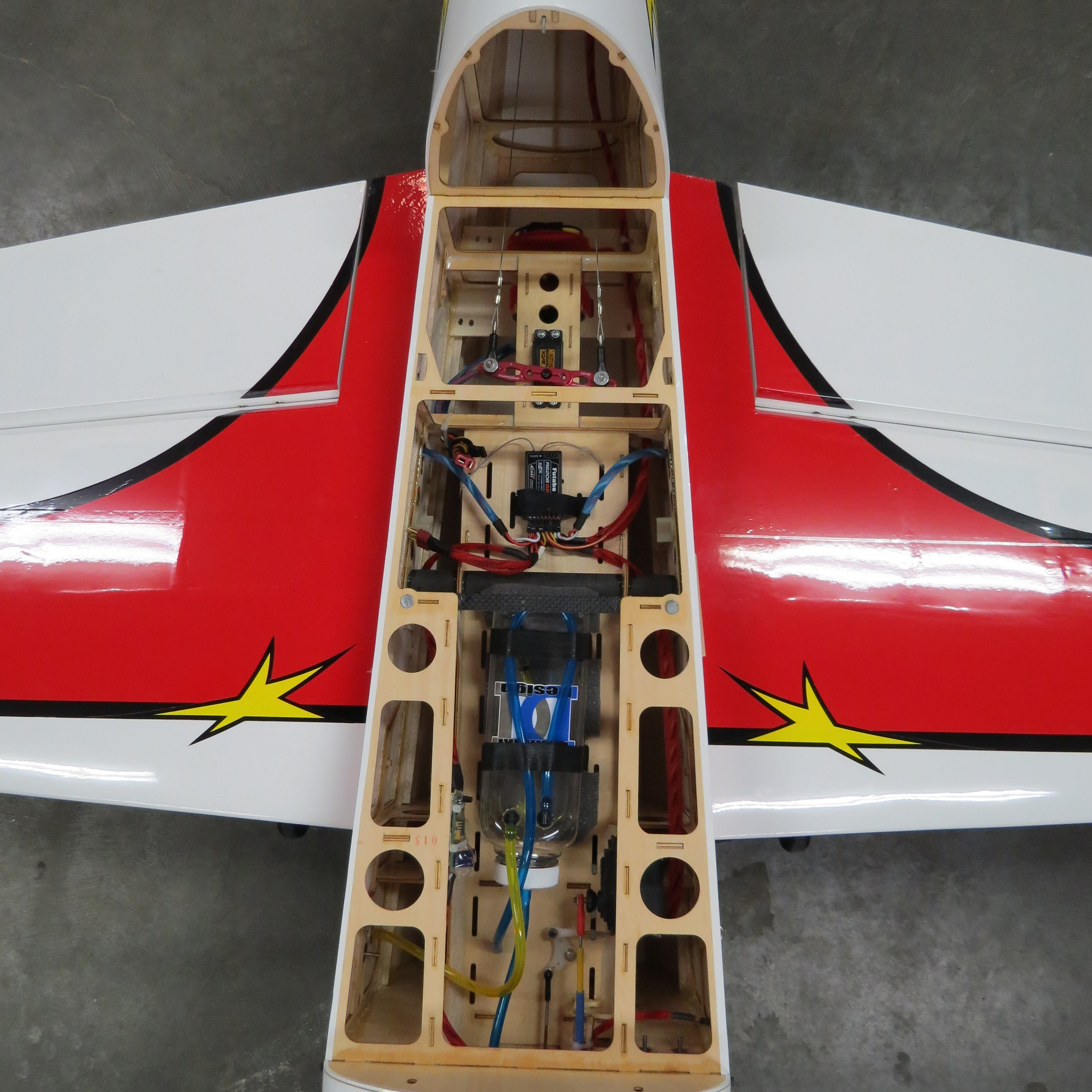

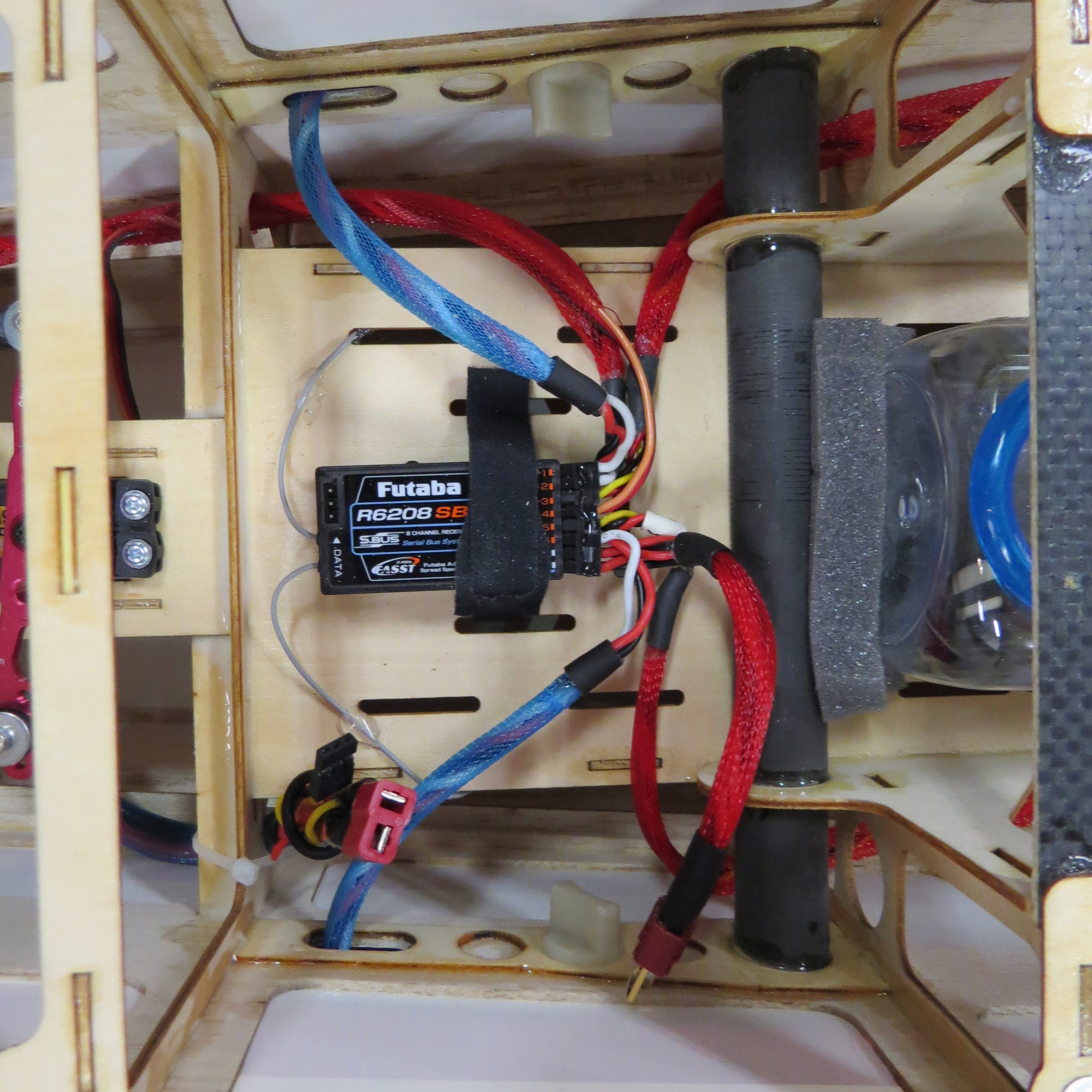

Beautiful, Nice and Clean Job [MENTION=3929]AKNick[/MENTION]... So are you done with the CG???.... I had to ad some weight on front..... I move all that I can to the front and it still was Tail Heavy, so i put 3 or 4 Weight Leads on the motor box..... Possible maiden tomorrow if NY weather let me do it.
Bipenut53
Looks really good [MENTION=3929]AKNick[/MENTION]!! looking forward to your maiden in a couple of weeks.... [MENTION=4301]PoncioPilot[/MENTION] I hope your maiden goes well!! Please keep us updated.
AKNick
I think I'm done with the CG, 1/4" is pretty close, plus with 16oz of fuel I think it should be about right. I anticipated it being nose heavy, and moved as much aft as possible. Surprised yours is tail heavy. Maybe the DLE is lighter? Dunno.
I guess I'm going to have a maiden to look forward to in a couple weeks. I hope yours is most excellent!! I want all the details post flight!!
Me too, then i figure out that i'm using 2 servos for the elevator, maybe that can be one reason... well tomorrow is the day, so I hope to come back early with a video for you guys.... the plane is beautiful, only needs a 3DRCFORUMS sticker... lol
