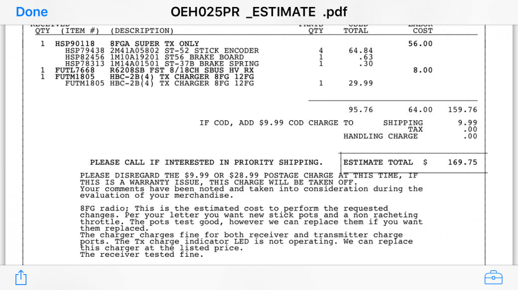

AKNick
Here's what they found... Nothing

Bipenut53
Wow that sucks!!!! So it has to be something interfering with the signal. I hate it when I cant find what is causing the problem...... So what is going to be your next step Nick?
AKNick
Still thinking an intermittent failure on the receiver. So new receiver for sure. Maybe a ferrite ring around the tech aero? Or a new tech aero. Engine was running great even during the lock out, so I doubt it's a battery issue since the tech aero runs off the rx.
