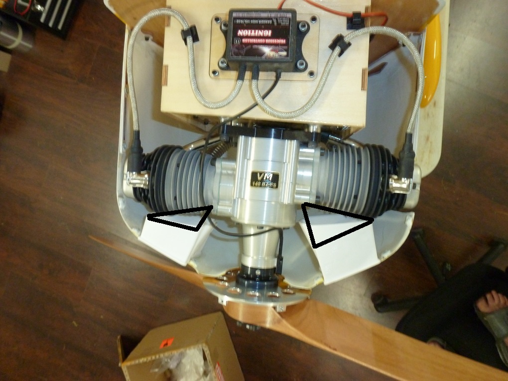

This is just my lousy $0.02, but it's also pretty easy to do so take it for what it's worth, but you may want to consider slapping some black creative foam over the top of the baffles to close up the gaps between the cylinder heads and the edge of the plastic baffles. It would keep air from escaping the engine and force it right over the cylinder heads. Especially important in humid weather, as I so found out last year :omg::omg::omg:

On the two strokes I would most definitely agree but these four strokes run much cooler, at least the ones I have ran. On my Pitts I had to baffle air away to get it to run warmer, it was only running 180° to 210° but after baffling a little air away it is up to 270° to 290°.
But if this Laser does run on the hot side I do have plenty of the foam, thanks to you, to close those up.

At least it's an easy 2 minute fix :way_to_go:
