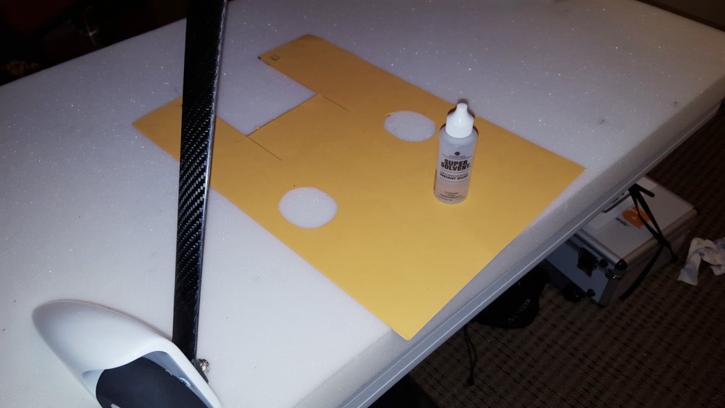

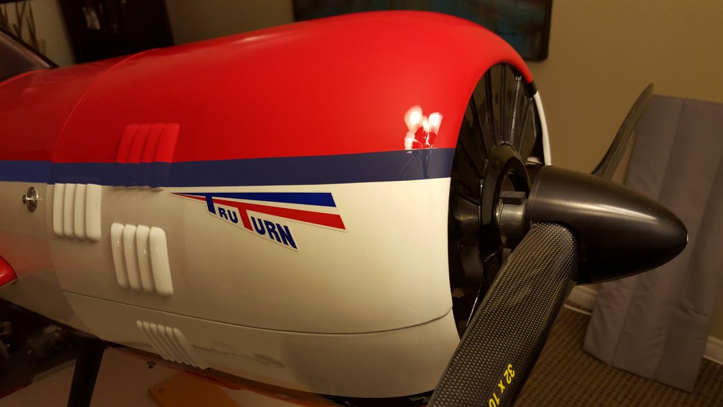

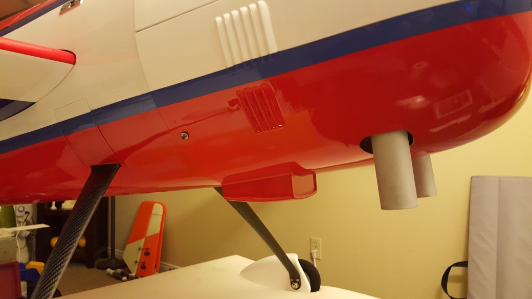

This is the first time I tried Rocco's "the ol' use card stock 4/40'd to the cowl mounts for marking the muffler holes trick" (I usually run cans). It worked like a charm. Also, I don't know what you guys use to cleanup unwanted CA, but I've been using Hot Stuff since 2001 and don't know what I'd do without it.
