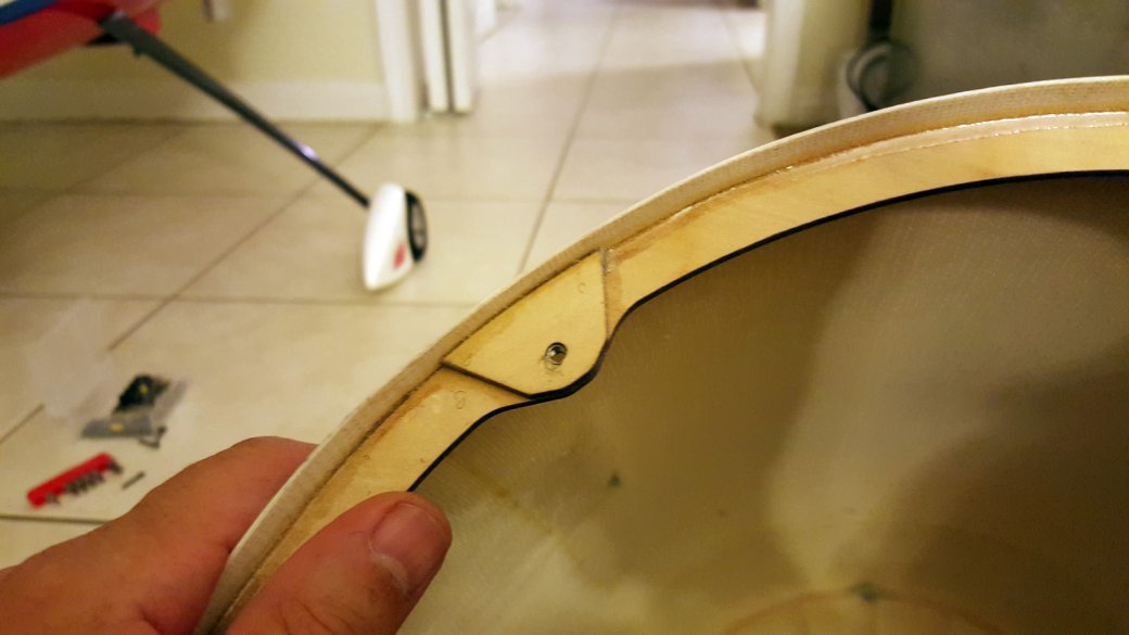

Okay, back to the assembly. I mentioned that everything on the plane was a perfect fit... wings, tubes, anti-rotation dowels, all bolts and blind nuts, et al. But, I did finally find one thing that I had to fix/adjust. I had put the cowl on, and I had put the hatch on, but I had never bolted them down tight together. When I tried I basically could not do it. The cowl was in the way of the hatch going on. The fix was very quick and easy. I added some 3/32 plywood pieces to the the blind nut ply pieces on the cowl. That spaced the cowl back 3/32" and then the cowl and hatch got along just fine. Basically the cowl ring was glued on 3/32" off of where it needed to be. Other than that the fit and finish is perfect.
