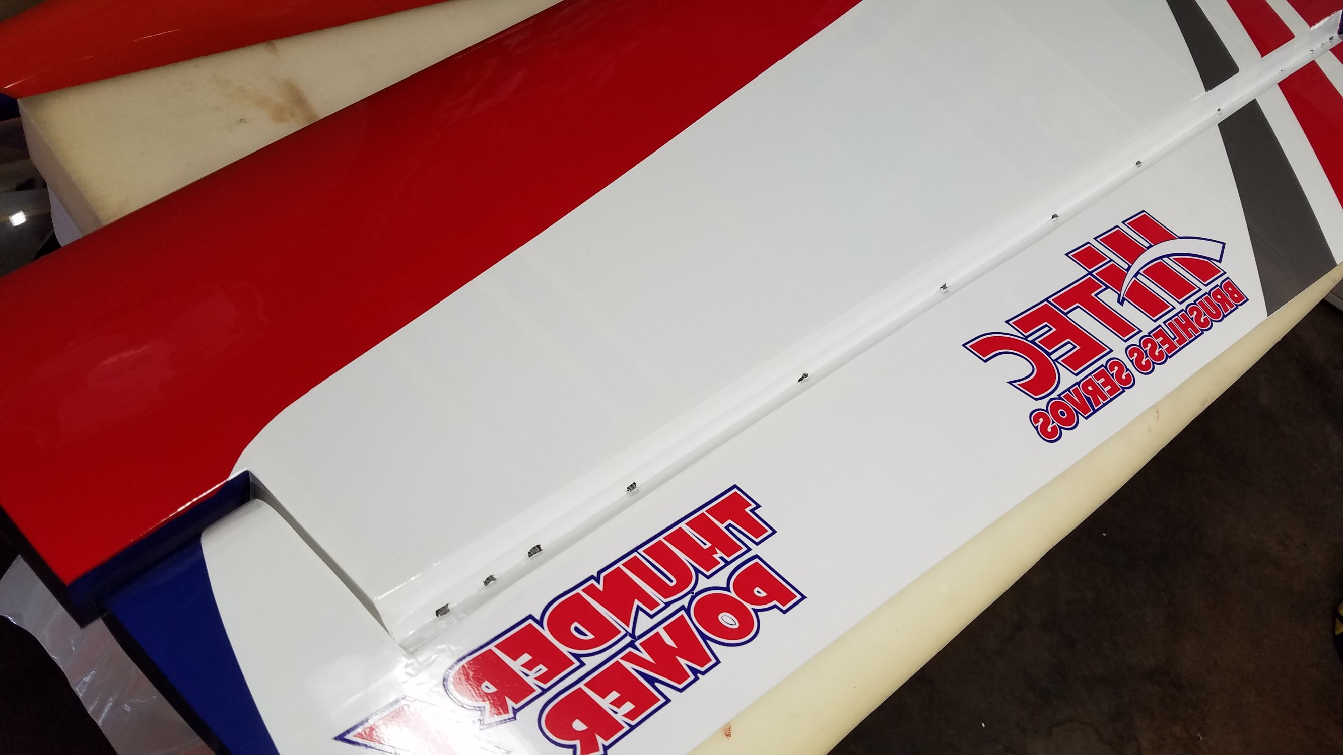

I think I'll always do the hinge gaps now, though mine don't look nearly as clean as yours :dancing-chicken:
Joe Hunt
Yup, they work! Thanks on my gaps... I really rushed those, I was not in the mood. haha Normally I'll measure and mark and use a hole punch for all the hinges... comes out real nice. That day I was just "over it all." haha

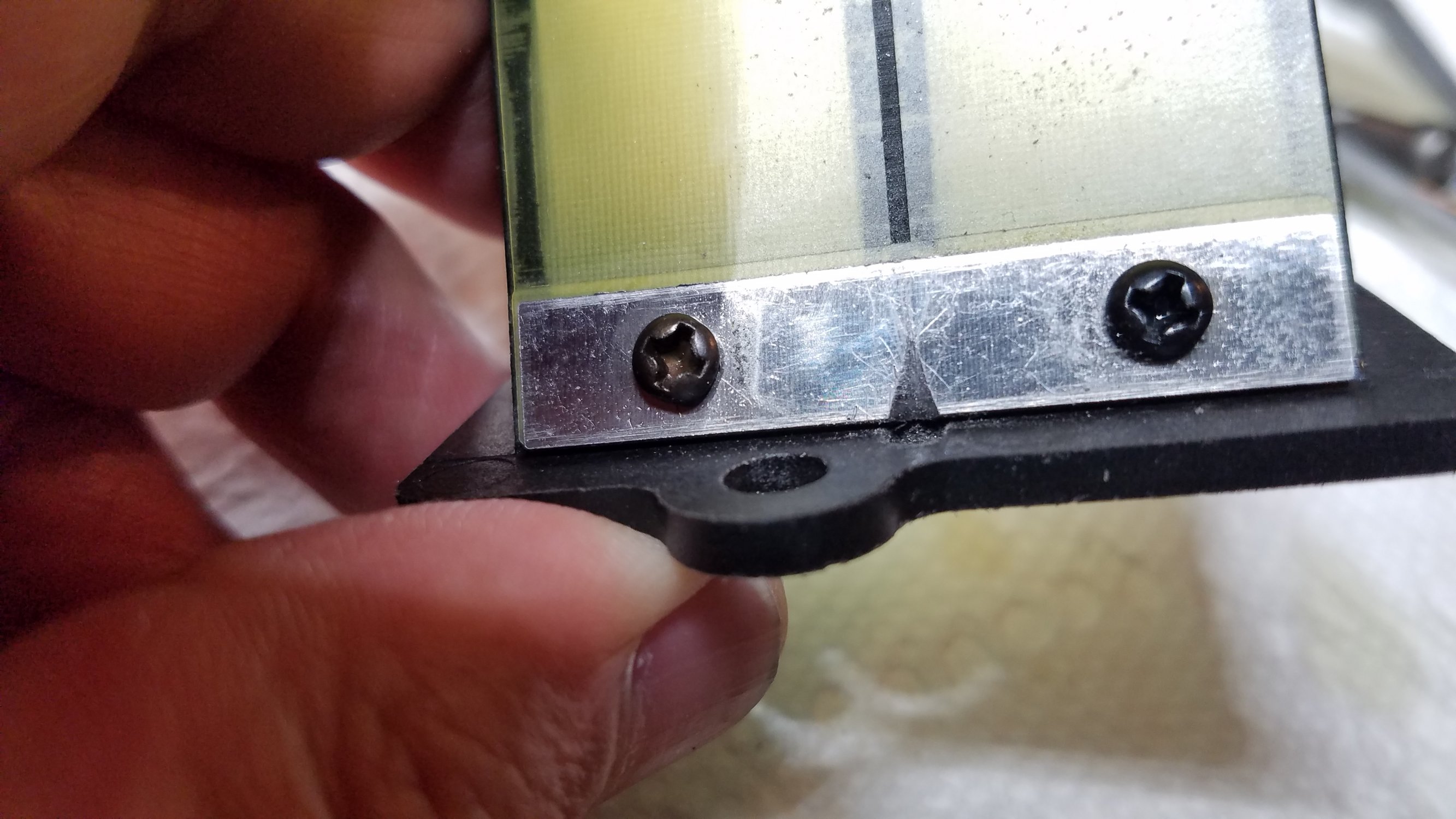

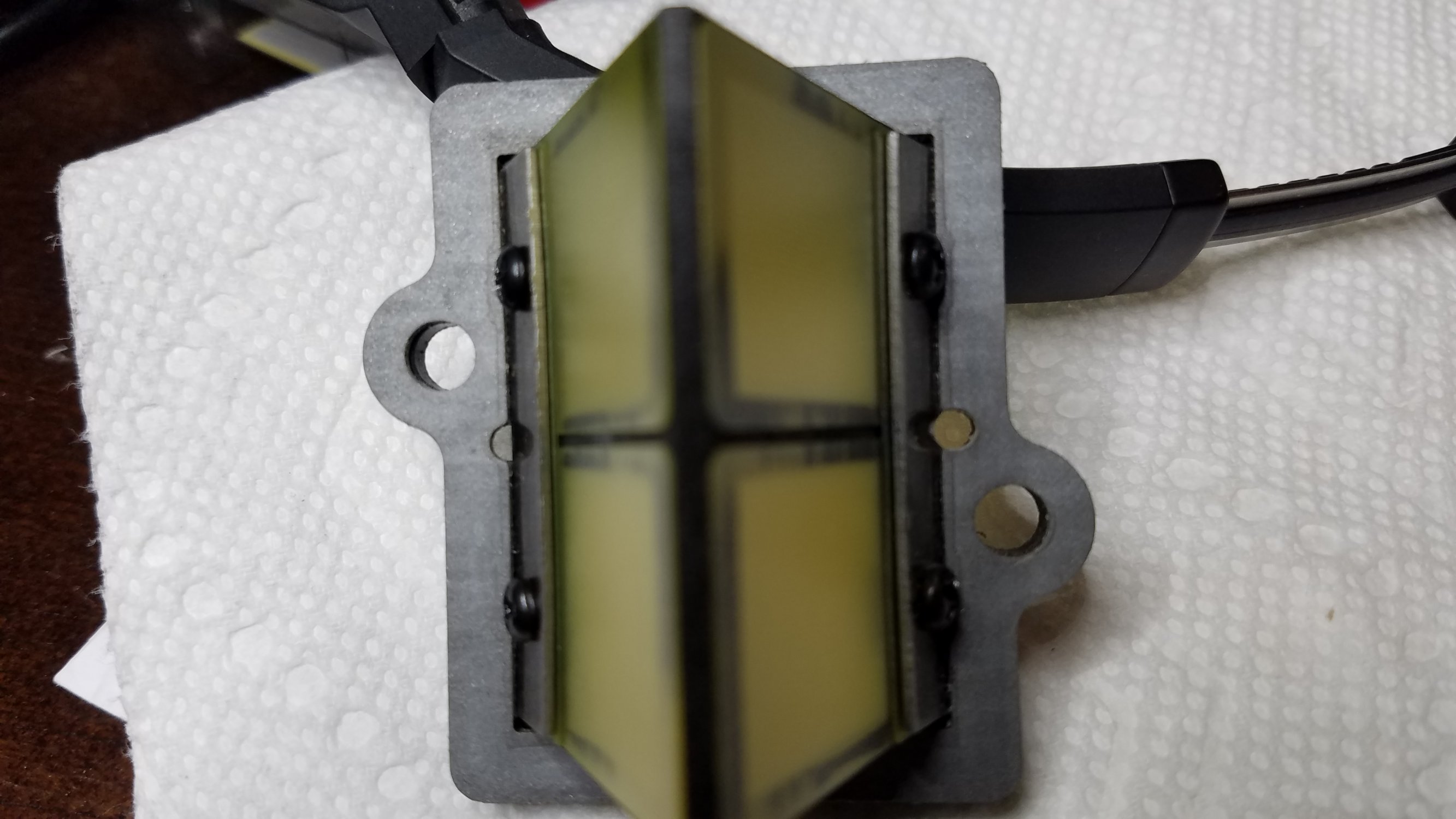

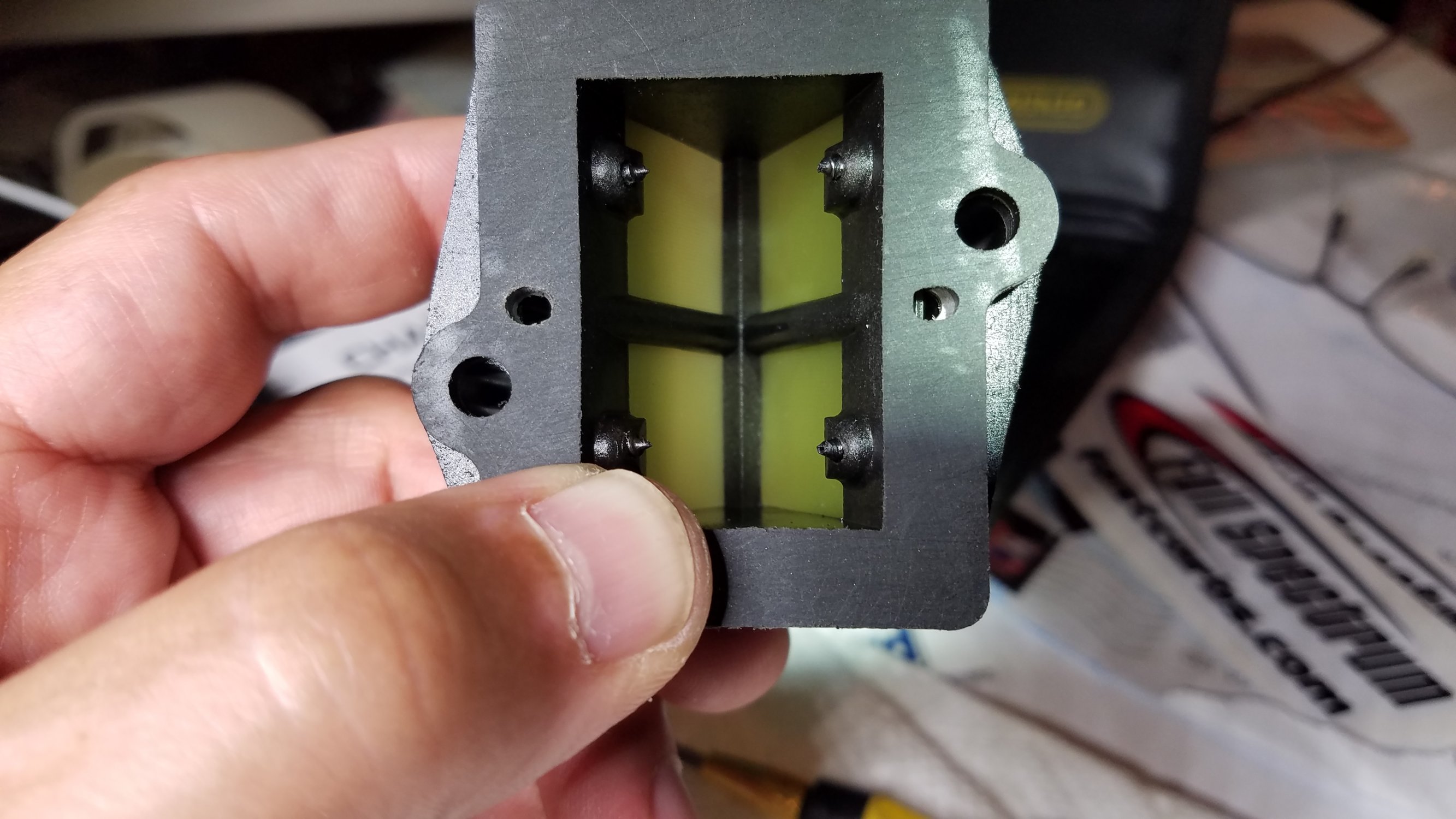

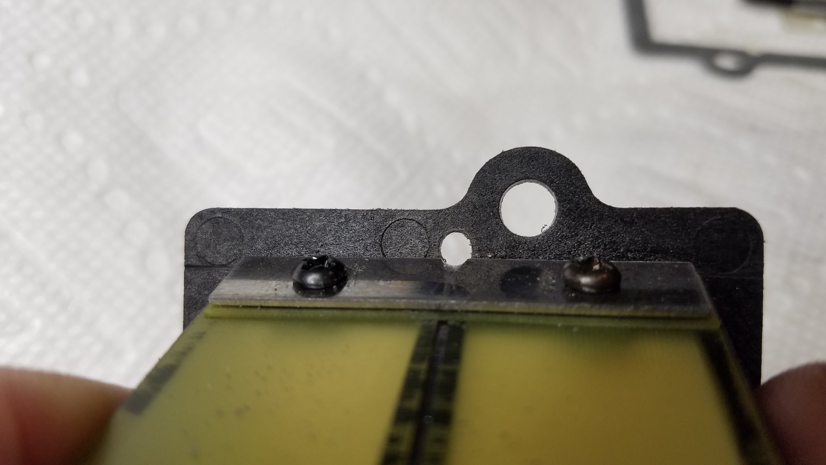

Okay, got to working on this DLE 170. I changed the reeds to the Boyesen reeds I got from Ed @ www.fastcarbs.com. The stock reeds are stiffer and clear, these are more yellow. While I was in there I noticed that the impulse port hole was basically around 50% blocked. Partially by the gasket and mostly by the metal plate that holds down the reeds. I got out a small round file and went to work on it. The carb only uses the one side, so in the pic you'll see the hole on the right is stock and 50% blocked, the hole on the left is the one I worked on and it's wide open.

more... and we'll see how much difference it makes probably tomorrow. @Tavis says a lot.

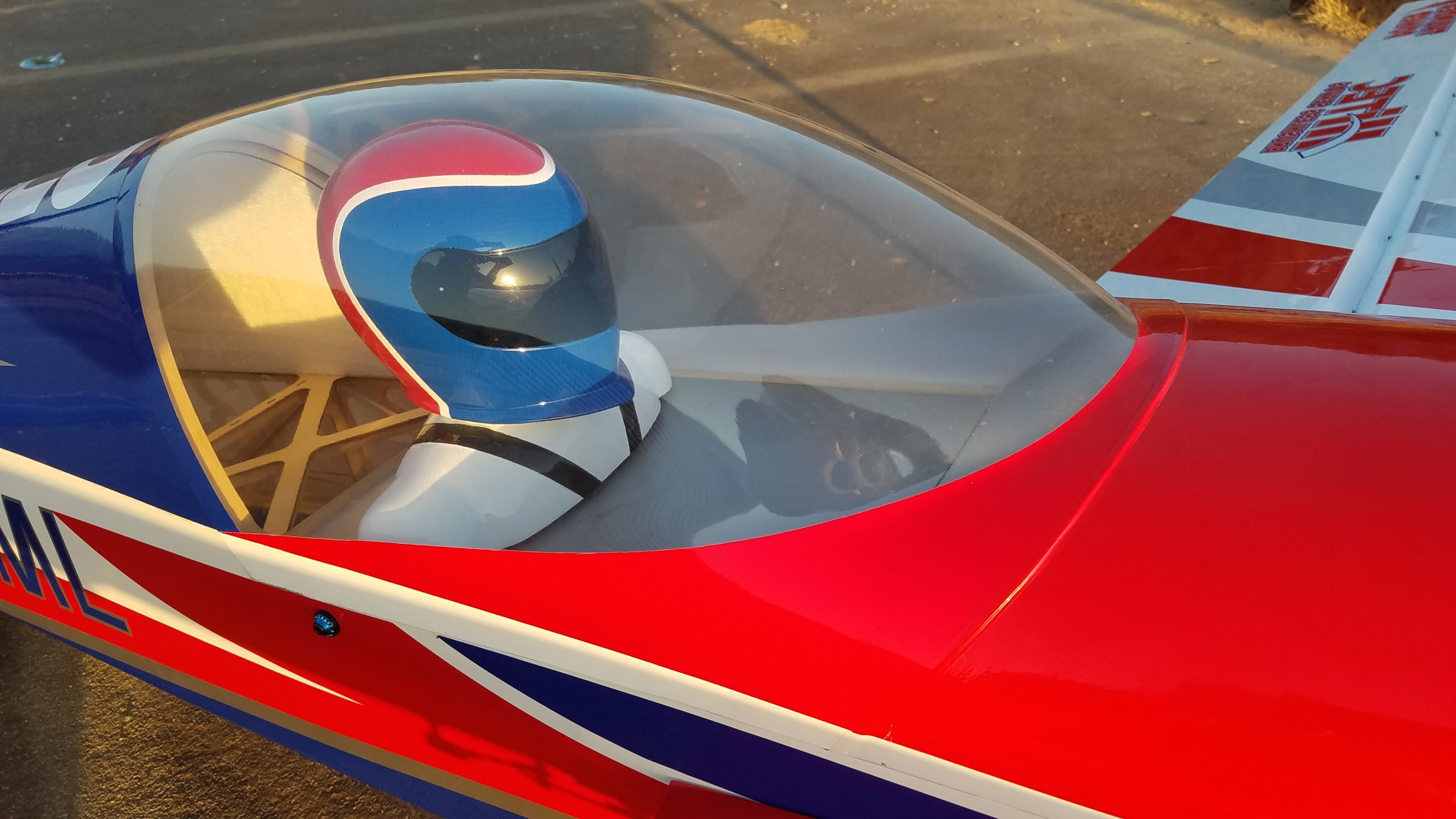

About the EF 110" Yak54... the included pilot is really big (same one that EF sends out with the 125" Extra, I think). And, doesn't really fit. Now the G-Force pilots are super cool and I have the 42% version in my 122" Extra. But, I wish its head was a little bigger so it would look more scale. Turns out that pilot fits in the 110" yak54, and the EF pilot has a bigger head and looks more scale in the 122" Extra. But, it's not nearly as cool as the G-Force pilot. So, I'm trying to decide if I can get along with the EF Pilot in my 122" Extra, or if I'm going to order another G-Force Pilot. :O lol

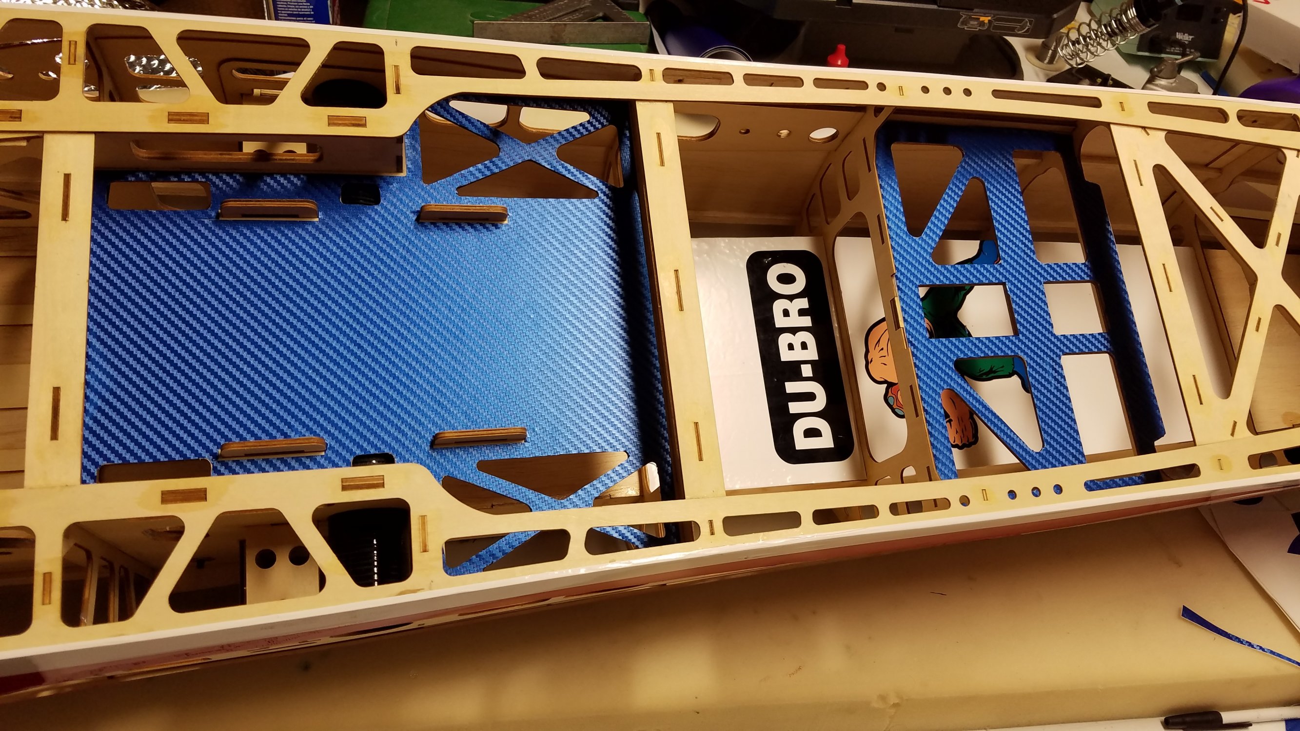

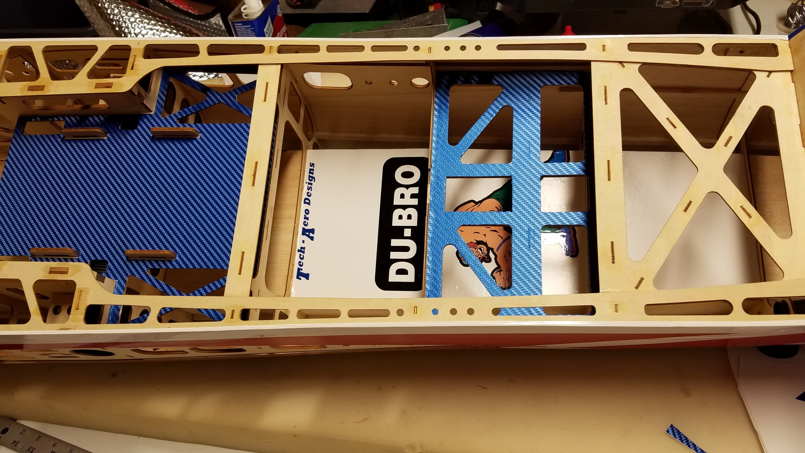

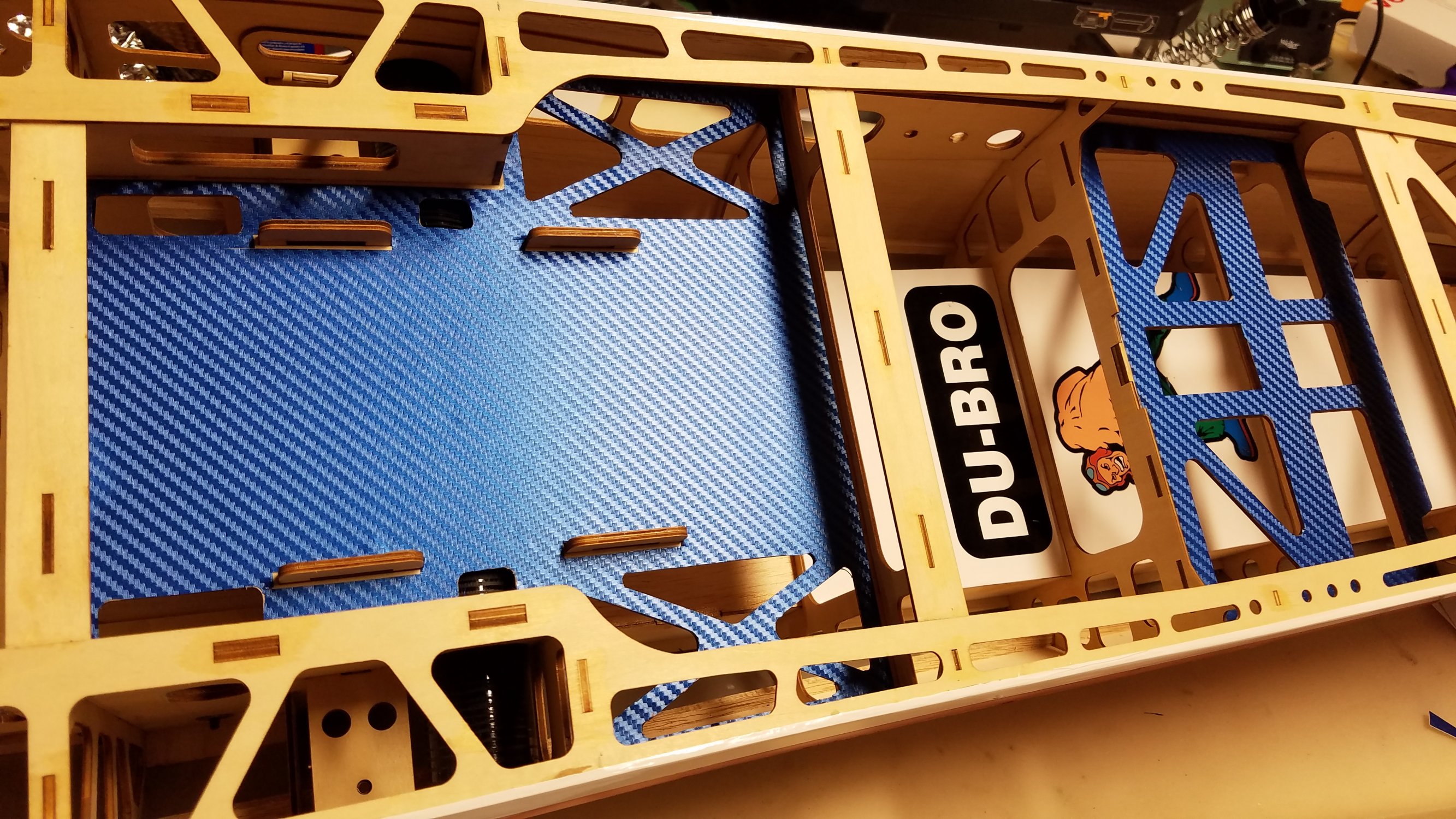

Okay, got back to the Yak54 for a couple of hours tonight. I'm going to use my 42% G-Force pilot in it. :) I still need to build a 1" tall box to go under him so that he can see over the cowl when he's flying! So, I figured that out, and that is the hardest part. haha
I finished up the little bit of cosmetic work I did inside the fuse, just trying to make it look a little more fancy. :)

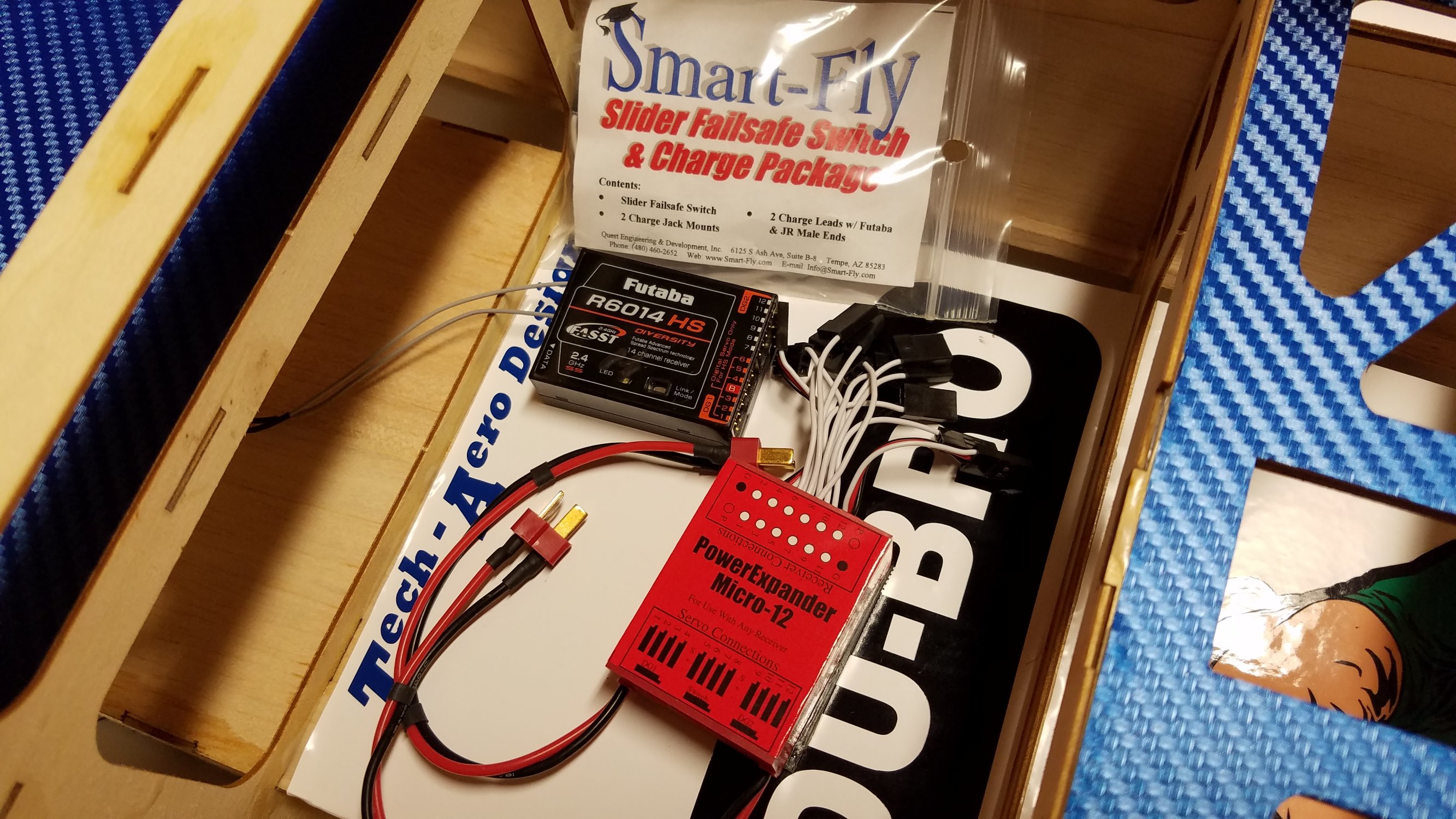

I was thinking to just use a 6014 receiver, without any power distribution (especially with these 9380 servos, they just don't use any power). But, at the same time I didn't want the switches to be a power bottleneck. So, I'm thinking I'll go with this SmartFly Micro power expander and failsafe electronic switch.
