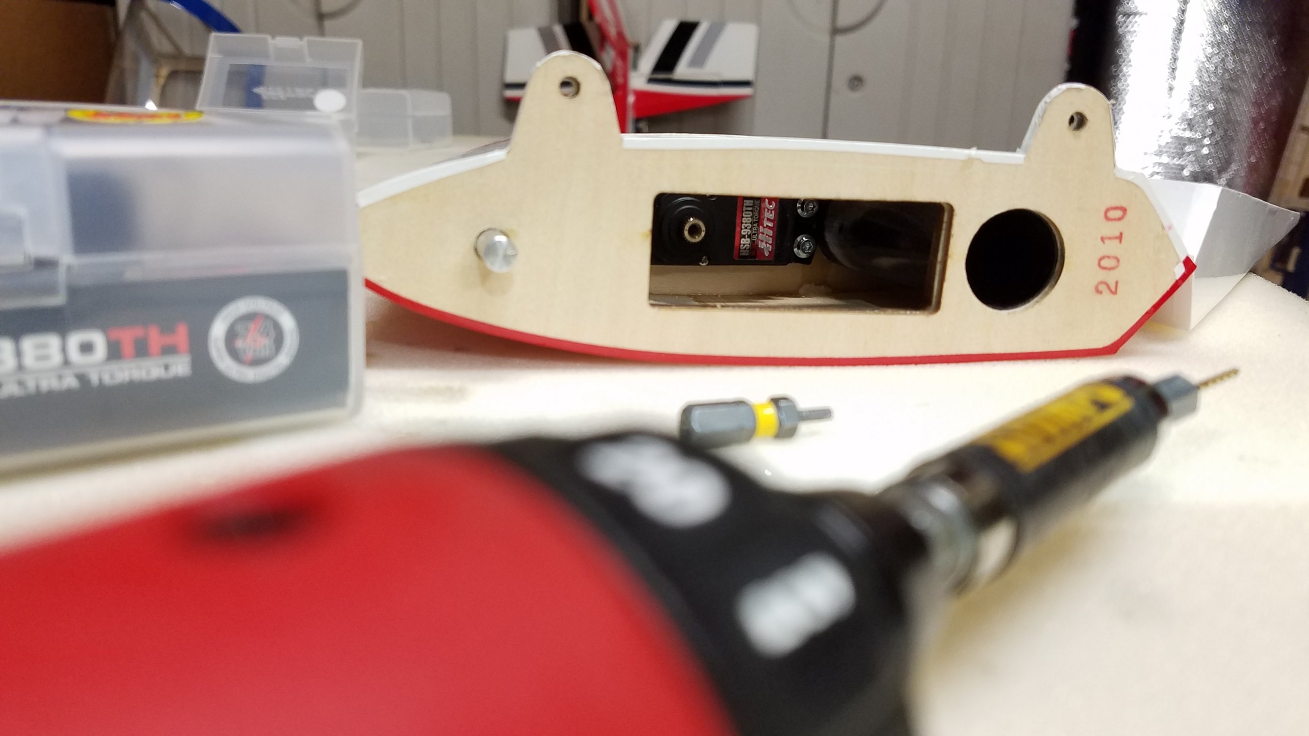

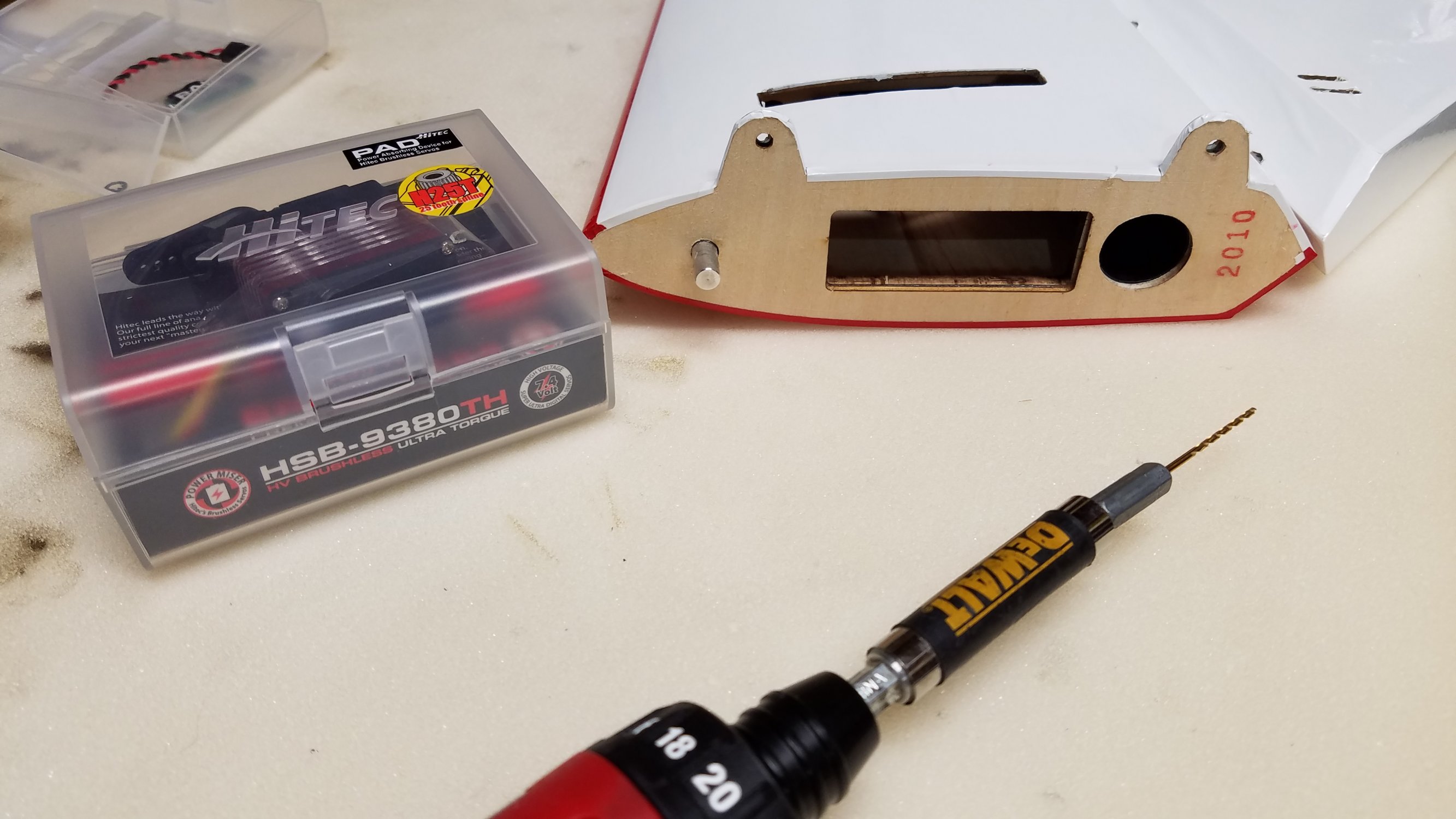

I've heard guys complaining about installing servos inside the stabs on a variety of different planes. I looked around the shop at what tools I had and found I had what I needed to make installing the stab servos quick and easy. :)

Always enjoy your builds, and video Joe. Glad you're back. On mine, the area where the screws go in seemed soft for my tastes. I ended up putting little doubler plates behind each one to give more meat to screw in to. I also use the #3 "Servo mounting screws" from RTL instead of the #2's of years past.

Hi Phil! Doubler plates, we used to have to install them a lot in the old days, sounds good! I ended up putting that big ol' Pilot that came with this plane in my 122" Extra. I'm putting the 42% G-Force pilot from my 122" Extra in this plane, it really looks good in it. You're a no pilot kinda of guy, yeah? :)
