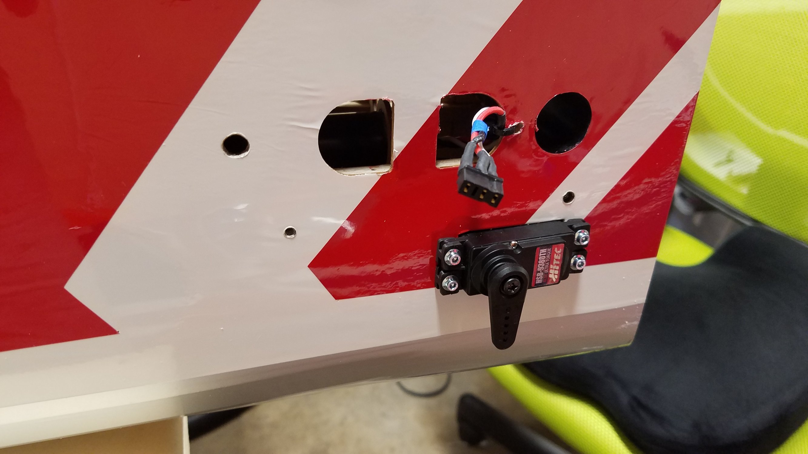

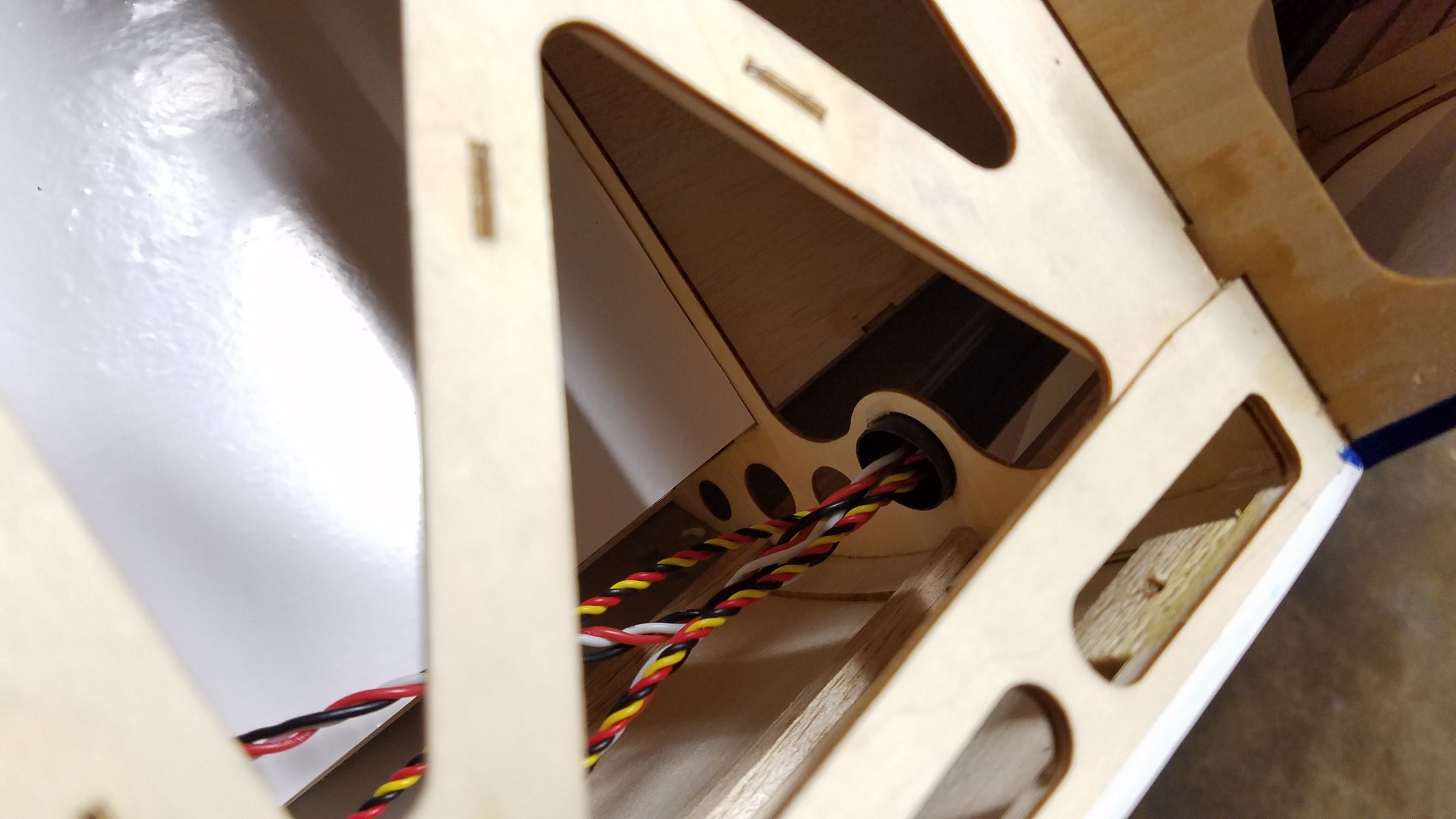

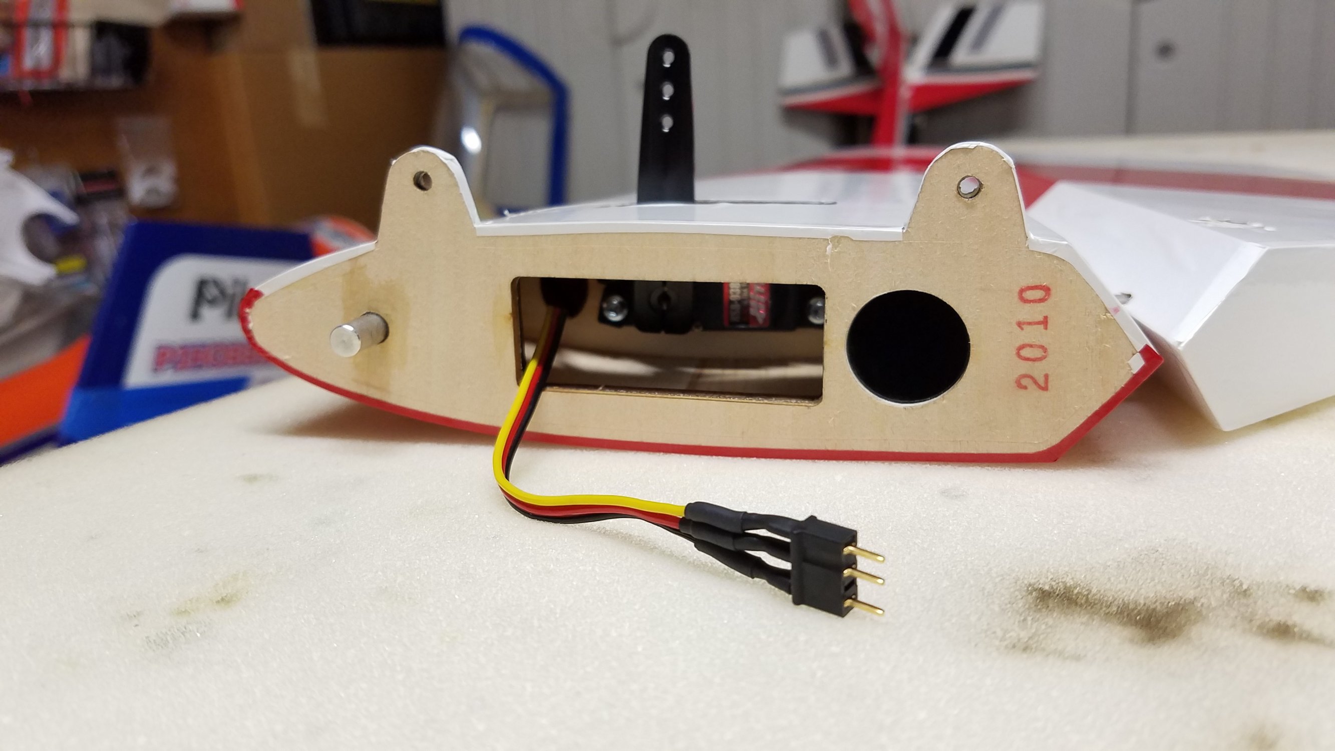

I tell myself not to, but I always end soldering Dean's ends for my elevators and ailerons. It is nice to have them on there. I have my four extensions run through the factory extension tube. This plane is pretty quick and easy to put together... if I'd ever spend some time on it. haha

That's a great idea actually. How do you secure the connectors together though to keep them from coming apart?
Joe Hunt
That's the beauty of it, more current than a standard RC connector, and no need for safety clips. They have a snug fit that won't come undone in flight. :)

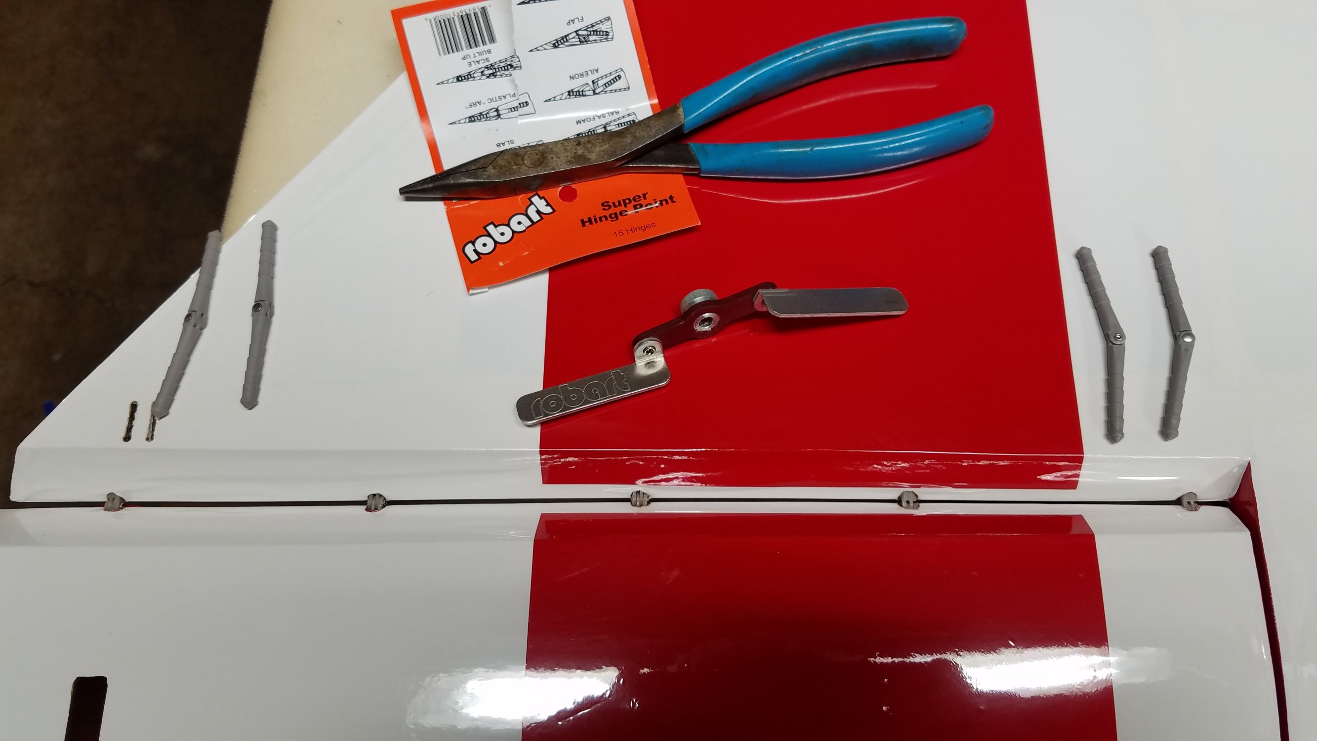

All my experiences so far with ARFs tell me that I do not want my hinges glued in. Thankfully here they are not. Just drilled and the off brand hinges put in dry. This allows me to do three things:
1) add a hinge to each end of each control surface
2) use Robart hinges (a friend just had his included off brand round hinges disintegrate in just a few flights on another brand ARF, and of course my Pilot RC hinges fell apart pretty quickly, also my H9 rudder hinges fell out)
3) glue them in myself with a quality glue, in my case that means ZAP 30-min epoxy (never had a hinge even remotely start to come loose using ZAP epoxy)
