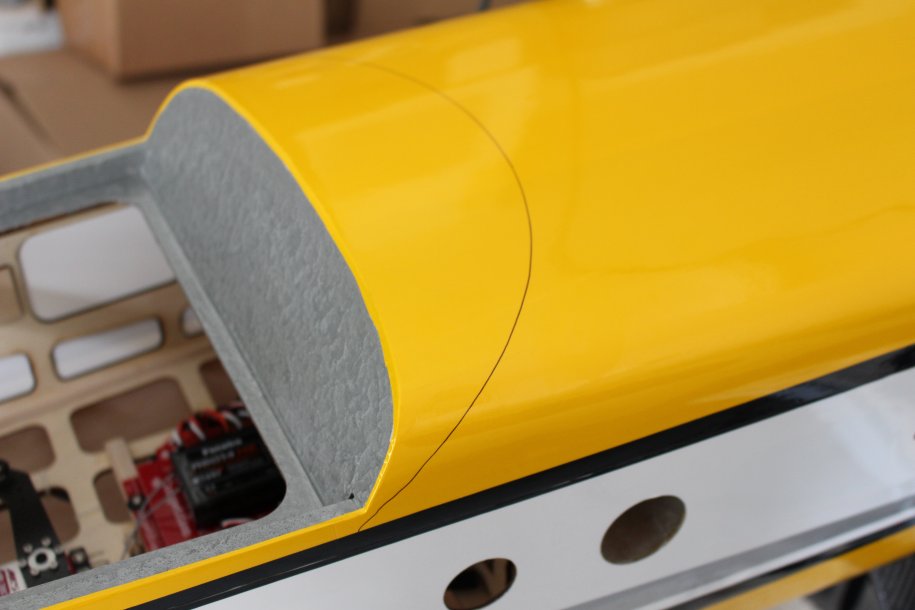

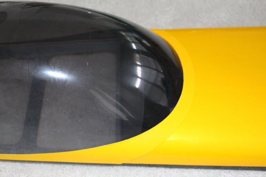

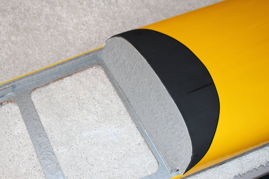

I got my repainted parts back from my friend Pedro who did a beautiful job matching the colors. Back to work finishing for the week-end.
I don't like the covering possibly getting wrinkled inside the canopy, on top of the dash, where I cannot access with an iron to fix it, so I remove a piece of covering, and paint it flat black.
I trace the outline on the covering, and I make sure the cut line is under the painted part of the canopy, about 1/2" inside the outline.
