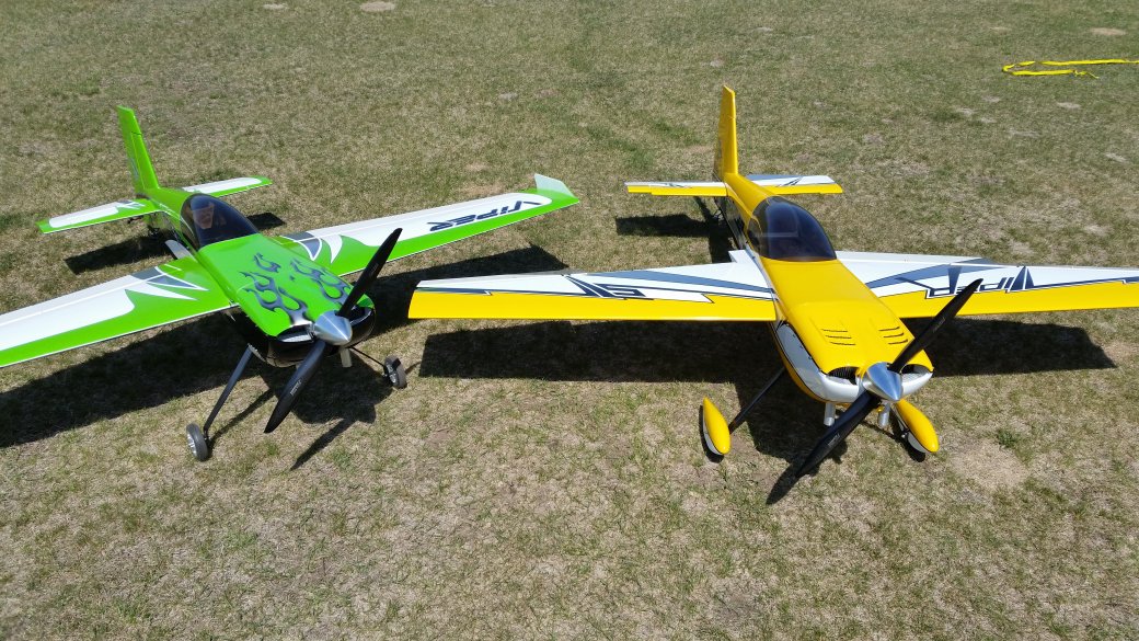

Very nice Herve! Mine is in the trailer, batteries charged and I just need to wrap up some paperwork and wait for TheLAW to show up for camera patrol. Haven't flown in 5 weeks with all this blasted wind, hope I can do it justice! Looks like 14mph wind this afternoon so not ideal for knife edge mixing but we'll get it close and see what it will do.

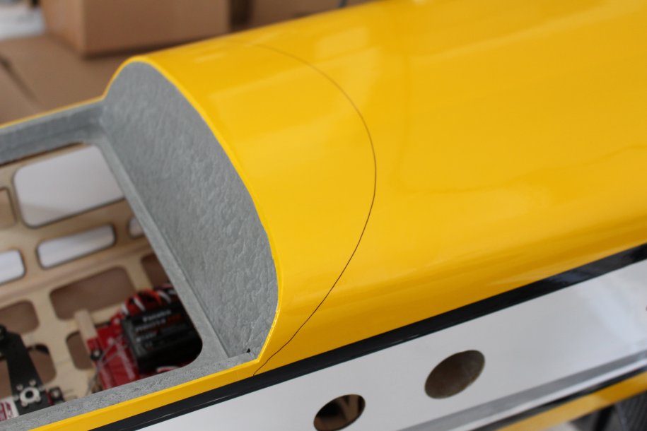

I got my repainted parts back from my friend Pedro who did a beautiful job matching the colors. Back to work finishing for the week-end.
I don't like the covering possibly getting wrinkled inside the canopy, on top of the dash, where I cannot access with an iron to fix it, so I remove a piece of covering, and paint it flat black.
I trace the outline on the covering, and I make sure the cut line is under the painted part of the canopy, about 1/2" inside the outline.View attachment 18010
That is the way to go. Though I usually spray speckle paint that matches the cockpit instead or grey to match the dash. But hate the wrinkles also!

It flies!

Well done Terry, thats awesome that you allow PAU to do your kit, says alot about them as people and as a conpany, looking hard into one now.
