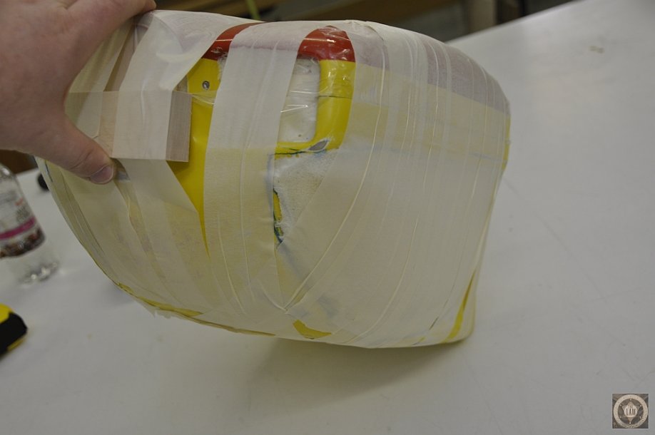

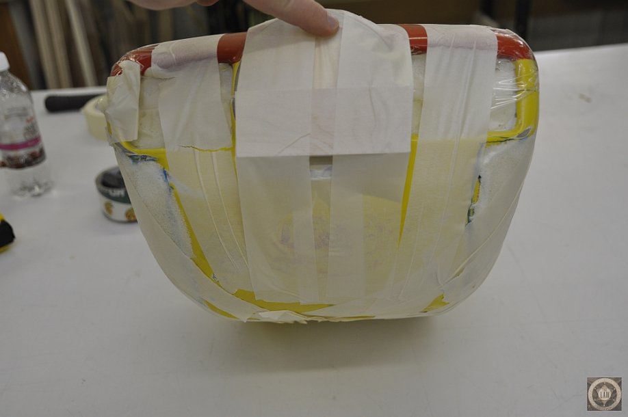

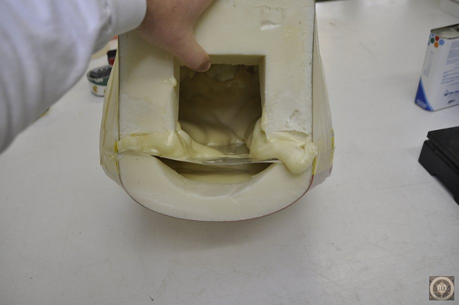

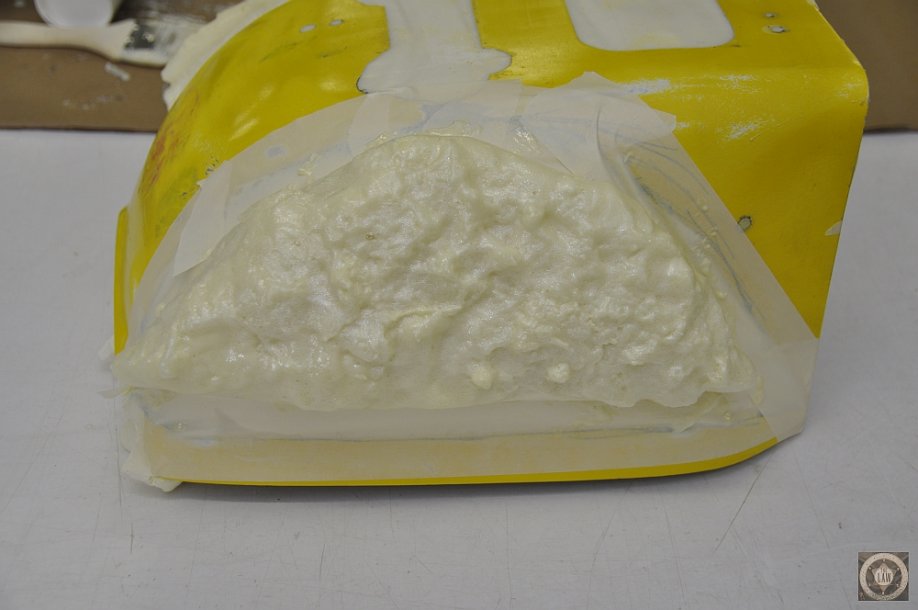

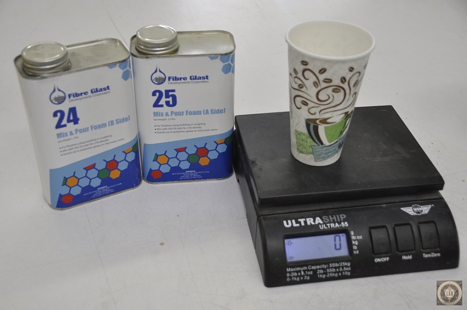

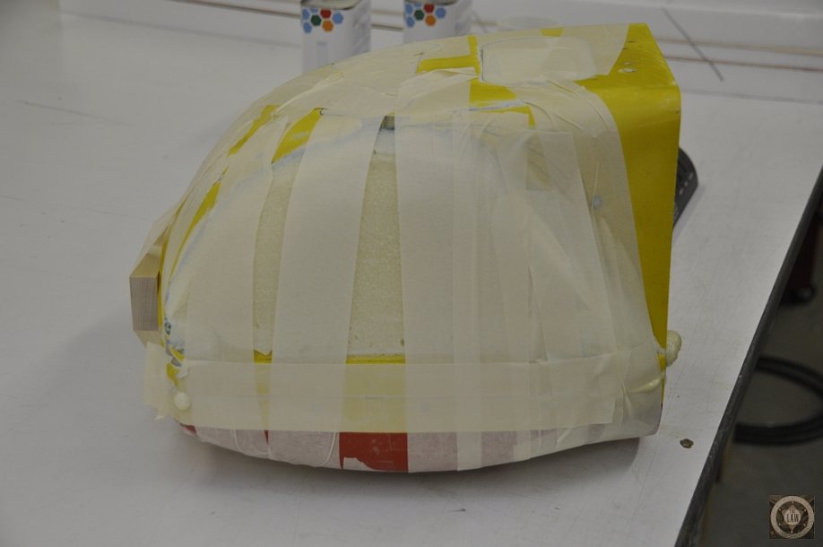

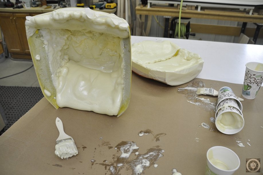

So, since I'm going to be cutting chunks out of this in particular on the back corners, I want to make sure it maintains shape. I like this two part urethane expanding foam. It's pretty crazy shiznit, and is really heavy, dense and easy to carve and shape. Sands nice and works well with various fillers and chemicals. CA glue does not even eat this stuff!!!
So I filled in some of the areas that I'm going to be building up, and also hit the outside of the cowl with some 8 grit with a low speed orbital to really rough it up. I made a dam with some masking tape and put some foam in. When you mix this stuff you basically have 90 seconds to mix, pour spread and cross your fingers.

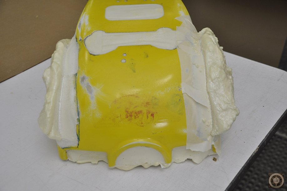

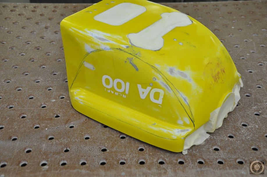

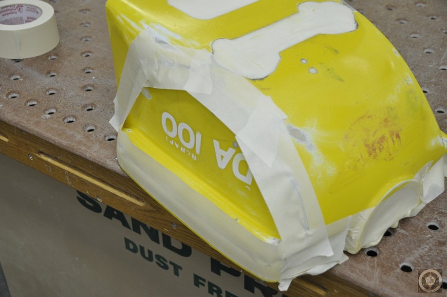

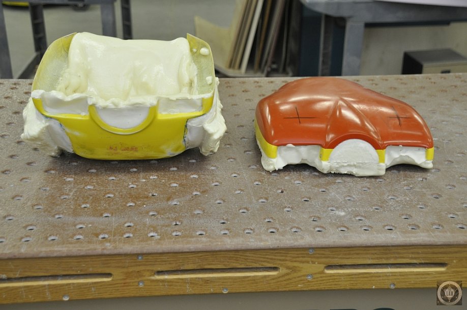

Yup, it does get super hot. I did a little hacking, carving and sanding and got the basic shape knocked out. I needed to put a little more foam on the inside to firm up a couple of spots to I applied packing tape with mold release on the to half, taped it all together and poured more foam on the bottom half. Got like a pizza oven in there!!
Anyway, other than I need more filler towards the back, you can start to see the basic shape of the sides now:

Wait for this foam to harden and I'll apply a little more on the outside. Next I'm going to doctor the openings.....these suckers are HUGE and need to be scaled down a bit. I may have to do that with regular bondo though so that will likely happen tomorrow between working on the Viper.
