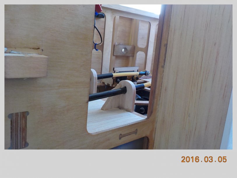

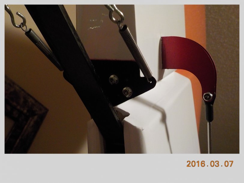

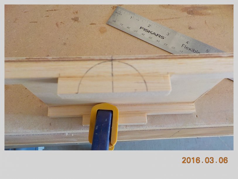

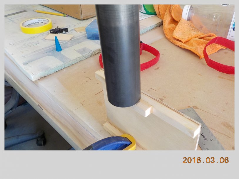

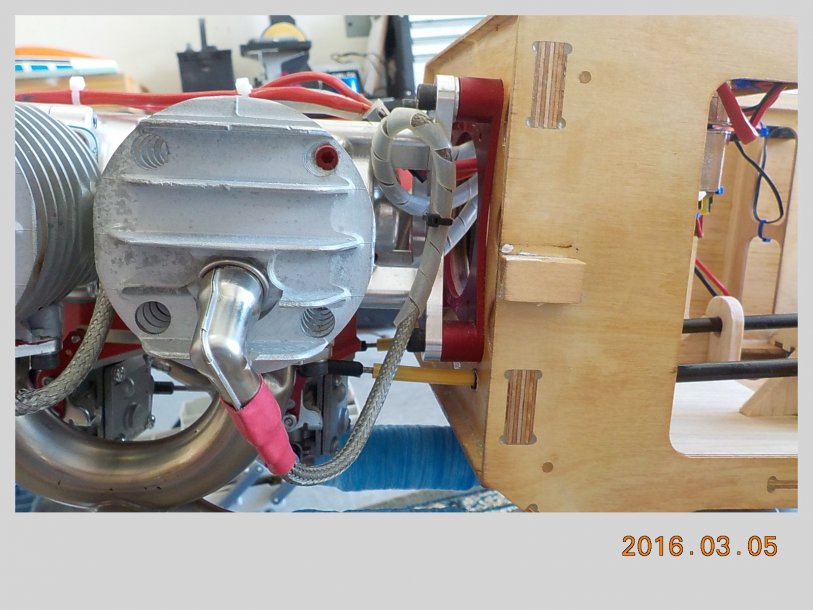

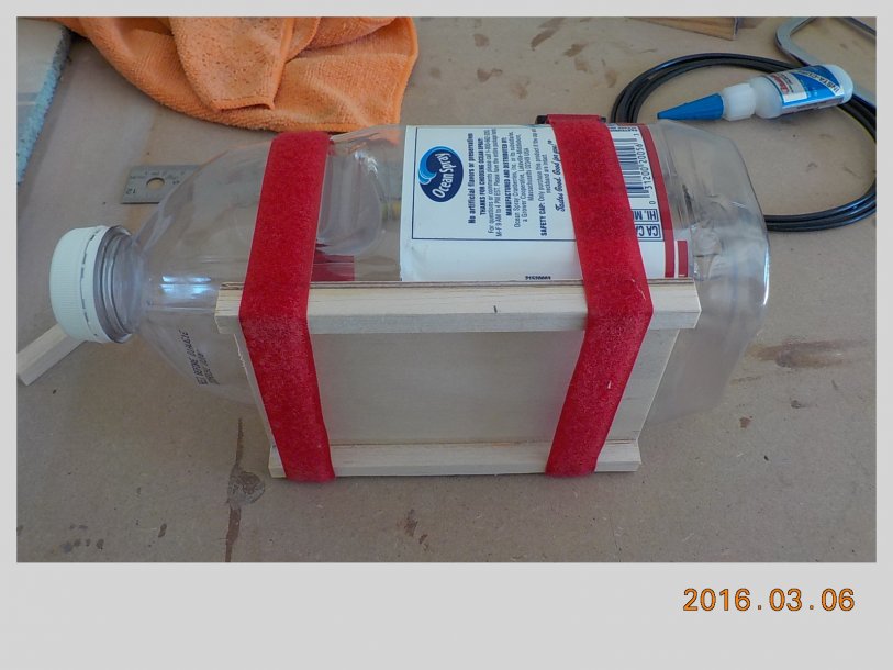

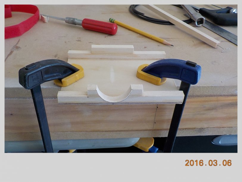

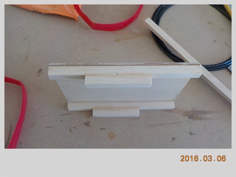

OK, I owe you guys and update, so here it is.
With a little luck I will be maiden it Saturday or Sunday weather pending.
Now the SWB engine mount is on correctly LOL!!! Engine and exhaust are in place throttle servo and choke servo in place and working perfectly. For the tail wheel I made a piece out of carbon fiber and added some BLING BLING on it.

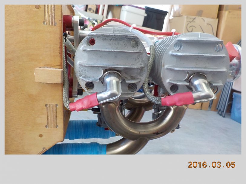

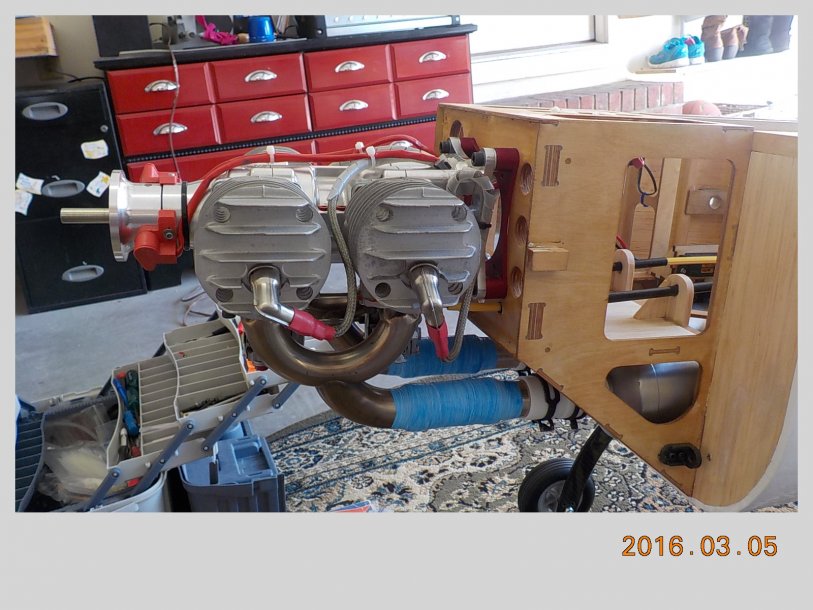

Primo.... The plane looks great. Please take note of how you ran your ignition wire in photo #4. You may end up with a chaffed wire after a short time.
Wayne
tl3
Wayne
I'll second that. I'd also run spiral wrap all the up to and just over the red heat shrink on the plug caps. The bends on those plug leads will not hold up under vibration for long.

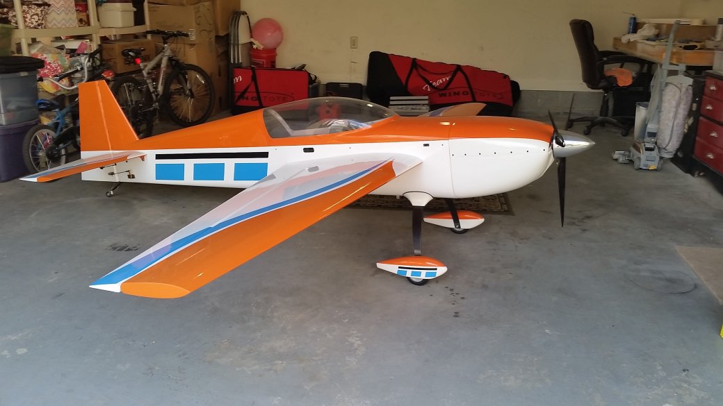

Good Lord willing, she will fly Sunday. If any of you are good with photo shop, I need ideas for the front part or maybe I'll just leave it as is.
Alky6
Looks absolutely fantastic! Maybe just some decals in front to break up the white? Suppose that is probably what you are asking....LOL. I will be of no help there!
JBenson
If it were me I would extend the black stripe from nose to tail. also like my 200 decal on the side of the cowl. I will try to get a pic in a bit.
