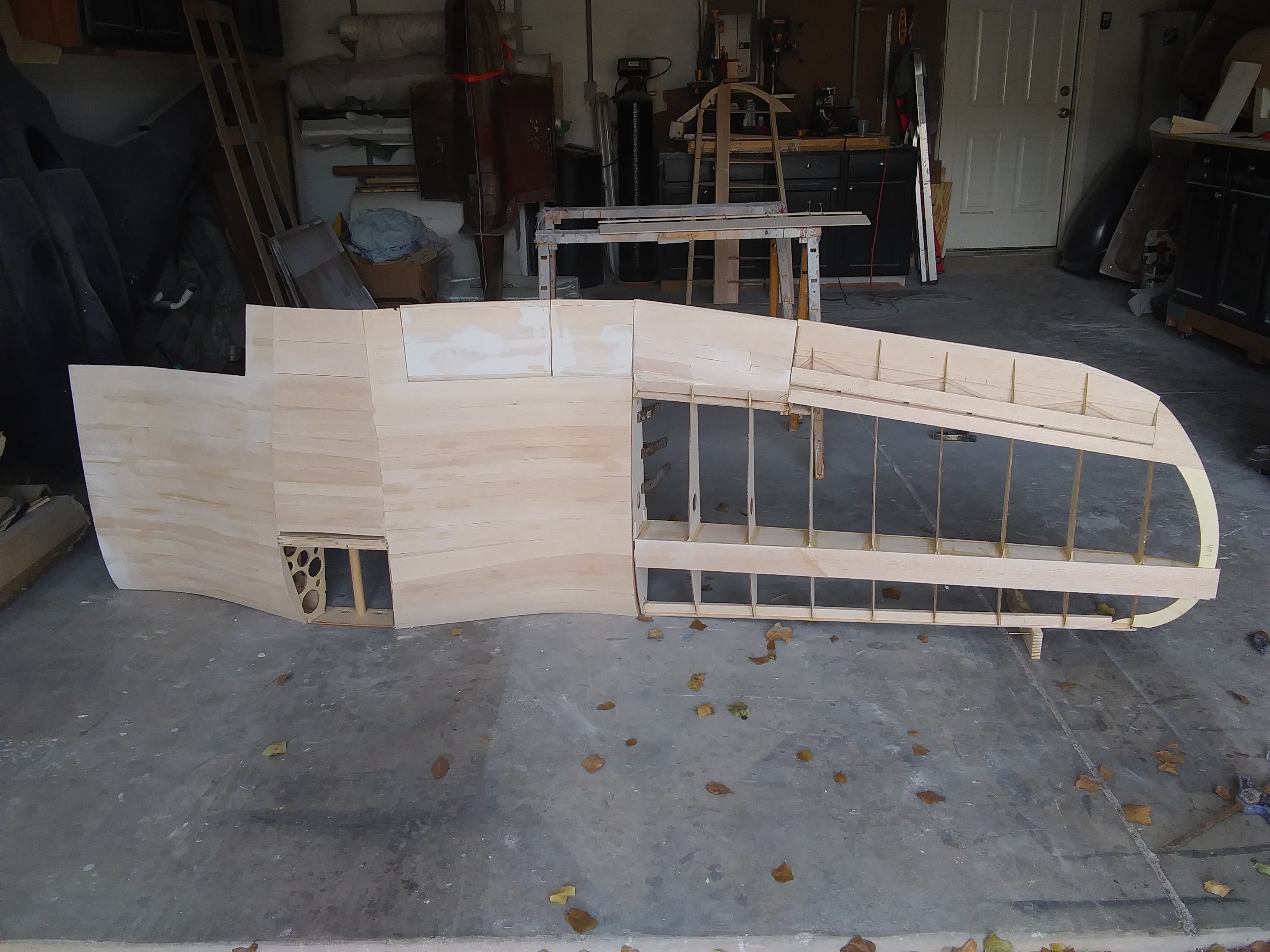

Back on the 1/3 scale Corsair. Did I mention how tough it is to build those flaps? Once I have the wing tube and wing connections in place I will make final adjustments for the flaps. They are plugs and I will make composite flaps once all fit and mods are final.

A custom project I am working on. Currently working on wings and started sheeting wing gull.
Wingspan is 158"
Hopefully I can get her out end of this year to make room for my other projects.

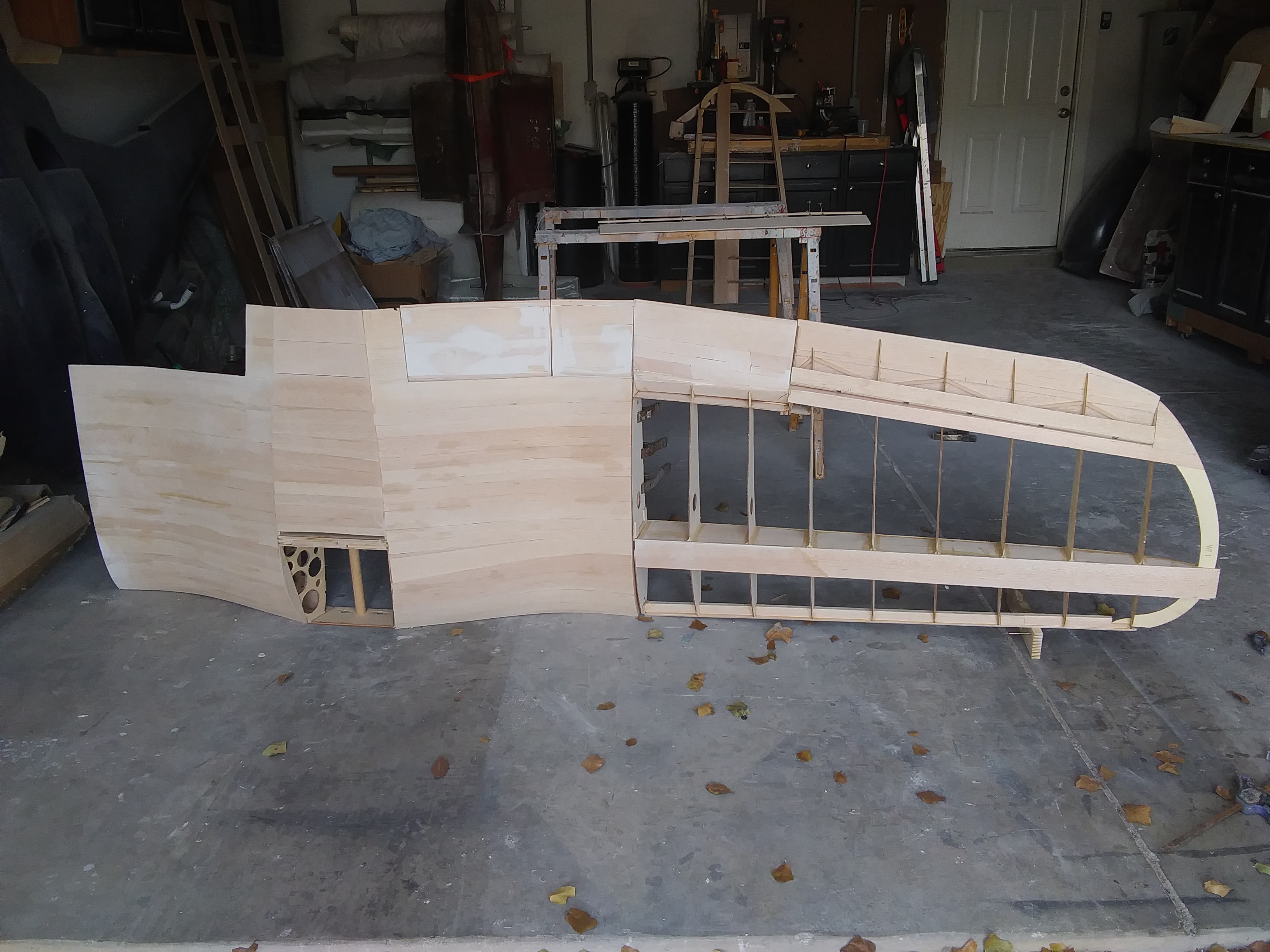

I would have loved to have been in the meeting where the engineers reported to the managers that they've run the preliminary numbers and a straight wing won't work......."so what do you recommend?" asked the managers......"A reverse gull wing sir" .....followed by...... silence
I imagine it probably went something like that

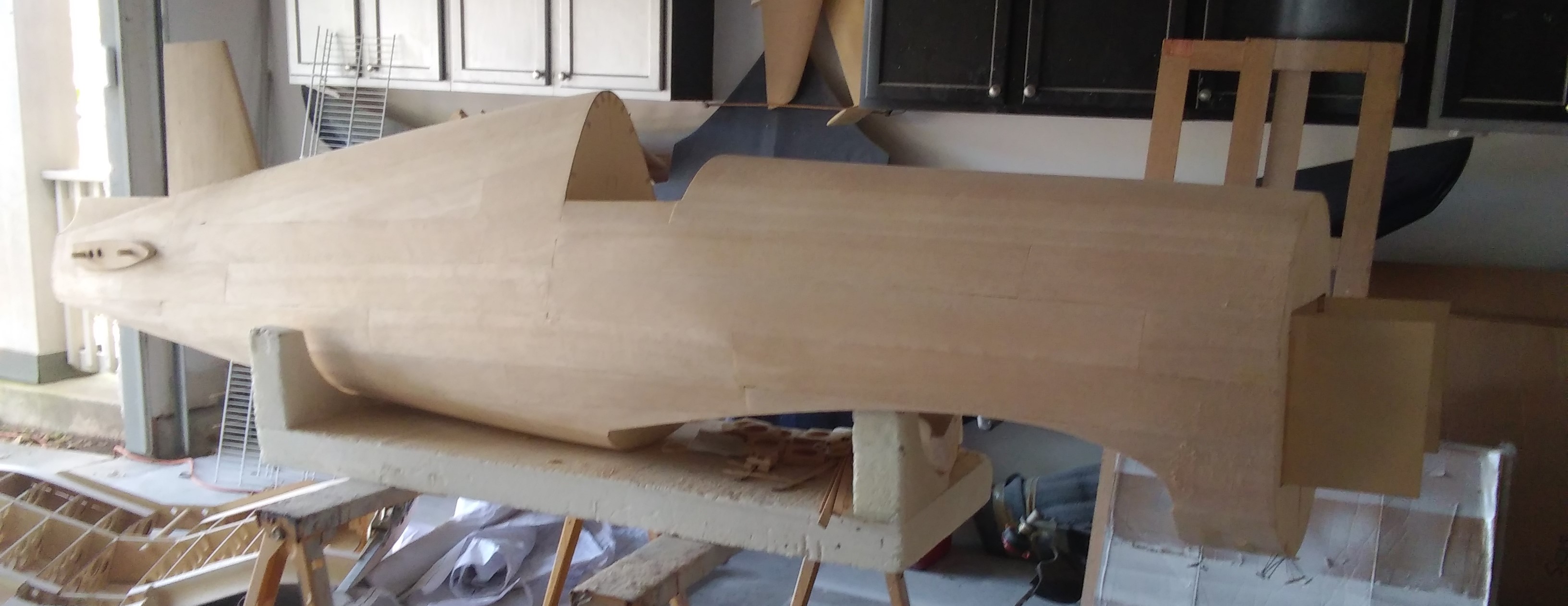

Since I can not do any composite work during winter months, I continued work on the 1/3 scale Corsair. I have completed sheeting the fuselage. Now I am working on the tail cone, and some other parts of the plane. We completed modifying the retracts to electric and sized them to fit inside this plane. I can go ahead and continue working on the wing gull section and installing spar and wing connection to wing gull. Outer wings are pretty much completed as well, just a few areas left open for spar installation. Meanwhile I will mill a plug for the canopy and cowl for fiberglass work. Soon she'll be ready to be taken to her new home.

The gull wing design was to shorten the retracts for heavy landing conditions.
