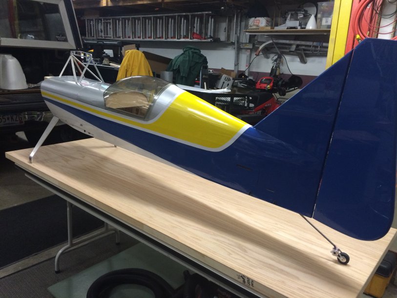

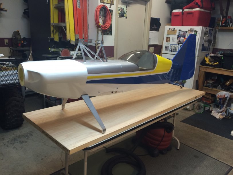

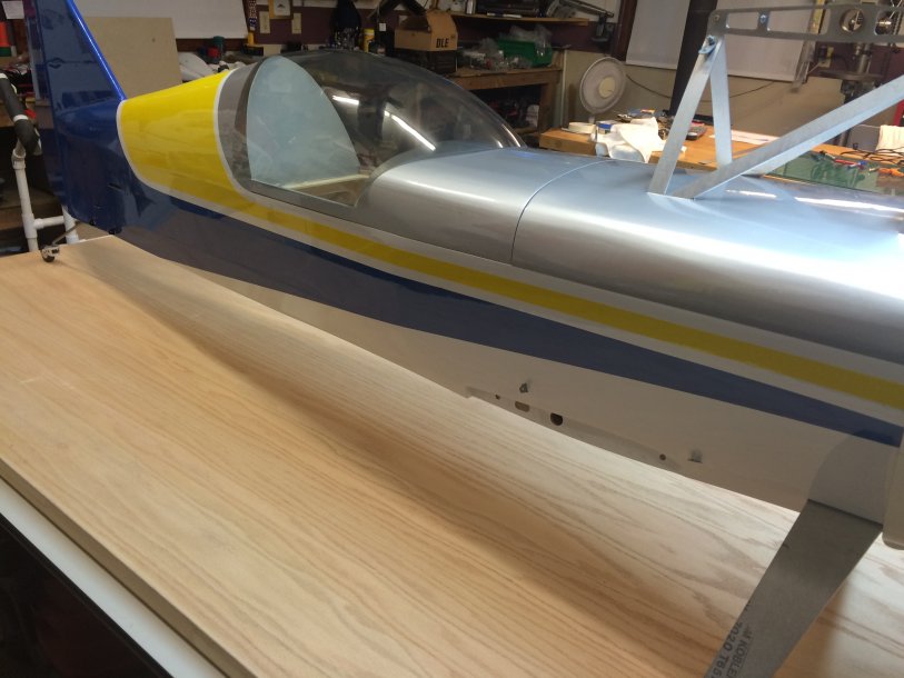

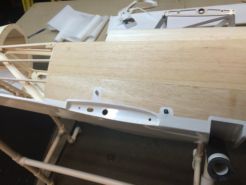

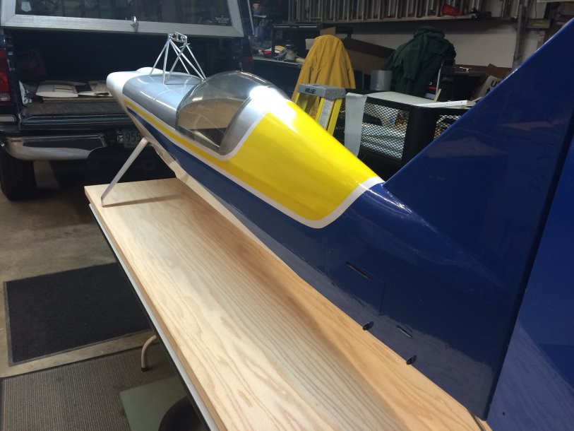

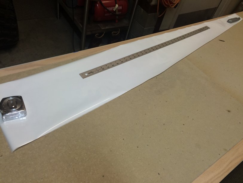

    I am no expert but have done enough to know what doesn't work.
    My advice would be to use Ultracote for your first covering job. It lays down and works better on radius edges and will shrink up nice.
    When you lay over another piece use really low heat and you will end up with no wrinkles.
    I use Tracing paper when making templates. Its is a semi transparent paper so you can see through.
    Cutting on glass works well to and will save on Exacto blades.
    Try using a soldering iron with a sharp point for burning out hinge pin holes or fir cutting out areas.
    I covered this fuse yesterday and look to wrap up everything else today watching some NFL playoffs.
    The plane is a 100cc EMHW ultimate.
    Key to covering is to know what your scheme is before doing anything
    and try to limit how much overlaying you do to limit air bubbles.
    Last thing.. You only need a sock when using dark colors. It saves on scratching but takes twice as long.
    Have fun.

    Did you cover the cowl?
  8. kork
    kork 70cc twin V2
    Joined:
    Aug 26, 2014
    Messages:
    158
    Likes Received:
    60
    Location:
    Minnesota
    No, the cowl is fiberglass and will get a shot of paint to complete the scheme.

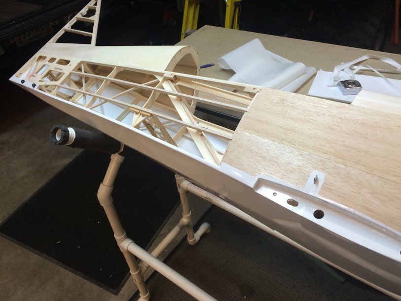

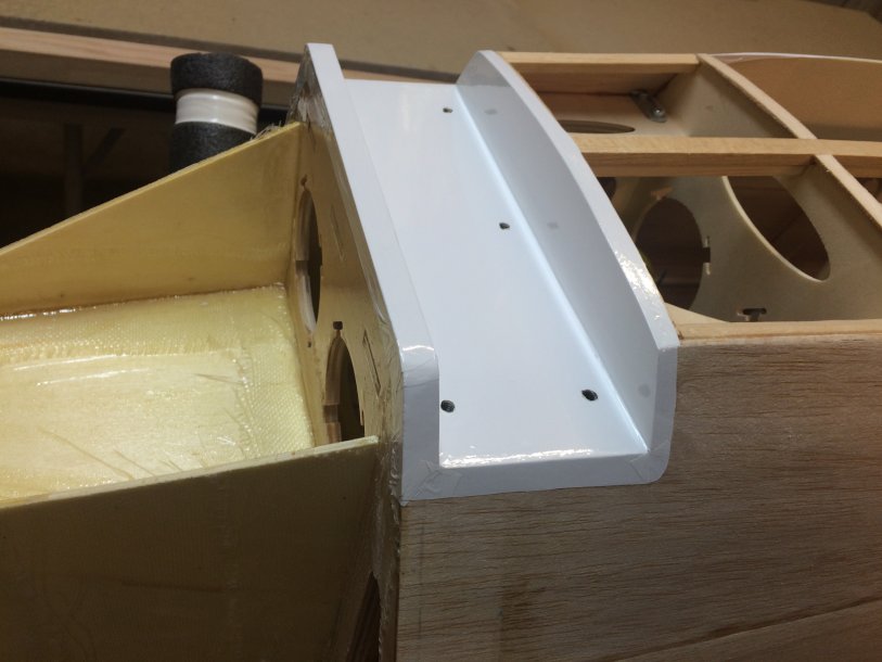

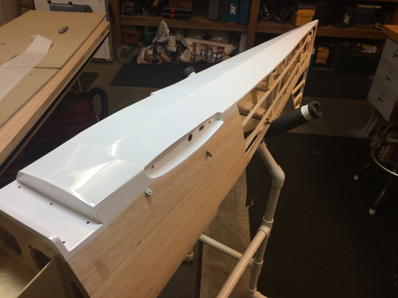

    Thanks a bunch @kork! In the 3rd pic, the landing gear plate, is that just one piece that's stretched around the corners?
  10. kork
    kork 70cc twin V2
    Joined:
    Aug 26, 2014
    Messages:
    158
    Likes Received:
    60
    Location:
    Minnesota
    No, that is 3 pieces.
    Front, back and bottom
