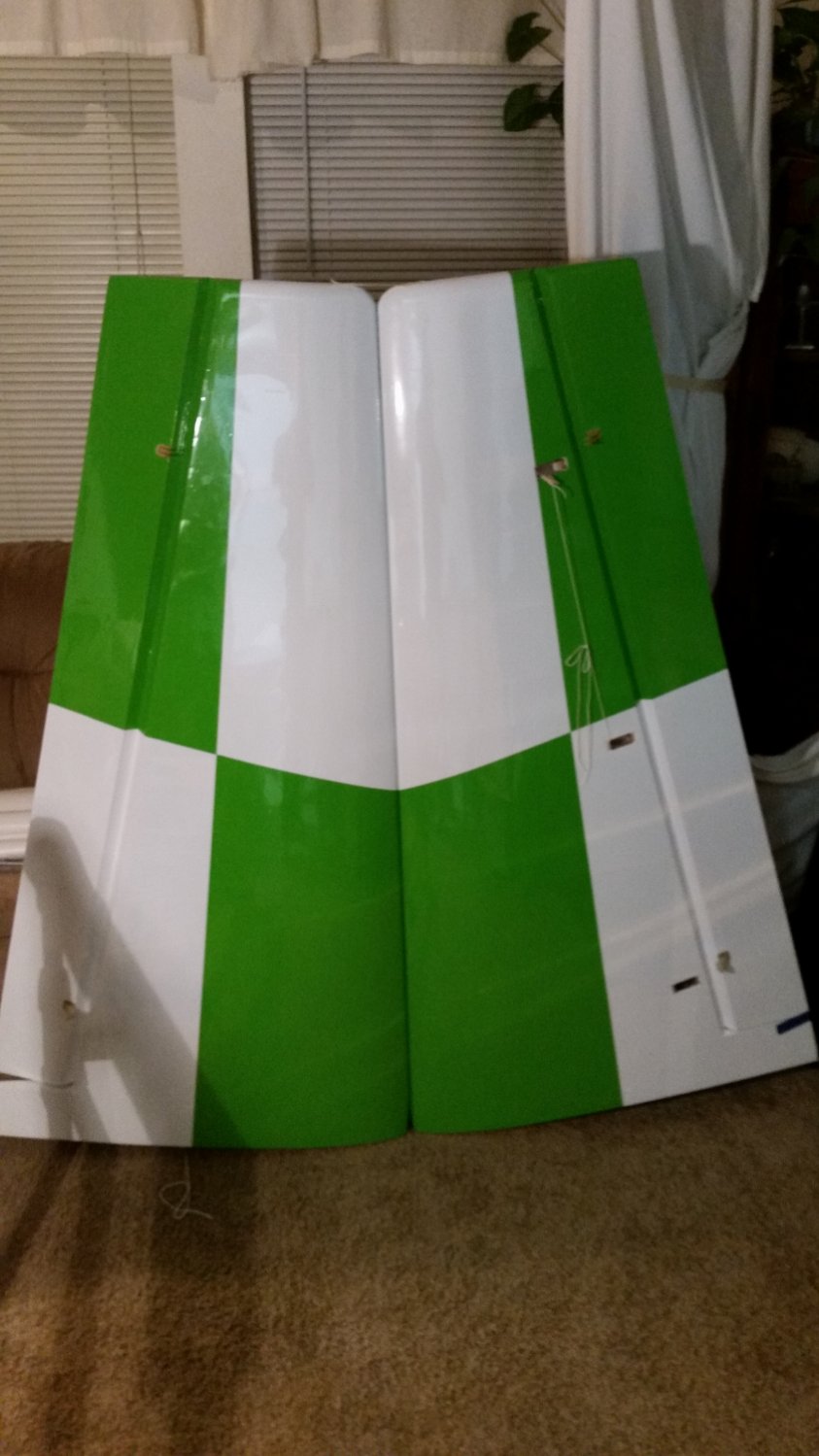

    Yes, you can leave your control surfaces attached. I have done a number of complete recovers with the surfaces still attached. It is actually a very simple procedure. Just a little patience and it will look awesome.

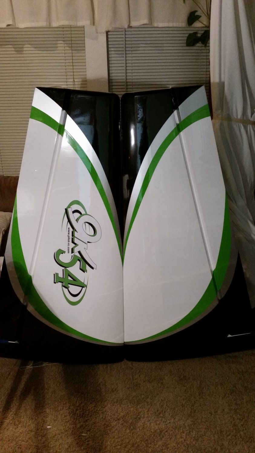

    I don't lift the alignment plate for the control horns. It is usually more of a task than it is worth. Also, if they are glued down really well, most times you will damage either the plate or the surface in which they are attached to. I lay my covering in place over the surface in an approximation of where it will be. I "slit" to allow for the horns and then slide the covering right down over the top of the horns. With my hobby knife, I cut around the plate so the covering will lay flat. Easy peasy.
    I really have not mixed Monokote and Ultracote. So I can not say with all certainty but I would say there should be no problem. I can offer this however. Monokote trim solvent is awesome for adhering multiple layers of Monokote and Ultracote. A very...."VERY" light brushing of the area that will be "layered", will allow the top layer covering to adhere to the lower base layer. But once that sucker is down, you won't be getting it off. Just saying. For Ultracote, I use the Windex method only in very large areas that layers extend quite a ways. Otherwise, I usually lay down my top layer into place and tape it at both ends. Lifting and starting with one end with slow progress to the opposite end using lowered temperature on the iron will yield to a very nice bubble free layer.
    20160415_024515.jpg 20160415_024534.jpg 20160102_201014.jpg 20160103_024356.jpg
    Stripes usually go down with no problem. Larger areas take a "LOT" more patience. Just don't rush your work.

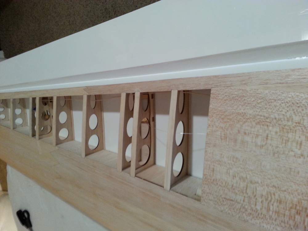

    Well I've been working off and on over the last several days on this thing and now I have all the old ultra off. I used some filler on some dents, soaked a few cracks in the sheeting with CA, and have most of the rough sanding done. There was just a bit of tackiness on parts of the wood from glue residue that didn't sand very easily, so I used the hairspray trick to stiffen it up and let it dry and then sanded it again. Worked like a charm.
    I decided to rehinge the elevators as there was a hinge or three loose. I used a soldering iron to melt the old ones out, and will drill them out oversize so I can plug them with a dowel and then drill them so the hinge fits tight. Still trying to decide if I should try to do the ailerons...
    Covering should be here middle of next week with the holiday and all and I should be ready for it by then. Feel free to critique, comment or suggest; it's my first stab at this so....
