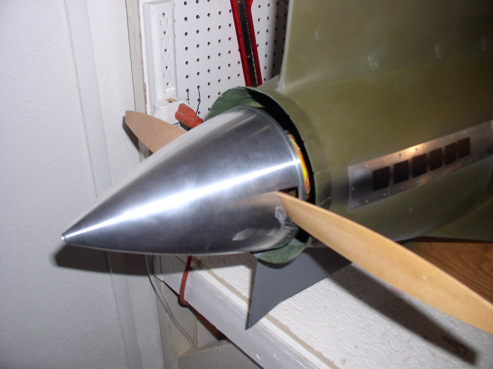

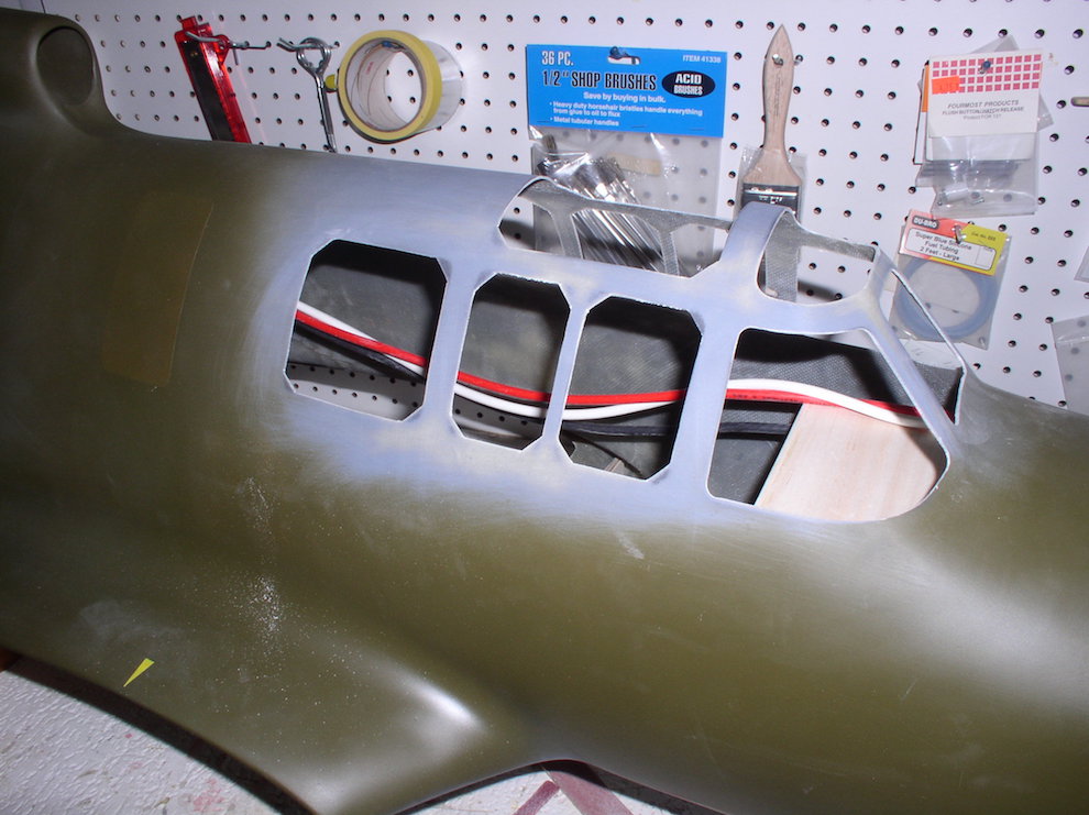

Getting some more done on this thing, the cockpit windows are all cut out but still need some "clean up". The retracts are up and running complete with nose gear doors to cover up the big hole that has been in the bottom of the nose. And also I finally broke down and gave up trying to balance the Chinese carbon fiber spinner and purchased a beautiful Dave Brown Products spinner. I did a ground run out in the shop and it seems to run nice and smooth with just a tiny bit of vibration. I did have to balance the new spinner just a little and it's as good as I can get it.
