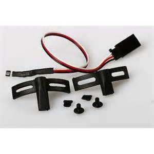

Can't seem to find that adjustable mount, can someone post a linkee here directly to source.
Pardon, I'm being impatient, I'll wait to see what you come up with and follow your lead.
I think you will want the one that Dimes has posted earlier as I believe the hall effect sensor is magnetic polarity sensitive and the sensor may need to be rotated for DA's positioning of the magnet? I am not sure on that one. Dimes?
Yes you are correct. DA engines hub magnet has the south pole facing up. When inserting the semiconductor in to its housing make sure it faces it correctly by having the face which has the beveled sides facing the magnet. Study the picture.

OK, starting to get the idea finally, can you tell I'm not electrically inclined. LoL
so a second hole will have to be drilled and tapped on the engine to secure the mounting plate . dang I wish I'd of done this before I mounted the engine , pipes, etc.

Only one hole? thought there were two in addition to the two to mount the magnetic pickup?

Still at work, can't verify that till I get out to shop tomorrow, but I believe that's what I noticed . hoping I'm wrong.
