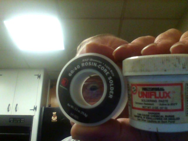

Now I gotta convince my mind that my fingers can solder something this small.
Ahh, Nuttin to it! use a 30 watt pencil tip iron and use 60/40 rosin core solder .032" diameter. Flux always and "tin" your wires. Rectorseal makes a good solder flux Called "Uniflux"
