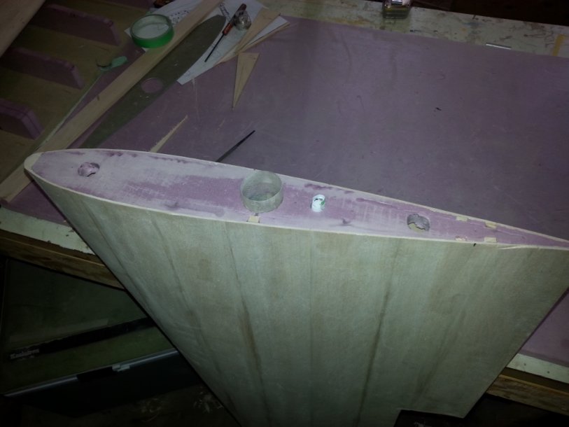

a bit slow lately but do have the second wing all sheeted and aileron cut out, now for the boost tab on this one as well, but today, -21c, I think I will wait a bit

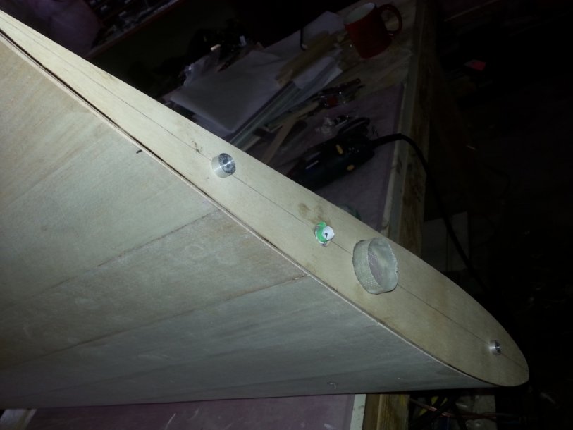

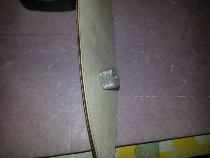

anti rotation and holdown pins

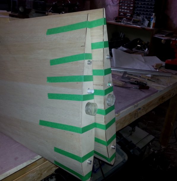

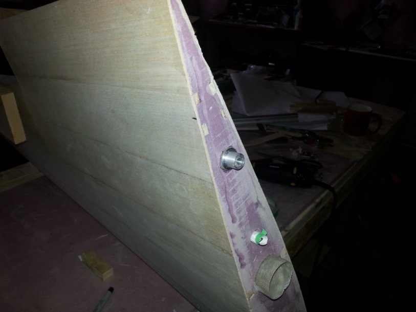

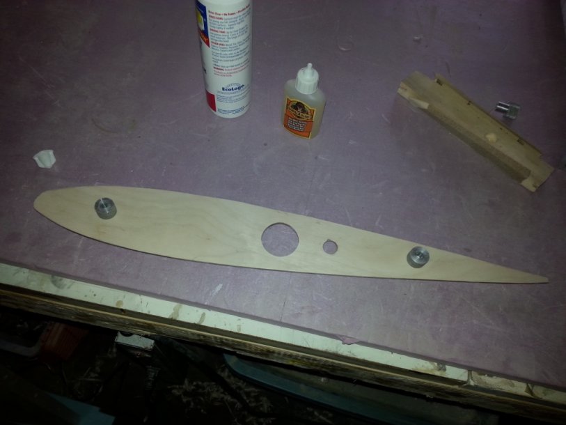

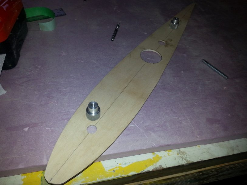

got the two plywood root ribs glued into place, along with the inner wing alignment/holdown inserts,

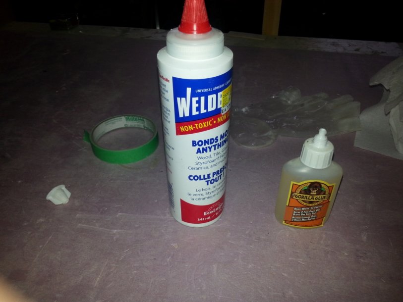

The rib is glued with weldbond, but any sandable carpenters glue will work, but I also put in some Gorilla Polyurethane glue for the inserts

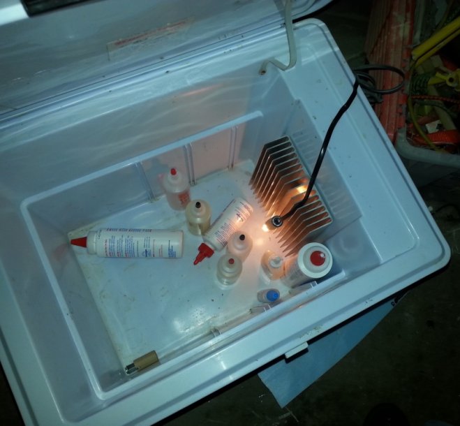

Also for the cold garage/shop, to keep all glues nice and warm I am using my cooler with an incandescent night light (7watts), believe me it works..
