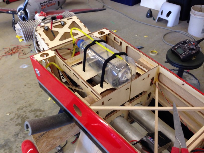

I got the fuel tank built and then I started running fuel lines. I am trying to come up with a neat looking vent line. Mounted the receiver as well

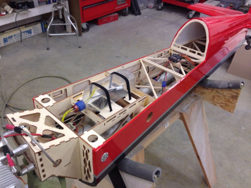

I also glued in a servo box for my throttle servo. I am hoping to have the throttle working this evening.

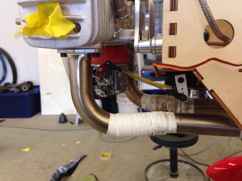

Throttle works good too. I got 100% on low and high. I like to be more like 110% travel both ways. I just couldn't seem to get that

I wonder if that is going to work. Don't jump on me cause I really don't know. I always looped the vent line and exited the plane in front of the tank. I know that the looping works.
Good thought. I have always had the vent exit in front of the tank too. I guess I didn't think about it. I could easily add a loop to it. I have noticed people not doing the loops lately

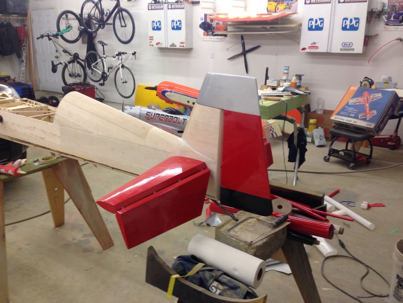

I have found the silver to be more of a bugger than the other colors too. Don't know why but it seems to do better with a little less heat.
Yup.... Have to agree. Love Ultracote but there are some colors that just seem to take a little more understanding. FWIW...black is another one.
