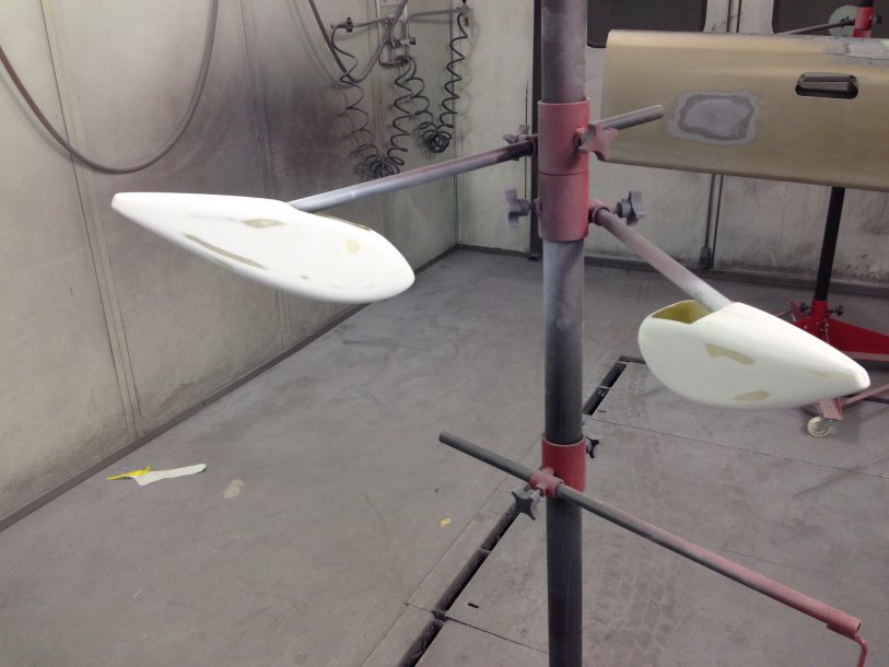

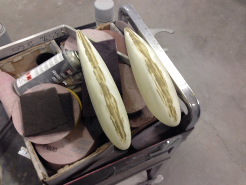

The second picture is after I filled the sean of the wheel pants and sanded smooth with a lightweight body filler. The first picture is after I primed them and sanded them. Now I will give it one last coat of primer before I paint. These parts were so full of pinholes, so a little trick is to spray a really wet coat of primer and then take a paint roller and roll the whole thing. Then a couple more coats of primer. All the pinholes get filled. It makes sanding the first time a little longer, but you don't have to deal with those little pinhole buggers.

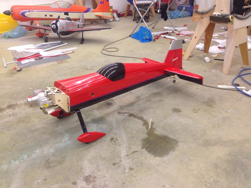

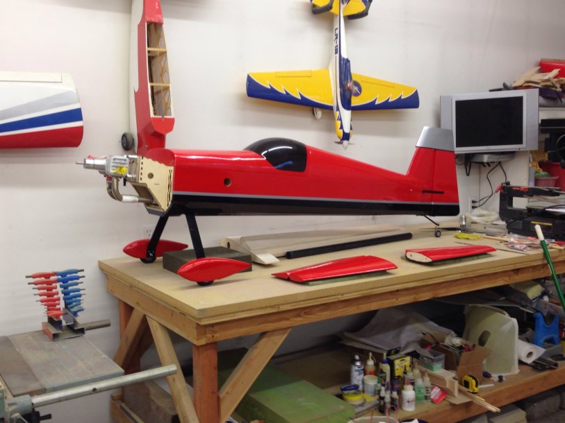

I got a little more done tonight. Painted the landing gear yesterday and mounted it. I am going to pull it off and weigh it before I mount it for good. I got the sides covered. The stage of doubt is setting in. Like, what if this thing blows apart in magnificent fashion on the maiden flight. That would suck!!!!!

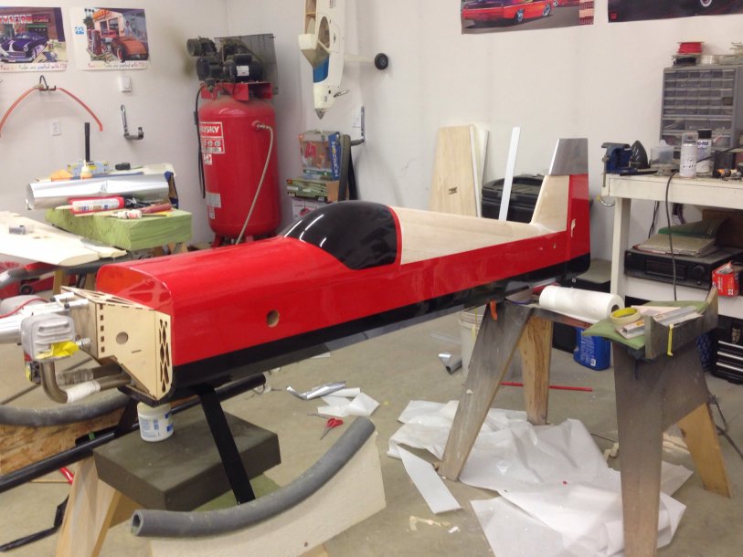

The fuse is done!! I was planning on getting the elevators set up with servos, but my shop needed attention after covering. Looked like a tornado blew through an ultracote factory in here! Now that everything is tidy, I will start on Servos tomorrow. I will be ordering servo extensions tonight and possibly a fuel tank. I will throw a coat of primer on the cowl tomorrow at work as well. I will probably get the fuse all done before I start covering the wings.
